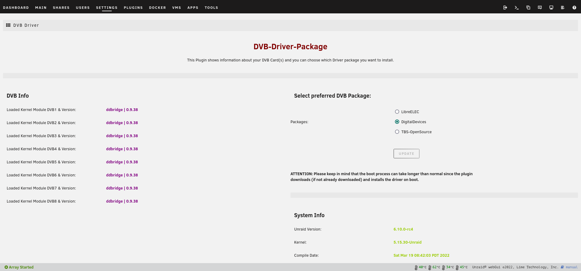

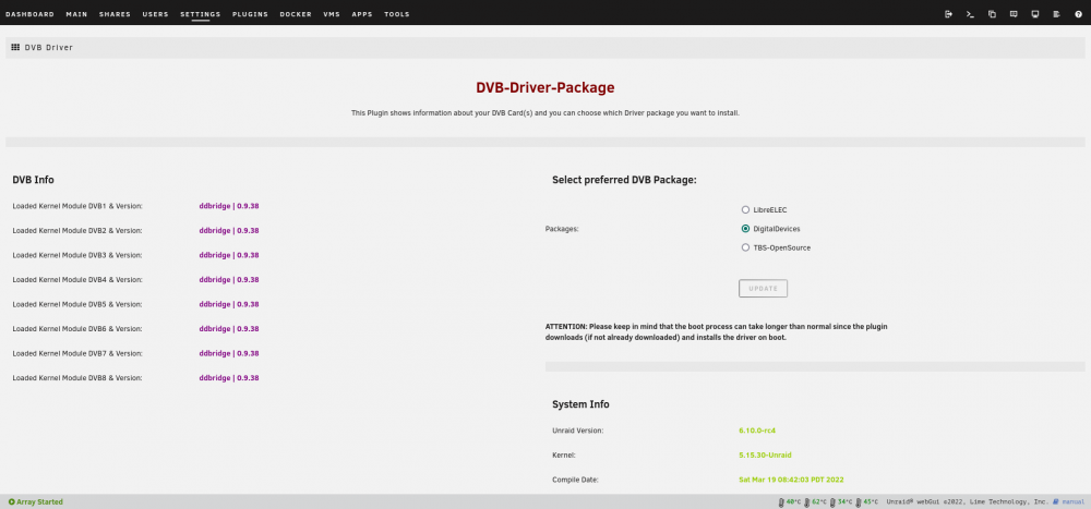

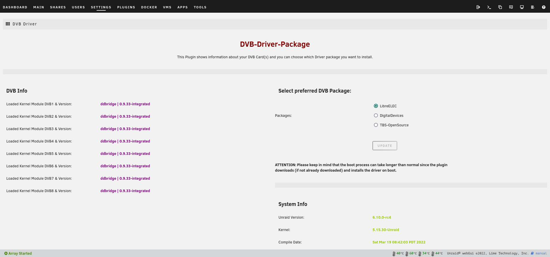

  3. Ah, that makes sense ofc! I am using linuxserver/tvheadend - the container. With this line as Device input: /dev/dvb This has been working great from 6.8.3 through 6.9.2 until now. I have just installed the LibreElec driver (see attached screenshot). There is no error yet - and as the driver is 0.9.33 I am confident that there won't be any error outputs anymore 🥳 There is this one line that came up after starting a TV stream, but I don't think that this is related? Mar 21 12:03:45 Eutronik ntpd[1348]: kernel reports TIME_ERROR: 0x41: Clock Unsynchronized --- As a workaround this seems pretty good for now. But as I can't (and should not) rely on the LibreElec drivers not being updated, I guess I should report this somewhere else? Do you happen to know what is the best way to do that?
  4. Thank you for your quick reply! Sure, my diagnostics are attached now Is it normal, that those mentioned lines will not be visible at the diagnostics/log/syslog.txt file? Mar 21 10:59:29 Eutronik kernel: ddbridge 0000:01:00.0: Frontend requested software zigzag, but didn't set the frequency step size Mar 21 10:59:30 Eutronik kernel: ddbridge 0000:01:00.0: Frontend requested software zigzag, but didn't set the frequency step size Mar 21 10:59:31 Eutronik kernel: ddbridge 0000:01:00.0: Frontend requested software zigzag, but didn't set the frequency step size Mar 21 10:59:32 Eutronik kernel: ddbridge 0000:01:00.0: Frontend requested software zigzag, but didn't set the frequency step size Mar 21 10:59:33 Eutronik kernel: ddbridge 0000:01:00.0: Frontend requested software zigzag, but didn't set the frequency step size Mar 21 10:59:34 Eutronik kernel: ddbridge 0000:01:00.0: Frontend requested software zigzag, but didn't set the frequency step size Mar 21 10:59:34 Eutronik kernel: ddbridge 0000:01:00.0: Frontend requested software zigzag, but didn't set the frequency step size Mar 21 10:59:35 Eutronik kernel: ddbridge 0000:01:00.0: Frontend requested software zigzag, but didn't set the frequency step size Mar 21 10:59:36 Eutronik kernel: ddbridge 0000:01:00.0: Frontend requested software zigzag, but didn't set the frequency step size Mar 21 10:59:37 Eutronik kernel: ddbridge 0000:01:00.0: Frontend requested software zigzag, but didn't set the frequency step size This is just a short extract from my current log, in case you are wondering as well why they are not visible in the syslog.txt as well. eutronik-diagnostics-20220321-1142.zip
  5. Hi, I am having some problems with my Digital Devices cards since upgrading from 6.9.2 to 6.10-rc3/4. When starting a stream, my logs are getting spammed with this message: Mar 21 10:31:07 Eutronik kernel: ddbridge 0000:01:00.0: Frontend requested software zigzag, but didn't set the frequency step size I have both DVB-S2 and DVB-C2 cards installed, however last time it was when tuning on a DVB-C2 channel. Due to the frequent error logging, I have to restart every other day to prevent my log being filled up to 100%. I have waited for the 6.10-rc4 release, but that didn't solve this issue unfortunately 😐 --- I have done some research regarding this error message, this line has been added at 2022-01-14: https://github.com/DigitalDevices/dddvb/commit/b6d2a37ac21c6c49830dda085d0176cd9320395f (file: dvb-core/dvb_frontend.c) Checking your compile script for DD drivers, these seem to be included in your sources - as they are currently in the master branch. Is it possible to manually override the source with an older version of the dddvb drivers? e.g. with 0.9.38pre3 which doesn't have those lines included? There is also a thread in a mailing list: https://www.spinics.net/lists/kernel/msg3876756.html There is a line which includes dev_warn_once() instead of dev_warn(), as it is currently being used. I don't know if this would change anything though.. dmesg_2022-03-21_10-21.txt lspci-output_2022-03-21_10-21.txt
