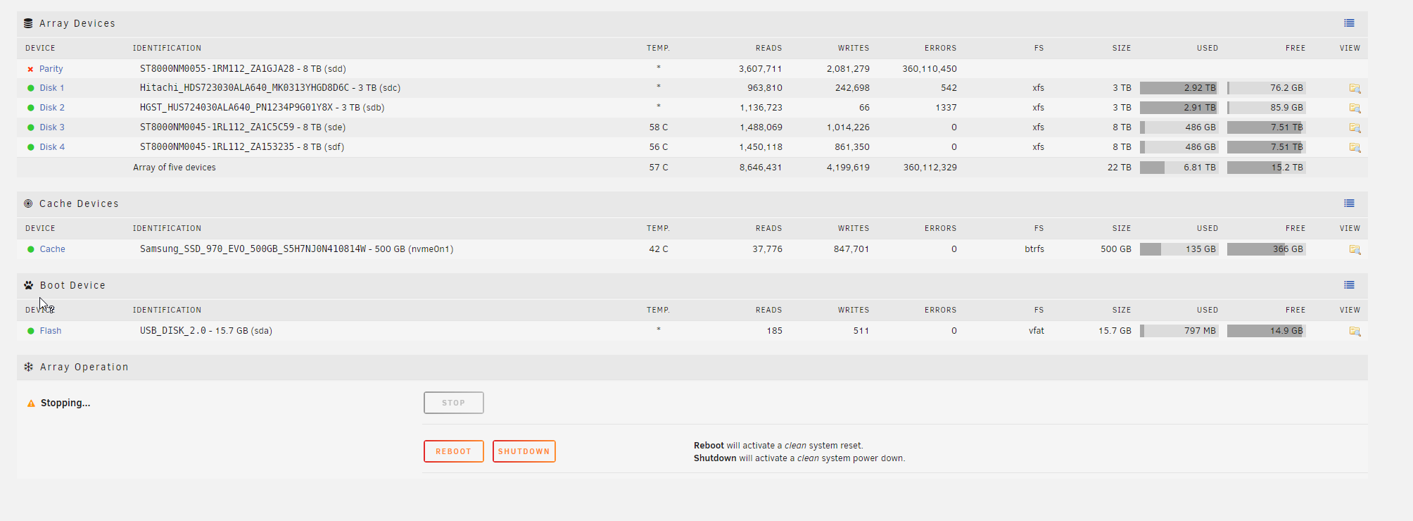

My temperatures have been really high since my house does have AC and I can't open the windows due to air quality. So I have been trying to watch my Unraid stuff. Then it just stopped working. My errors spiked on my parity and then stuff hit the fan.

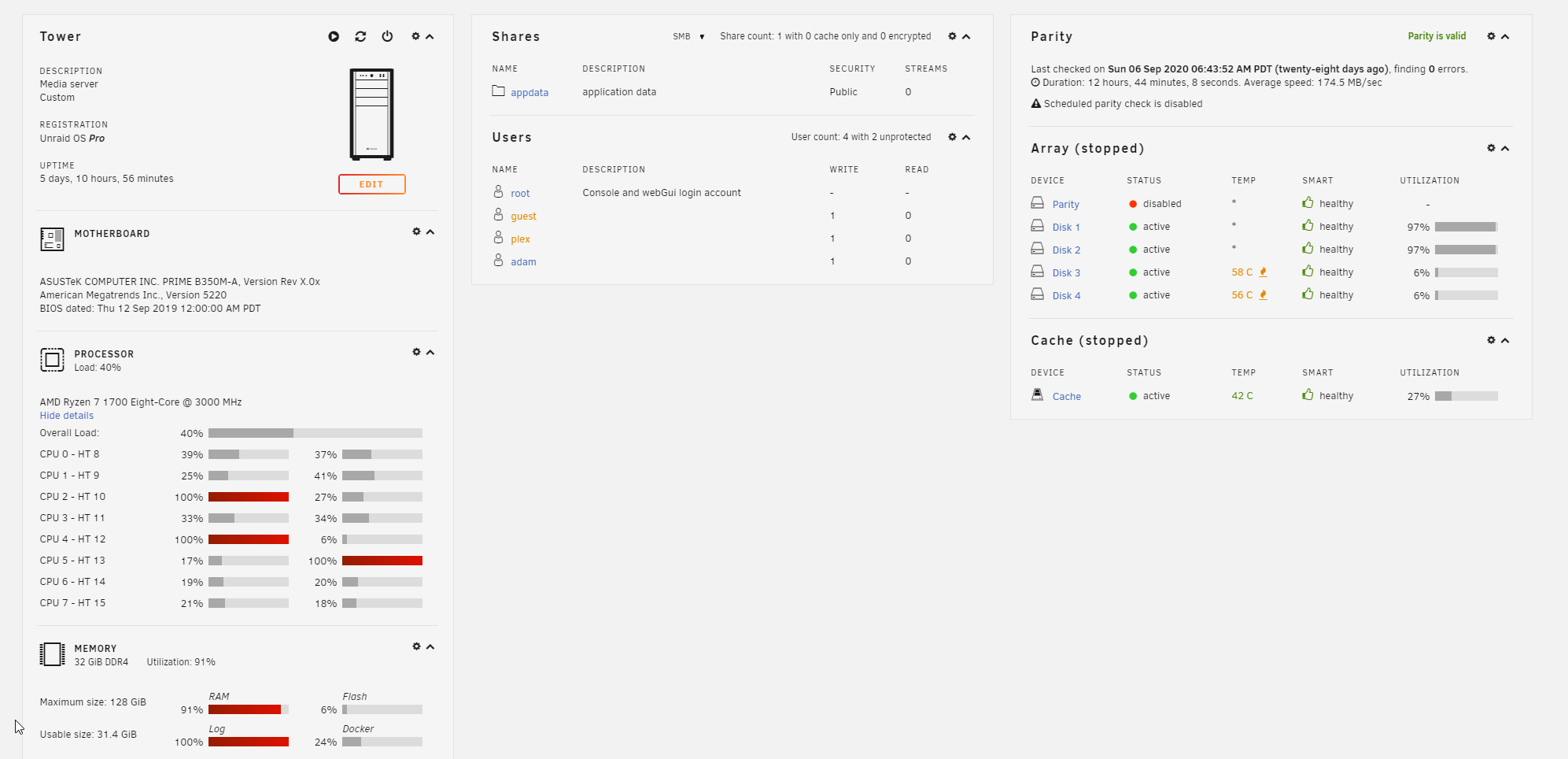

So if you look at the Screenshots the logs are taking up all the ram (at least I think). I also just can't open logs to see what happened. I closed the Array but it's still stopping. I'm afraid to reboot the system because I have no idea what's going on. I think I missed information but can't tell as I'm freaking out a little haha. Any advise would be amazing. I can answer any questions to help.

See if you can get the diags on the console by typing "diagnostics", then attach them here.

Also, the terminal window will not open past a certain point of log fullness. You can type but the window refreshes before you can do anything.
Just rebooted so I could do something but syslog right now is just boot messages.
