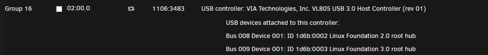

January 18, 20215 yr Hi, I have the same kind type of issue. I try to configure some macOS VM's which needs keyboard and mouse to work with the eGPU. Whilst setting the VM up i sometimes need to force stop the VM. Sometimes it works, but most of the times it says this in the syslog: Jan 18 13:21:16 Unraid kernel: xhci_hcd 0000:02:00.0: WARNING: Host System Error Jan 18 13:21:16 Unraid kernel: xhci_hcd 0000:02:00.0: Event logged [IO_PAGE_FAULT domain=0x0000 address=0x00000000fff91000 flags=0x0000] Jan 18 13:21:16 Unraid kernel: xhci_hcd 0000:02:00.0: Host halt failed, -110 Jan 18 13:21:27 Unraid kernel: xhci_hcd 0000:02:00.0: xHCI host not responding to stop endpoint command. Jan 18 13:21:27 Unraid kernel: xhci_hcd 0000:02:00.0: Host halt failed, -110 Jan 18 13:21:27 Unraid kernel: xhci_hcd 0000:02:00.0: xHCI host controller not responding, assume dead Jan 18 13:21:27 Unraid kernel: xhci_hcd 0000:02:00.0: HC died; cleaning up After that USB devices are gone from Unraid GUI and tools. It seems that it disables the 02:00.0 device, which in my case is a USB 3.0 controller. Before 'crash': After crash: I am trying to find a command to reset the hardware. It must be the controller, because: if I try to connect the hardware to another port on the server it actually recognizes it, but will still have the same issue and will also not work. This kind off makes my server a gun with ammo: if you blow it all, you need to reload (restart the whole server) which in my case takes the whole network down due to having network VM's. Does anyone have a command or a way to fix this? Greetings, Bjorn (Running unraid 6.8.3) Edited January 19, 20215 yr by maxstevens2
