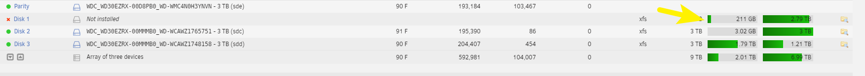

Array has missing disks, but I can brows the files and showing space used? Bonus: Should I upgrade my server?
Newbie question I suppose... Why does my missing disk have data on it? I can see and access the data on it...? The drive is physically not there! I think I disabled it in the bios, but maybe I just took it out of the array. Is Unraid putting data on it? Disk 2 is showing 3.02 GB used... but it's empty? Background: My drives are developing bad sectors and the array was full so moved all the data I never use to offline cold storage, and consolidated everything to disk3. The system is deciding to put stuff on disk1 which I removed. Bonus question... I built my rig in 2014 (I think) as a Desktop/Game system that saw Unraid use right away. It's an i5-4690K, 4th Gen with 32gb ram. I think the ram is the only thing keeping it alive, if I had a 16gb limit I might have replaced it already! The hardware is still fairly capable...I haven't ran into any limits with it running my dockers and a couple VMs. More cores could be nice...I could get an 8 core cpu used and run it some more... Should I just update the drives or build a new server? I was hoping to get a couple more years out of the hardware I have... but I'd say that a couple of years from now too! Now that it's an server, I'd like to build a smaller 4-5 external drive bay rig I can hide somewhere rather than my full tower.
