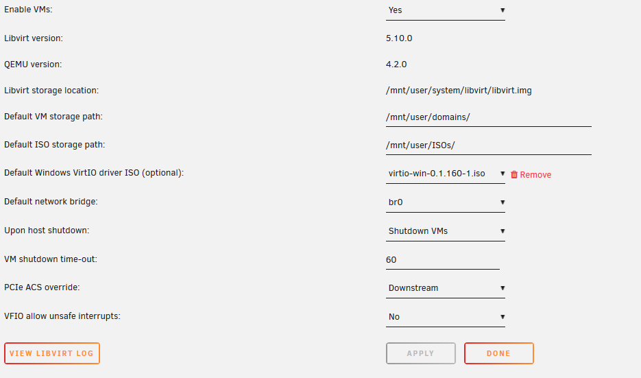

1. Copy the plugin url:
https://raw.githubusercontent.com/dmacias72/unRAID-libvirtwol/master/plugin/libvirtwol.plg
2. Paste url into install plugin text input and click install
3. Wake On Lan will be added to Settings/VMSettings page for starting the daemon

I updated the plugin about a month ago to work with 6.2. I just tried and was able to wake a ubuntu and windows vm from my asus router and my wakeonlan plugin. 6.2 needs python 2.7.11. Do you have any other python plugins or nerd pack that may install python 2.7.9?
It's possible if your were not on the latest version or upgraded after updating to 6.2 you have the wrong version of libpcap installed. 6.1 needs 1.4.0 and 6.2 has 1.7.4 included so the plugin doesn't install libpcap for 6.2. But if you have the latest and have rebooted since you should be fine.
For further testing you can stop the service from the vm manager settings page then go to the command line. Run this command where br0 is your bridge name. Then try sending a wake on lan. Try from different apps if you can. I have a plugin for wol too or try from your router. The script will show if there's an error.
python /usr/local/emhttp/plugins/libvirtwol/scripts/libvirtwol.py br0
Also the pcap interface is set to promiscuous mode so all packets are captured. So you don't need to point wol to your server ip.
I'm on my phone through vpn but the wake on lan app by mike webb didn't work when it used to also. It maybe because of the vpn. So in the app, I changed the wake on lan settings for my ubuntu vm from x.x.x.255 broadcast to x.x.x.1 which is my server and it worked. But you said you had tried that.
I noticed to that the default in domain.cfg is vibr0. Maybe double check your vm is still br0. Also I don't have spanning tree protocol on. Don't know if that matters.
The interface should be listening on the bridge but you could try the script with eth0 instead of br0. See if it works and see if what did work still works also.
