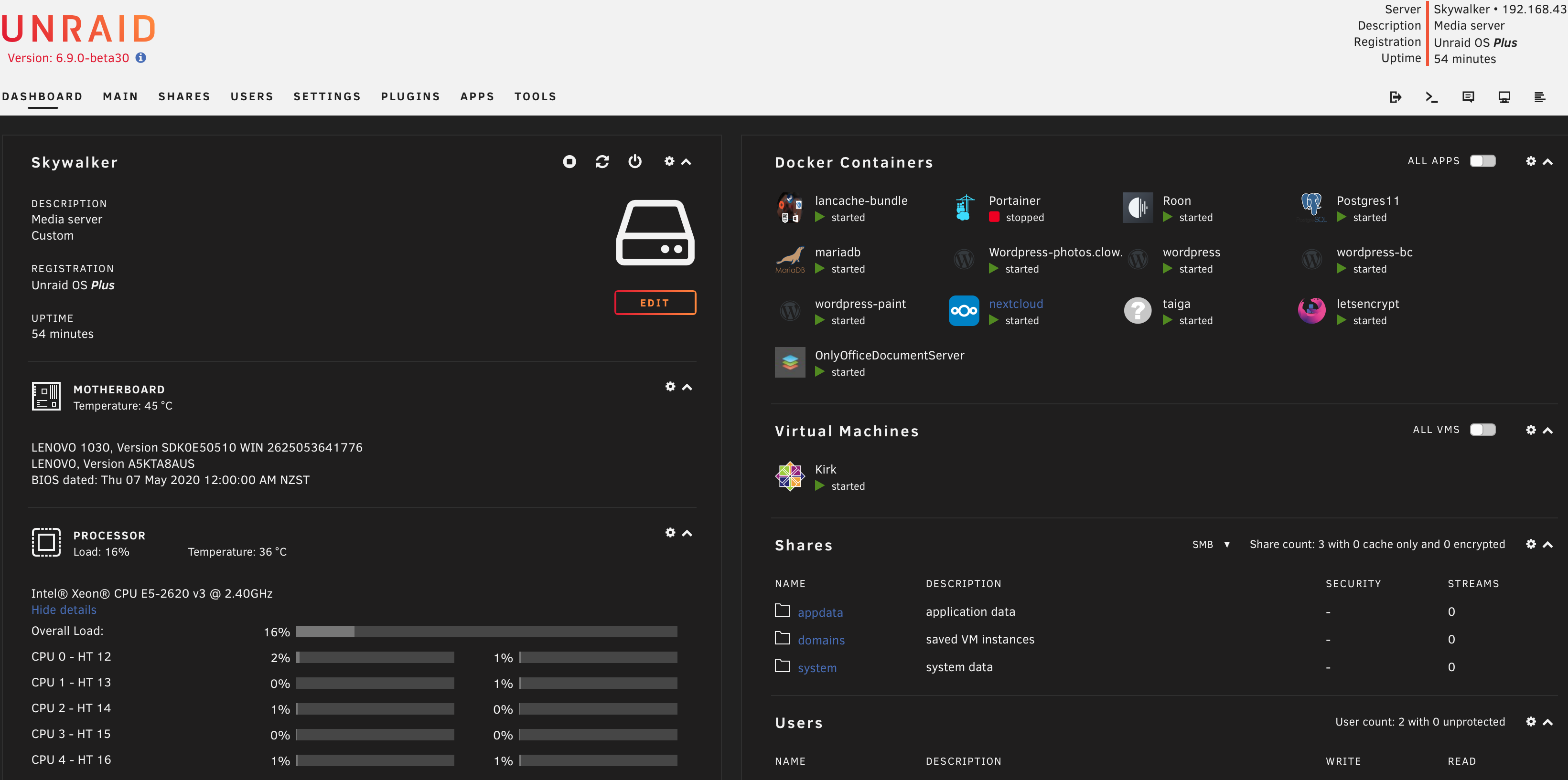

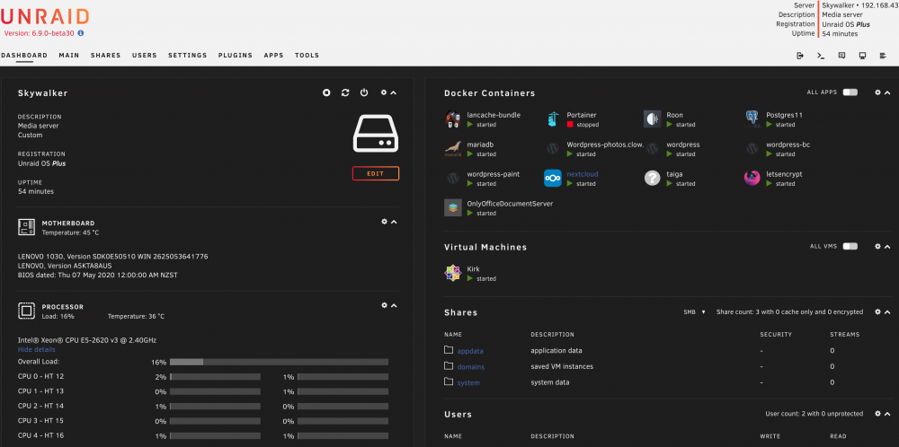

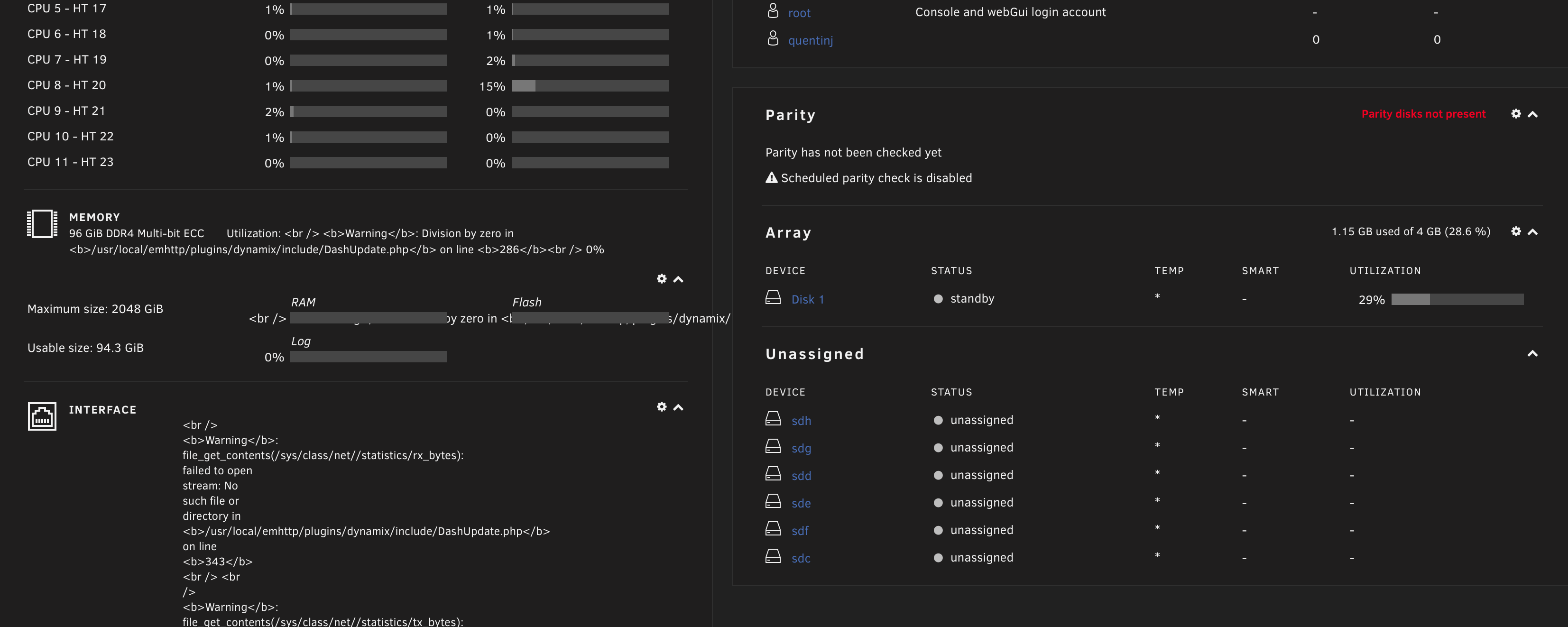

This really has me stumped.  I am unable to run diagnostics, even from the console.  The GUI has text strewn through it, docker and vm menus are missing, but oddly still working, actually behind the scenes it is still running but I'm not very happy about it.

I've downgraded from the beta to stable and it still happens.  Check out these screenshots - weird text where the shouldn't be.  Even getting told that VM's won't start because my hardware doesn't support VT-d, which it does and the VM's are running in the background.  I'm sorry but I can't post diagnostics -see output below.

I tried syslog, but nothing is getting logged.  It seems the system can't create (or thinks it can't create) files.  I can create files in the console though.  So I think it's broken too, which is what I was expecting to be honest.
