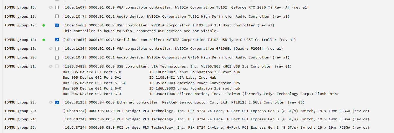

April 30, 20242 yr The xen-pciback.hide parameter is not necessary to "stub" PCI devices for passthrough. Instead, you can simply bind them to VFIO, which can be done directly from the GUI. To do this, navigate to Tools > System Devices, and select the devices you want to passthrough by ticking the box next to each. After rebooting your system, these devices will appear in the VM template, ready for use
