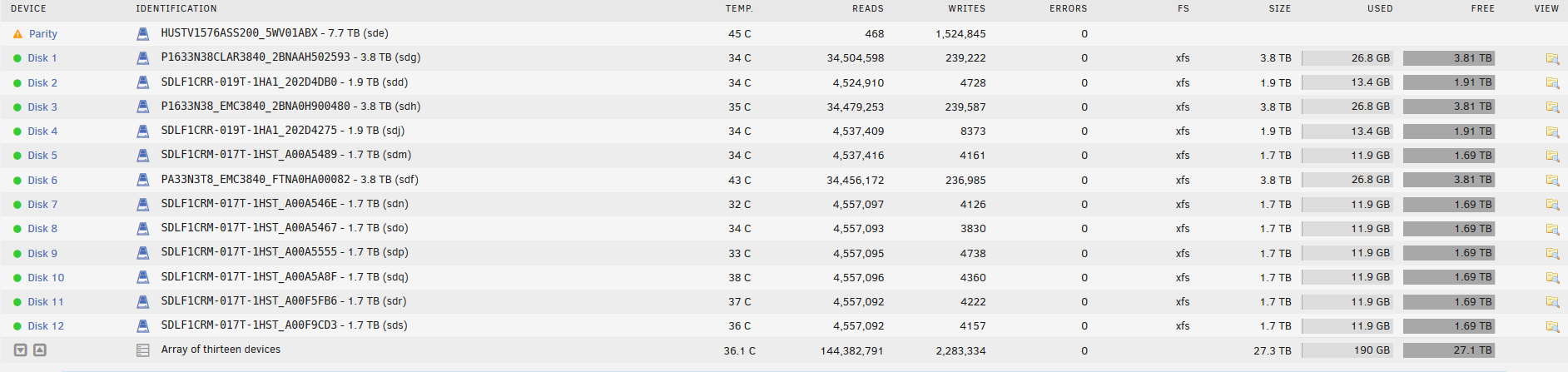

SMART green, device disabled. tons of read/write?
Go to Tools - Diagnostics and attach the complete Diagnostics ZIP file to your NEXT post in this thread
Why do you have SSDs in the parity array? Do you know they can't be written any faster than HDD parity, and they cannot be trimmed?
i checked out my server last night. i swapped drives around to see if the problem stayed or moved. it appears so far to have moved. i think i found a bad sata connector. i moved one of the SSDs from this bad connector and speeds seems to have doubled or better.
well that might explain yesterdays lack luster performance and weird stats. also not being able to write to it any faster might lso add to that.

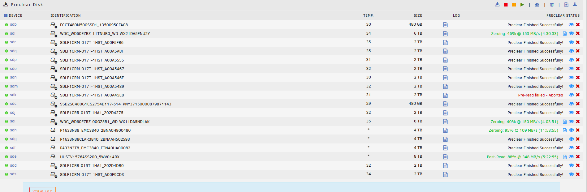

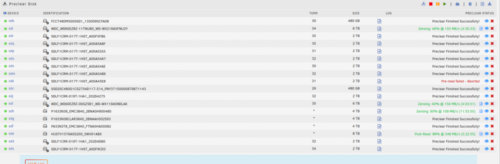

HOWEVER, even with the poor performance yesterday and error i noticed my parity check/sync time was HALVED! Pre Clears which should NOT be done on SSDs go much faster than the 6tb HDDs. (a few drives failed pre clear yesterday, i initially chalked up to not being for SSDs until i found bad cable)
that bad cable and my old processors were probably why i had slow speeds this hole time along with having many drives. ALSO i found one of my primary intake fans cooling the drives had up and quite, the fan connector had broken! drives seem to be cooler so far.
maybe could have done experiments without going ALL SSD but, what the hey if i can find a way to do ADDITIONAL back ups might as well guinea pig. I think i'll be making thread somewhere about my unraid adventures.
BEFORE with bad cable and no fan
AFTER intial pre clear
AFTER overnight
so far much better than 80 and 90mb speeds ...for the most part, the one drive seems to be zeroing at those speeds
EDIT: i either have a bad drive or another bad cable one of the drive giving me fits last night just failed a pre-read in pre clear :(

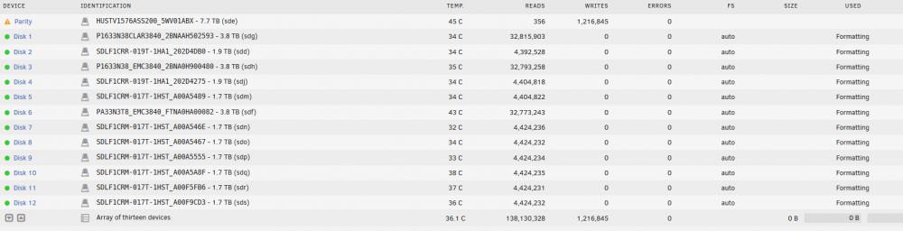

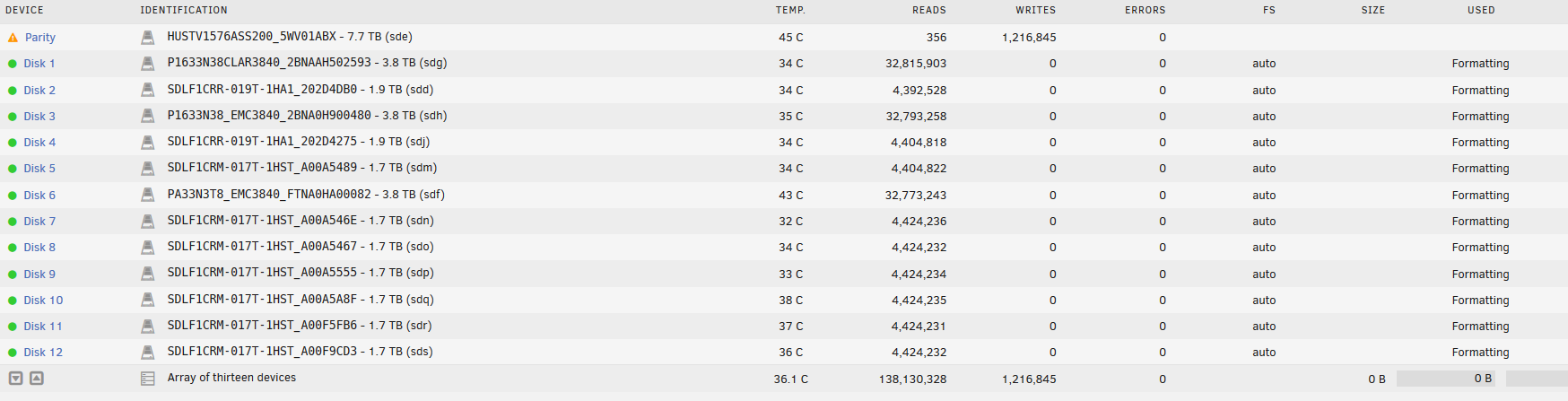

is this normal for the parity on fresh brand new array after it just starts the parity sync?
stopped sync and did format
looks like around 7 drives is the limit before speeds drop quite bit. 6 or less seems to boost speeds. as Constructor mentioned in another thread, the fewer the drives the faster.

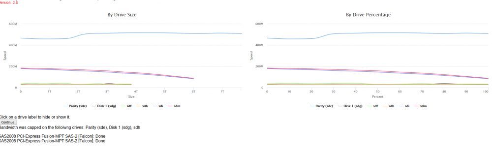

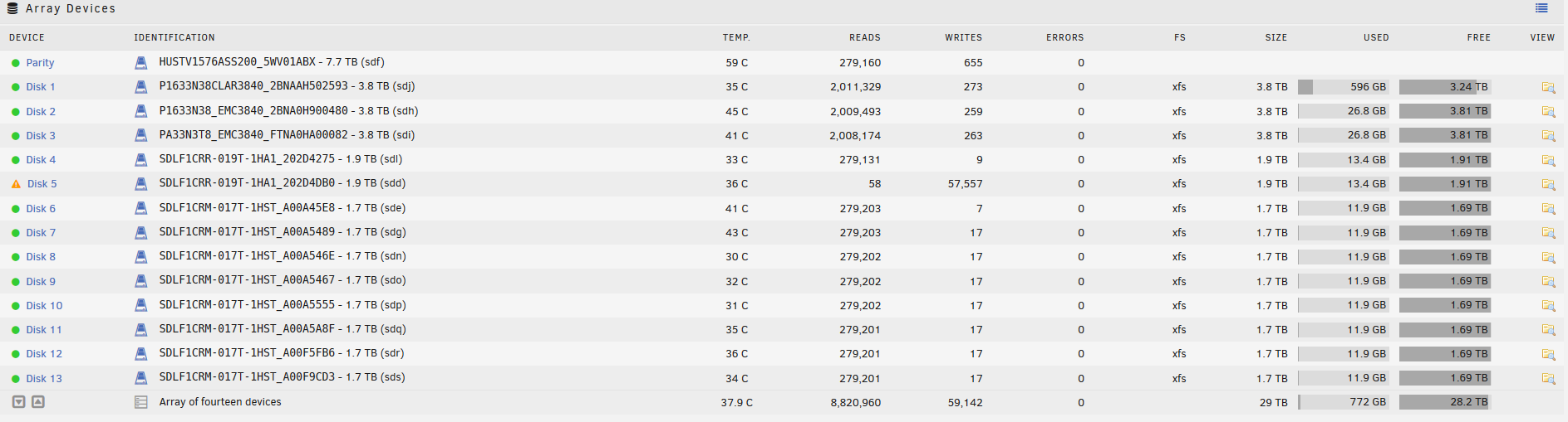

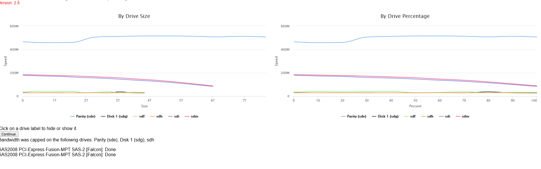

You can run the diskspeed docker to test controller(s) aggregate speed.
docker service failed to start, trying a reboot. will have to revisit
Edited by cdoublejj
not sure it's benching all drives?
EDIT: looks like maybe 3x Dell H310s flashed in IT mode.[SAS2008 PCI-Express Fusion-MPT SAS-2] they crammed full up and 2 drives of the main motherboard. maybe i need some new controllers? running some benches
