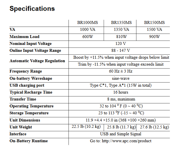

I have this APC Back-UPS model and it works great with unRAID.  It just says "Sine Wave" and not "True Sine Wave" but I have had zero problems with it and it has properly protected and shut down my unRAID server on two or three ocassions.  Whatever it is, it does not appear to be simulated or modified sine wave which produces a "dirtier" power signal than pure sine wave to attached equipment.
AVR (automatic voltage regulation) may be more important than the waveform shape if you do not have clean, consistent power.
Here are the specs from the manual:
