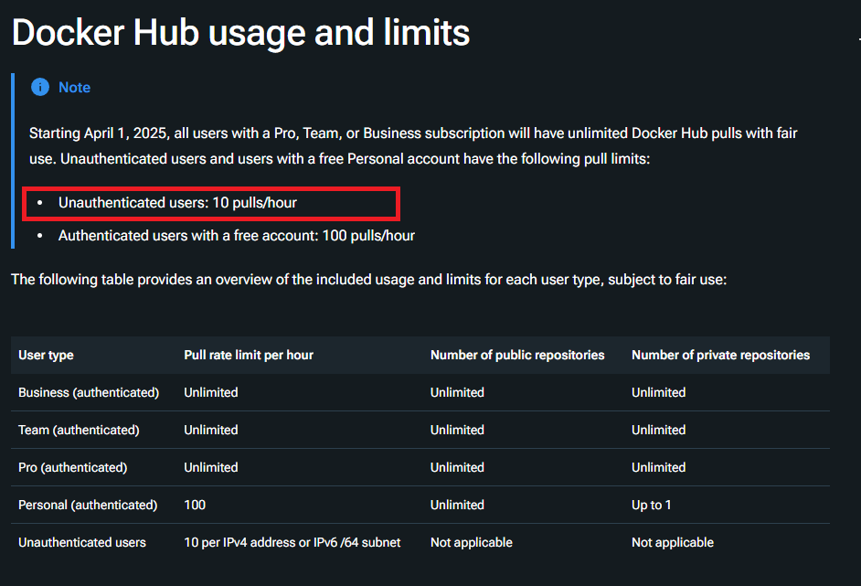

February 27, 20251 yr Bump https://docs.docker.com/docker-hub/usage/ Edited February 27, 20251 yr by tjb_altf4
