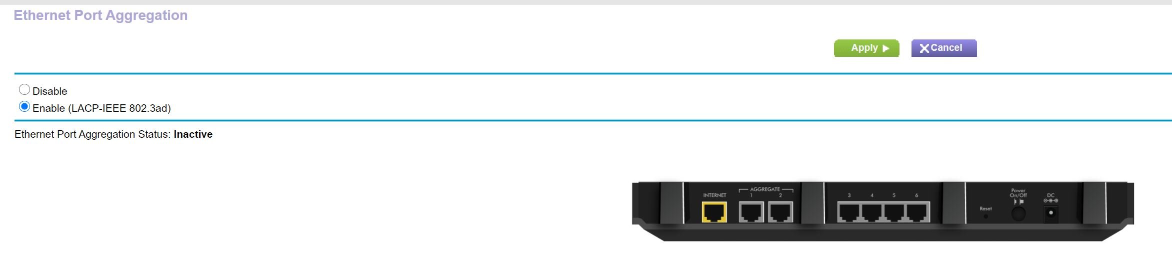

@Vr2Io Thank you for the quick response, that article was helpful. Working on this today.
So just trying to reconfirm that the steps are right:
  1. Enable port aggregation on the router - screenshot of mine is below.
  2. Stop docker and VM's in unRaid
  3. Change network settings for eth0 and enable bonding with members eth1
  4. select bonding mode to balance-alb
  5. leave all other settings as is, click apply and done
Questions:
  1. Do I change the MTU settings to anything higher than 1500 (9000 maybe)? My ethernet controller says jumbo frames supported, hence the question.
  2. Anything else I am missing.
All guidance is appreciated.
Thanks.
Your router support LACP 802.3ad, so you should use that mode instead balance-xxx.
For MTU you can try other then 1500 if all equipment support,  but I not recommend due to sometimes got strange problem / performance.
Perfect - Thank You!
It is all good now, aggregation is setup and it works. Thanks @Vr2Iofor the help.
