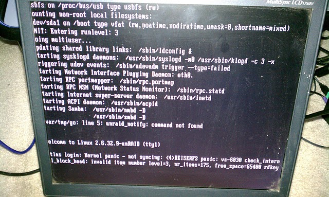

Post boot - Kernel Panic - not syncing: <4> REISERFS panic: vs-6030 ....
Array will boot, but immediately gets a kernel panic once login screen is displayed.
Since kernel is down, can't get to syslog. Took picture and attached.
Was having some issues with my media center memory maxing out during library build, and moved about 300 files out of one folder to a temp folder. This operation was successful, I started to move some files back over to the main directory, and window locked up.
I rebooted my media server, then tried to connect to unraid, and couldn't.
Forced a hard reboot, and file system was mounting, but have been recieving this error ever since.
Am in process of running a mem-test right now, but I do believe this is a file system issue.
Tried to find some similar information on forum, but haven't seen anything like this yet.
Waiting for guidance on next step.
Thanks in advance.
