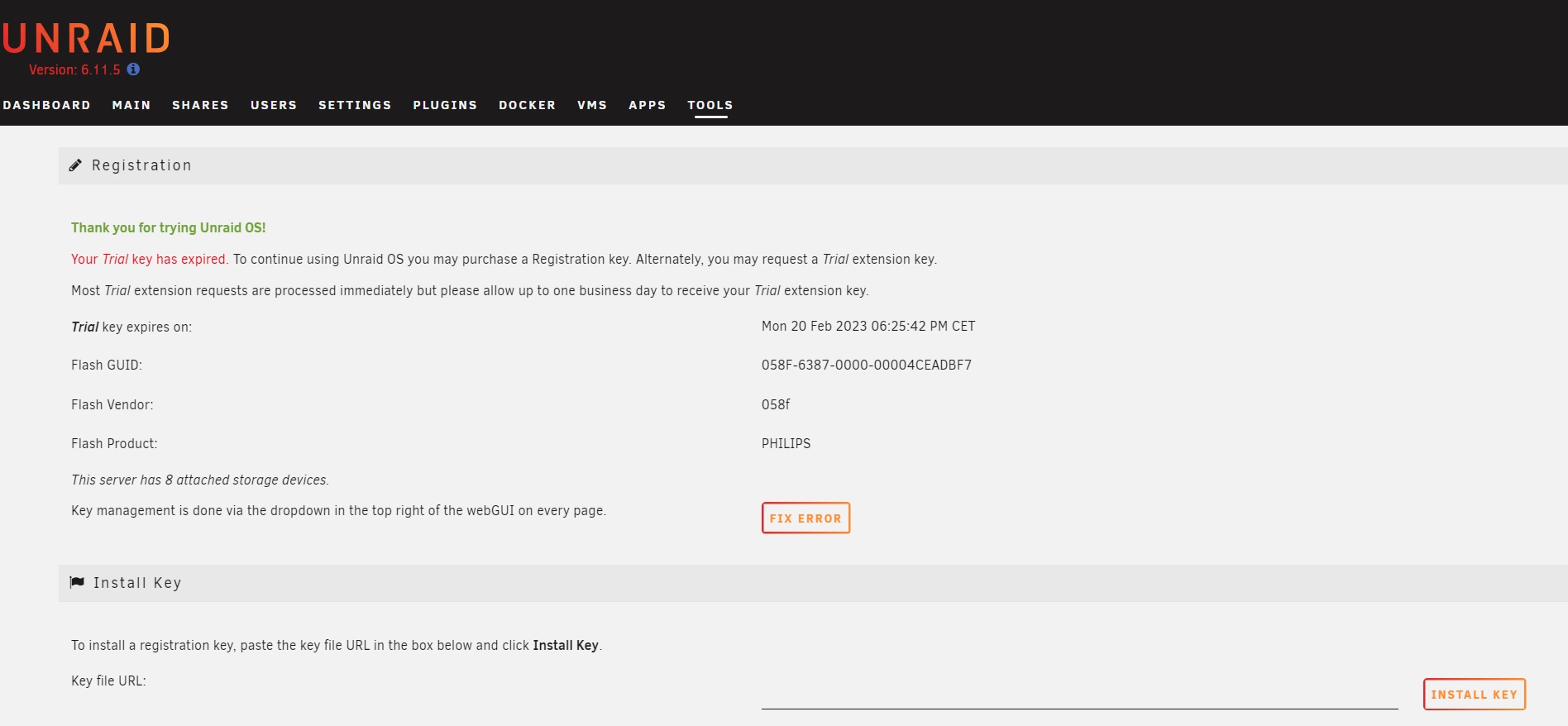

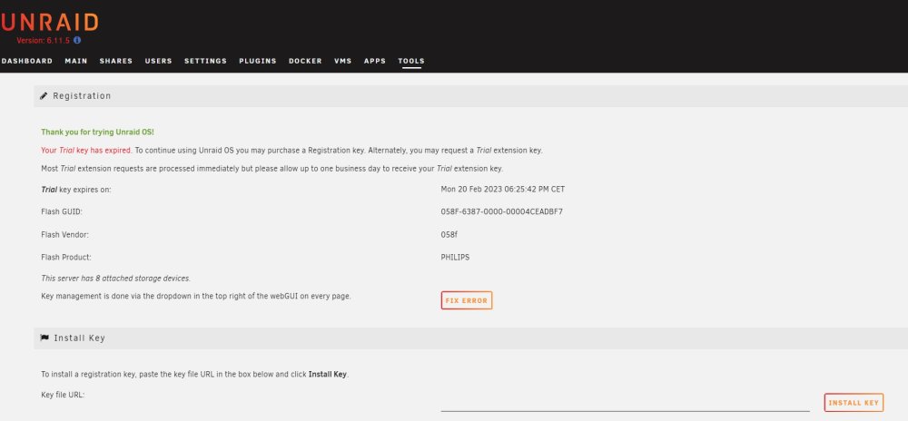

Hi, I'm trying to extend 30 days trial, but no button for me in registration page.
EDIT: after a system restart, i found the link to extend trial in dropdown menu.
Edited by Kaywen
update
Click the drop-down, top right of the GUI (or click fix error), there should be an extend trial option.
Yes, I found it tnx. But only after a system reboot.
