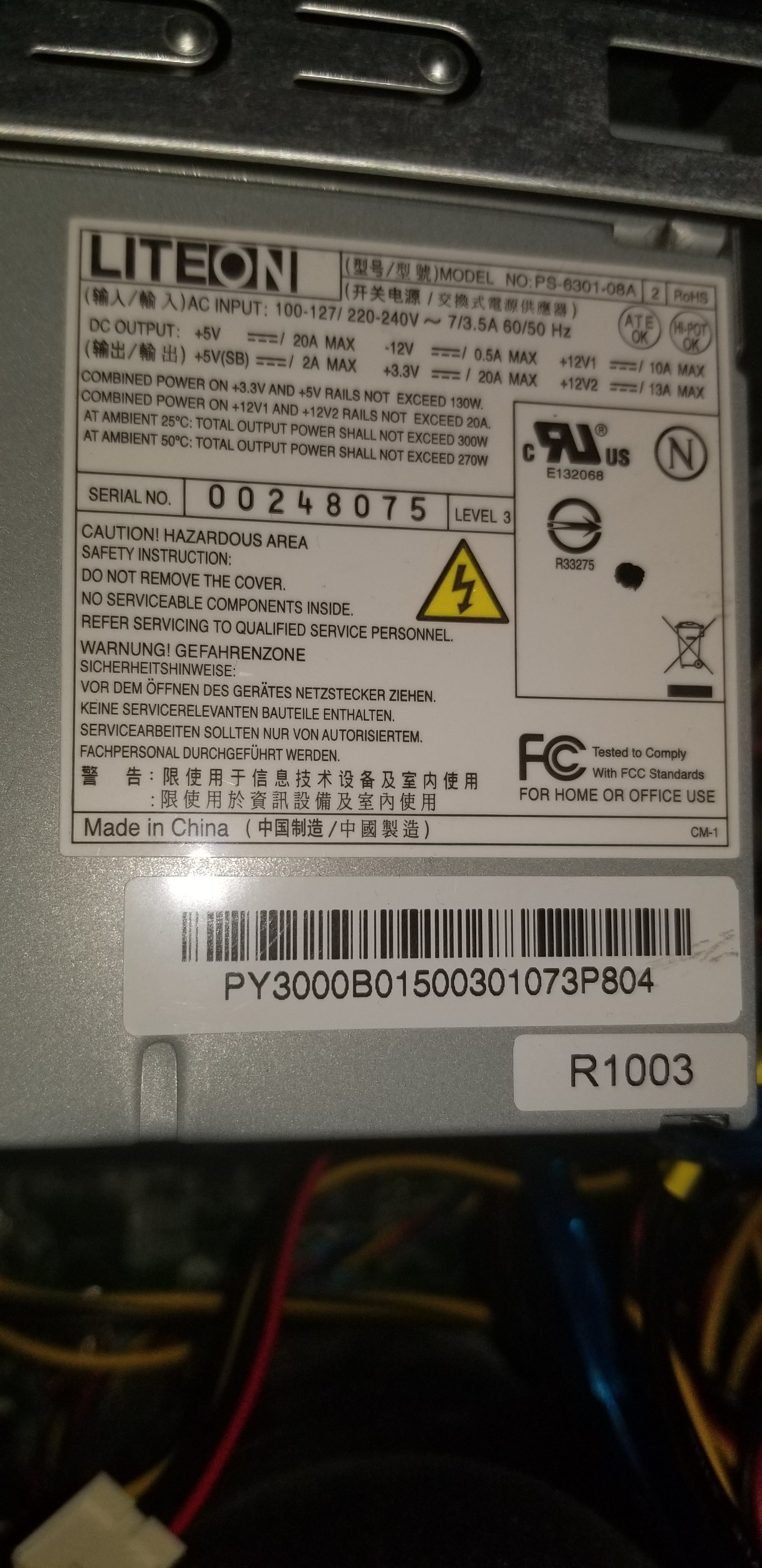

PS.  Here is a picture of my PSU in case you guys find that helpful.

Also notice from the photo 2 +12V rails. Wonder what else might be a reason to worry about this "older computer"?
