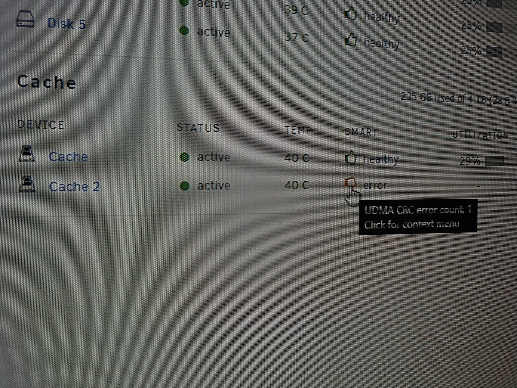

Should I be worried about a UDMA Error Count of 1?  Or can I acknowledge it and continue with my life?  LOL
Edited by EArroyo
