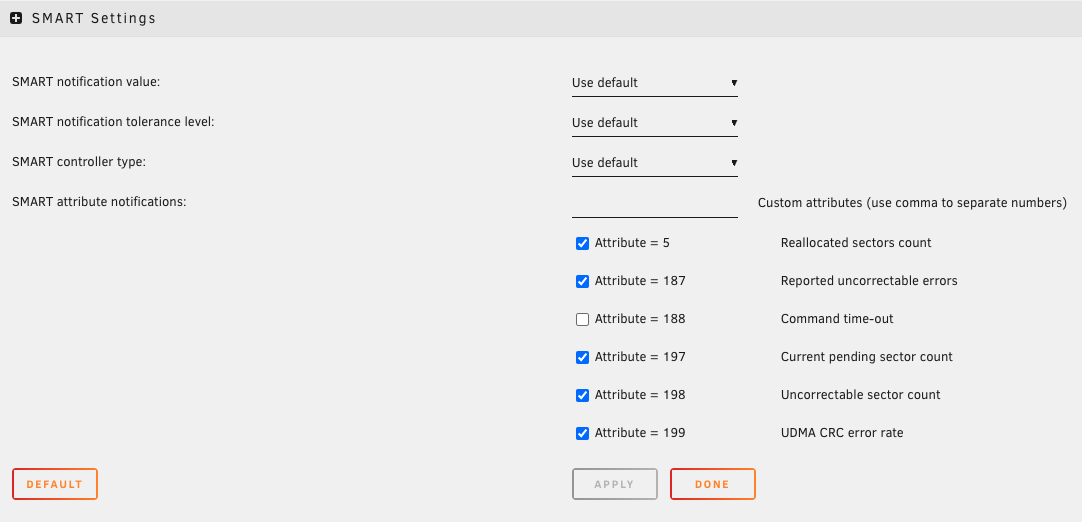

Hi trurl! While I've been waiting on my RMA'd disk, I've been looking into setting up Unraid to monitor said attribute for my WD Red drives.
I've looked at the wiki plus these forums, but am unsure how to add monitoring as discussed above. I assume I go to the disk page, and enter a custom attribute (screenshot of what I'm talking about attached)? Is this correct? What would the syntax for this custom attribute look like?
Just as it says.
Custom attributes (use comma to separate numbers)
You want 1 and 200 so just put 1,200 in the blank and APPLY
Thanks trurl. Looks good now. I was making it more complicated than it needed to be. (i.e. "Attribute = 0" trying to match the checkboxes below).
