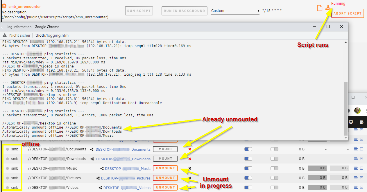

I had massive performance problems with SMB shares that went offline, but were still mounted through Unassigned Devices (UD). As an example lsof took minutes to execute and the unraid mover was nearly dead. While dlandon is not sure how to solve this without risking other issues, I came to this script which could be executed by User Scripts Plugin and a custom schedule of "*/15 * * * *" (every 15 minutes):
  • At first it checks if mounted SMB servers went offline and if yes, unmounts their SMB shares
  • In the second part it checks the UD configuration file for unmounted, but online SMB servers and if the "auto mount" option has been enabled through the UD dashboard, it will automatically remount them
  • Note: This script relies on UD, it's not usable without it

22 minutes ago, dlandon said:
Also add -fl (force, lazy unmount) to the umount command.  The unmount will be forced and will immediately return.
Usually not needed. It takes longer, but it unmounts. But I will maybe update the script, so it's done through UD as well.
