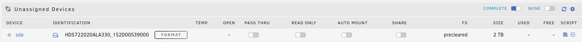

Hi there. I'm new to Unraid so I'm looking for some debugging help. My diagnostics zip file is attached.
I'm running an array with a single 2TB parity drive, 3 2TB storage disks, and a 250GB SSD cache. I want to add another 2TB parity drive. I physically installed the disk and ran the preclear plugin successfully (as far as I can tell). It ran through a pre-read, write, and read back successfully. The disk now shows as "precleared" in Unassigned Devices (see attached).
When I try to assign the precleared 2TB disk to the second parity slot, the Main tab simply refreshes and the disk is not assigned. See attached for a video of the refresh. For the fun of it, I used my browser dev tools to inspect the assignment request - I saw all 200s and nothing in the console. The same behavior occurs when trying to assign it to the array.

 Unraid requires each array disk to have a unique ‘serial number’ to identify it.    It looks like for the first four drives you may have used a 4-bay dock that has generated pseudo serial numbers rather than passing through the drives true serial number.   How have you attached the 5th drive?   If it another bay of the same type then it may be generating a pseudo serial number that is identical to one of the existing drives and if so this will not work.
@itimpi I think your intuition is on the right track. I've got a second 4-bay dock from the same manufacturer for the 5th drive.

Does anyone know where can I find information about how Unraid identifies drives?
Running `udevadm`, I see that each drive is being assigned a `ID_SERIAL` and `ID_SERIAL_SHORT`. Each drive (including my original 4) have a unique `ID_SERIAL` but the same `ID_SERIAL_SHORT`. It looks both were assigned by the drive bays because they do not match the actual serial number of the drives as shown by `smartctl`, which returns accurate metadata about the drives. The `ID_SERIAL` is the same as what Unraid shows in the GUI. Given the pattern of behavior, it seems likely that Unraid is relying on udev identifiers to identify drives.

Unraid identifies drives by their serial number (and it checks the size has not changed).  This should be unique for each drive and set during manufacture.   Many USB docks do not pass this number through to Unraid but generate their own version of a serial.     The true serial should be visible in the SMART report for the dtive.

To give y'all some more details for the fun of it, here's what I'm seeing for the serial number reported by udev and SMART.
root@Jupiter:~# udevadm info --query=all --name=/dev/sda
P: /devices/pci0000:00/0000:00:14.0/usb2/2-3/2-3:1.0/host0/target0:0:0/0:0:0:0/block/sda
N: sda
S: disk/by-id/usb-Hitachi_HDS722020ALA330_152D00539000-0:0
S: disk/by-path/pci-0000:00:14.0-usb-0:3:1.0-scsi-0:0:0:0
E: DEVLINKS=/dev/disk/by-id/usb-Hitachi_HDS722020ALA330_152D00539000-0:0 /dev/disk/by-path/pci-0000:00:14.0-usb-0:3:1.0-scsi-0:0:0:0
E: DEVNAME=/dev/sda
E: DEVPATH=/devices/pci0000:00/0000:00:14.0/usb2/2-3/2-3:1.0/host0/target0:0:0/0:0:0:0/block/sda
E: DEVTYPE=disk
E: ID_BUS=usb
E: ID_INSTANCE=0:0
E: ID_MODEL=HDS722020ALA330
E: ID_MODEL_ENC=HDS722020ALA330\x20
E: ID_MODEL_ID=0567
E: ID_PART_TABLE_TYPE=dos
E: ID_PATH=pci-0000:00:14.0-usb-0:3:1.0-scsi-0:0:0:0
E: ID_PATH_TAG=pci-0000_00_14_0-usb-0_3_1_0-scsi-0_0_0_0
E: ID_REVISION=0125
E: ID_SERIAL=Hitachi_HDS722020ALA330_152D00539000-0:0
E: ID_SERIAL_SHORT=152D00539000
E: ID_TYPE=disk
E: ID_USB_DRIVER=usb-storage
E: ID_USB_INTERFACES=:080650:
E: ID_USB_INTERFACE_NUM=00
E: ID_VENDOR=Hitachi
E: ID_VENDOR_ENC=Hitachi\x20
E: ID_VENDOR_ID=152d
E: MAJOR=8
E: MINOR=0
E: SUBSYSTEM=block
E: USEC_INITIALIZED=54845711930
root@Jupiter:~# smartctl -i /dev/sda
smartctl 7.1 2019-12-30 r5022 [x86_64-linux-4.19.107-Unraid] (local build)
Copyright (C) 2002-19, Bruce Allen, Christian Franke, www.smartmontools.org
=== START OF INFORMATION SECTION ===
Model Family:     Hitachi Deskstar 7K2000
Device Model:     Hitachi HDS722020ALA330
Serial Number:    JK1131YBKA6JWV
LU WWN Device Id: 5 000cca 221e0d349
Firmware Version: JKAOA3EA
User Capacity:    2,000,398,934,016 bytes [2.00 TB]
Sector Size:      512 bytes logical/physical
Rotation Rate:    7200 rpm
Form Factor:      3.5 inches
Device is:        In smartctl database [for details use: -P show]
ATA Version is:   ATA8-ACS T13/1699-D revision 4
SATA Version is:  SATA 2.6, 3.0 Gb/s
Local Time is:    Wed Nov 25 10:13:58 2020 EST
SMART support is: Available - device has SMART capability.
SMART support is: Enabled
It's pretty surprising to me seeing different serial numbers, but I buy that's the reason Unraid is unable to assign this disk.
