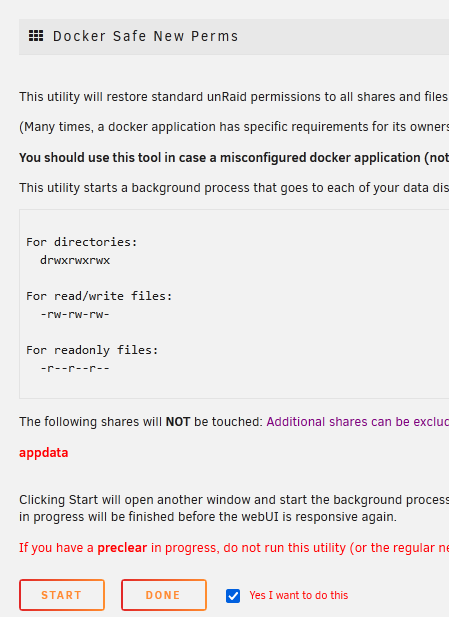

Install the "Fix Common Problems" app.
Then go to Tools -> Docker Safe New Perms.
Check, yes I want to do this. and then hit apply.

After running the fix common problems docker safe permissions thing (excluding appdata as default selected) I'm still getting errors in the unbalance:
    There are some permission issues with the folders/files you want to transfer
    4178 file(s)/folder(s) with an owner other than 'nobody'
    4177 file(s)/folder(s) with a group other than 'users'
    2884 folder(s) with a permission other than 'drwxrwxrwx'
    17667 files(s) with a permission other than '-rw-rw-rw-' or '-r--r--r--'
    You can find more details about which files have issues in the log file (/boot/logs/unbalance.log)
    At this point, you can transfer the folders/files if you want, but be advised that it can cause errors in the operation
    You are STRONGLY suggested to install the Fix Common Problems plugin, then run the Docker Safe New Permissions command
Any ideas?
Did it anyway and it appears to be fine.  Thanks for your notes!
