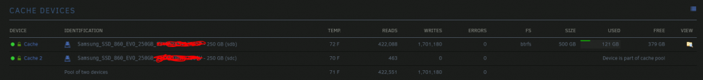

I understand that this was for that particular incident but i figured i would use this for the issue that i am having. i recently upgrade my processor and power supply and thought that everything went well. i started up the array not thinking to look and make sure all devices were in the list and noticed that 1 of my cache drives was missing. i shut everything down checked all my cables, started up the system again, and was able to add it with the indication "all info will be wiped from this drive" because it was now looked at as a new drive seeing the array was started without it the previous boot. i started the array with it and started to get an error... Warning [server] - Cache pool BTRFS missing device(s). im not sure what to do seeing it looks like everything is run fine with the exception of that error. i have attached some images that have lead me to confusion about the issue. i also noticed that my cache pool size is double what it was before the incident. i thought when the drives were pooled that they were only the size of 1 drive because the other is essentially a backup. let me know if there is any other info that can be used to help you help me. i am very much a noob when it comes to terminal and software so please give details of what you would like me to do. Thanks.
i have also done this command that clearly tells me that the device is missing but like i said.... everything looks to be fine out of this.
This will delete all data on that device like the warning says, there's a way to re-add a device without deleting data, but it's likely to late for that, please post the diagnostics: Tools -> Diagnostics
which file out of the zipped folder would you like?
The whole zip file
i have been informed that there was a balance issue and that the array just needs restarted to clear out the missing drive. let me know if you see anything else. thanks.
diagnostics-20210226-0803.zip
Nothing else, but one thing I forgot to mention is before doing that make sure cache backups are up to date, just in case.
that is good advice. i will do that. thanks for the help and i will post an update later tonight on how it goes. thanks again.
that seemed to fix the issue. thanks so much again for the help.
