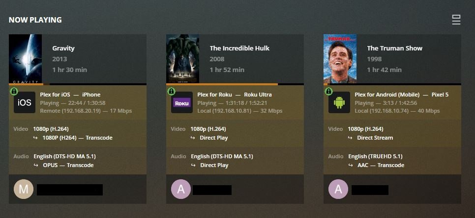

I had this working before. I'm having trouble getting Direct Play/Stream across VLANs. My Plex server is on the 192.168.10.X subnet and I'd like to add some Plex client devices that are on the 192.168.20.X subnet. The devices on that subnet / VLAN20 are showing as "Remote" still. And it's causing it to transcode.
in this test, Client on left showing "Remote" and transcoding. The others are on the same subnet as the server and Direct is working:

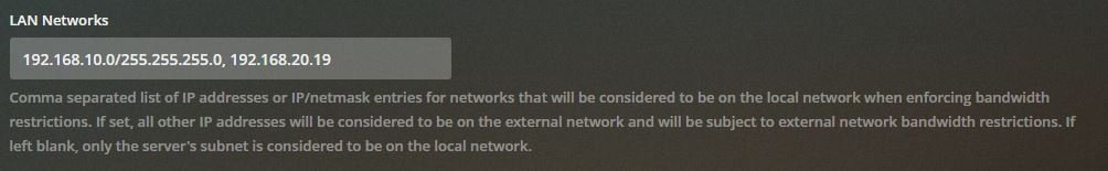

Here is what I entered in the Network tab for LAN Networks:  (the device i'm testing is at 192.168.20.19)

Maybe check your Plex logs for network parsing errors.
My guess would be that your "LAN NETWORKS" setting in Plex may need to be set as follows:
192.168.10.0/24,192.168.20.0/24
or if you want to restrict your second subnet to only one IP:
192.168.10.0/24,192.168.20.19/32
(because technically, "192.168.20.19" is not a network but an IP).
I hope this helps.

yep, thats it. thats how i have it configured and it works perfect

This was exactly it! I set the networks to "192.168.10.0/24,192.168.20.0/24" like you said and it's showing "Local" now.

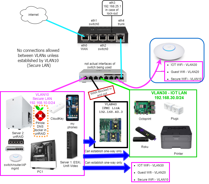

That should make it a bit easier to set up your VLANs all on one device. You could easily set up an IoT network and a separate VLAN for friends/family. That's basically what I did starting out. Then I kept adding. One for IPMI with no WAN access for the Supermicro mobo. One for Dockers, VMs etc...
Here is a little diagram I made so I could keep track lol
But I'd probably be fine with one network. Unless I'm adding shady IoT devices.

That is a really nice setup! Exactly what I am aiming at. For now I don't have time to setup anything that complex. I already had some trouble setting up DUAL-WAN (load-balance and failover) on my router 🙂 . But ultimately I will get to it, and I hope your posts on the UBNT forums will help me ;-)
