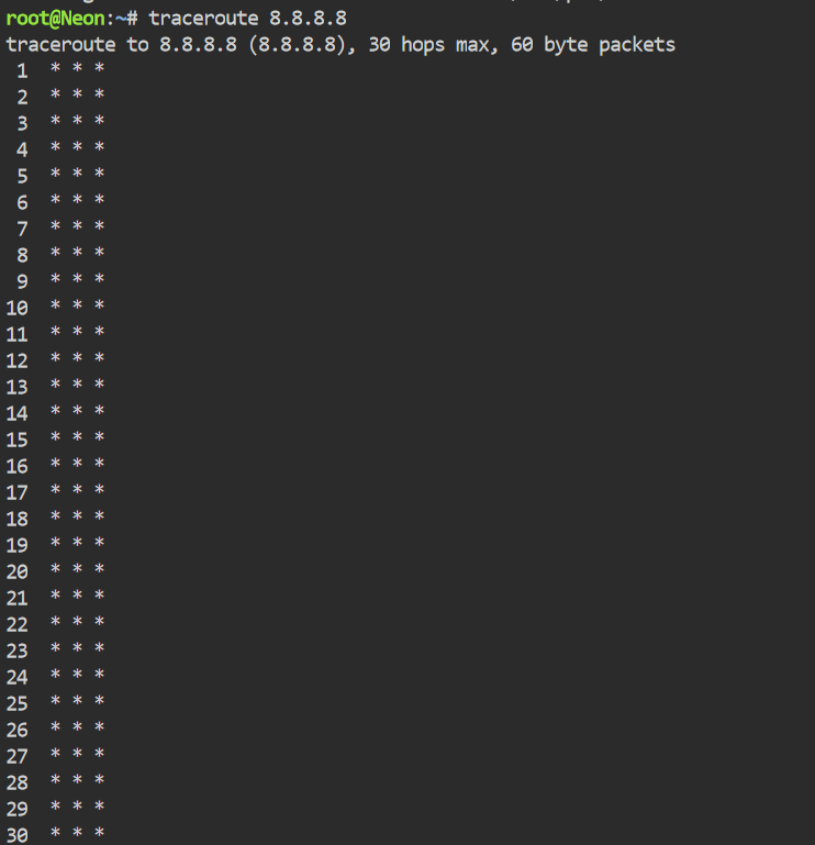

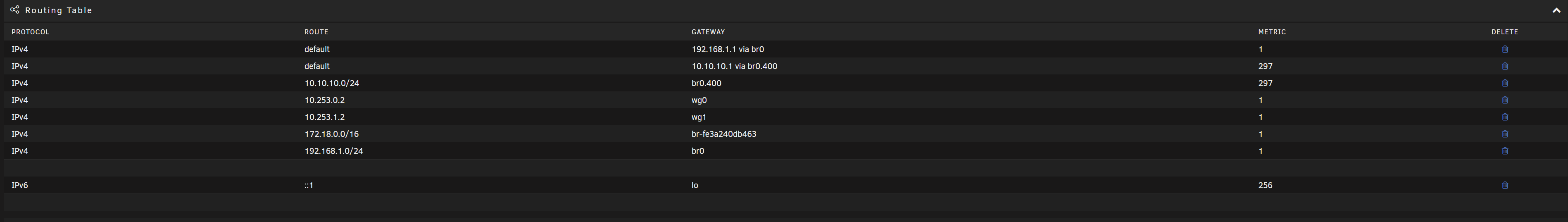

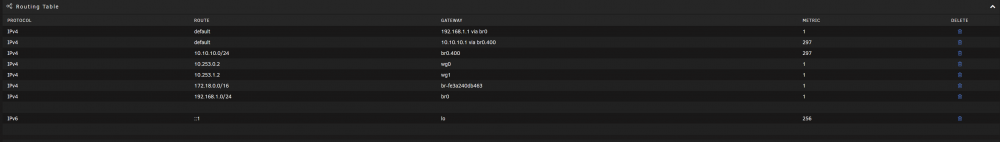

Then I think you should post:
  1. the diagnostics files
  2. copy of the unraid routing table
  3. and maybe the result you get if you issue command < traceroute 8.8.8.8 > in your Unraid terminal
Best
OP
Attached are the things you requested.

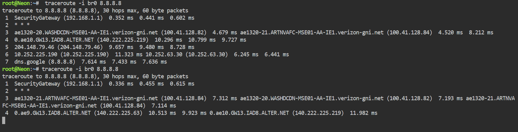

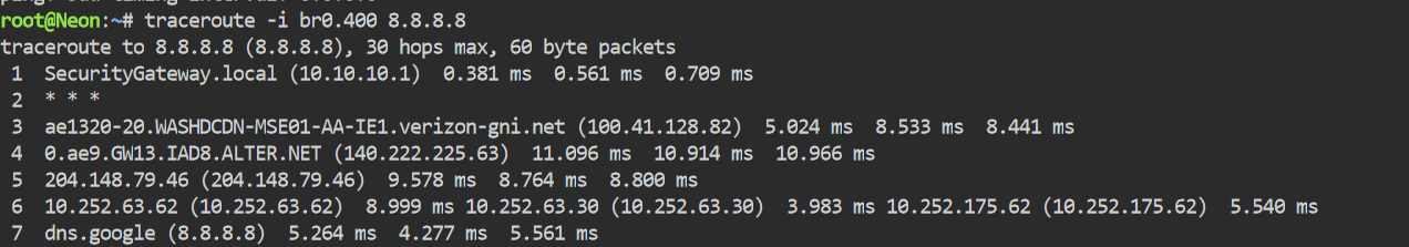

And what about:
  1. < traceroute -i br0 8.8.8.8 > and
  2. < traceroute -i br0.400 8.8.8.8 >  ?

1 minute ago, coolguy1771 said:
I dont see the second command. It seems you issued the no. 1 twice.
Just realized that myself. Btw what does the -i command do?
It enforces the use of the specified interface.
I am by no means an expert, but in your position, I would try maybe to temporarily remove Wireguard (which if I understand correctly created the wg0 and wg1 interfaces and associated routes) to see if that fixes the issue.
Because for what I can see, your Unraid machine can communicate to the internet when we force it to use the br0 or br0.400 interfaces.
(but this is without any warranty ! :) )
Edited by Opawesome

when i specified an interface they pings and trace routes worked. When i tried the same commands without specifying and interface it failed.
