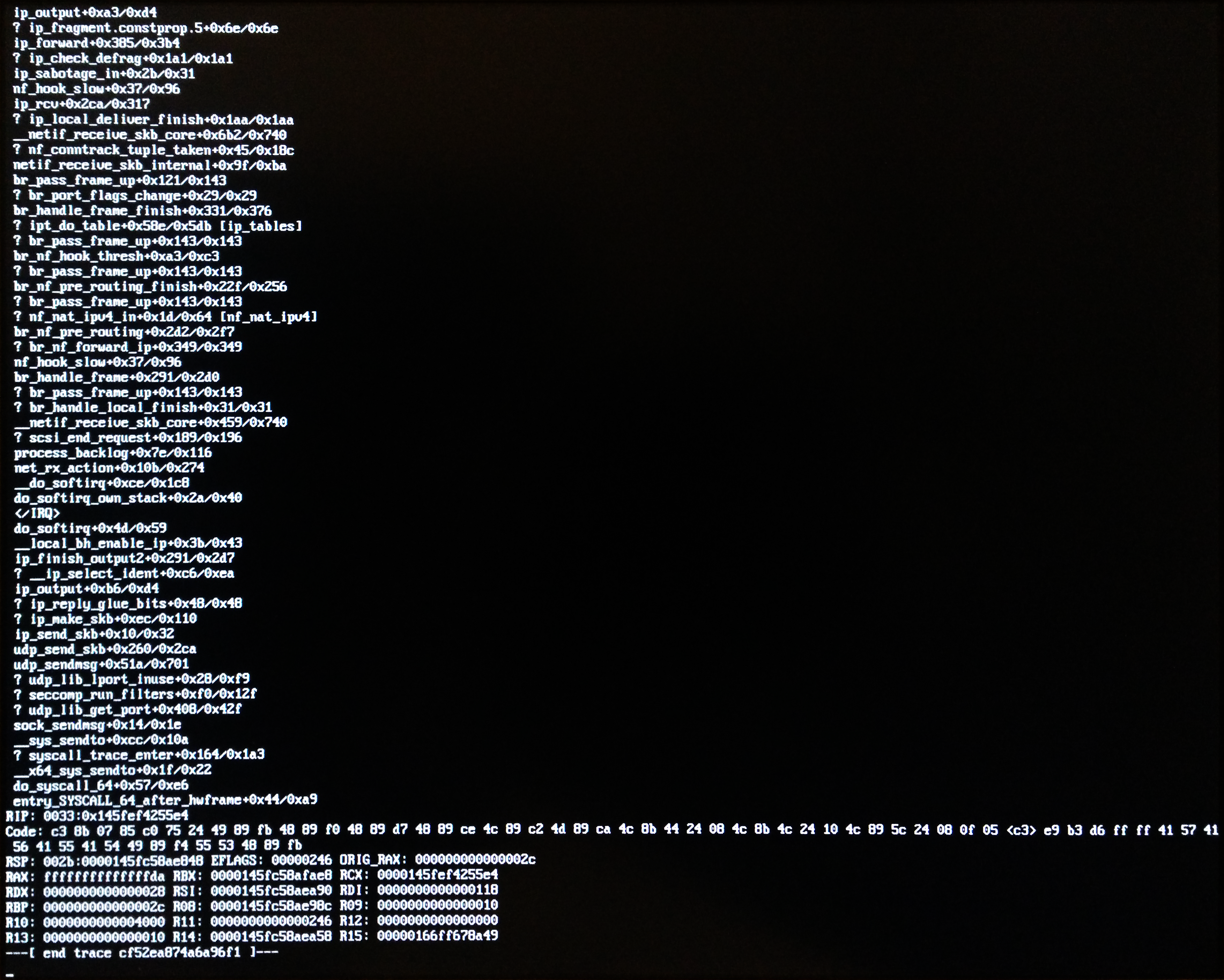

I have an external sata controller that do not like ssd's in unraid, it will just start kicking out disk's running on that controller, im not sure it is unarid to blame or not, but it is not the problem the problem is what follow from that.
I have 2 Parity disks and 6 data disk so 8 disk i total, i also have a cache (SSD) disk in the array, all running BTRFS.
I have had some problems with unraid do a kernel panic like 4-6 times in the last 2-3 months, installed Fix Common Problems, and fixed all the problems, but have not been able to se if that worked, as i by mistake added a SSD more to the system, and added it in the external controller.
So after a day or two it started to kick out 2 disk from the array, (Parity 2 and disk 5), and the new SSD (set as an Unassigned Device) after some high load on the SSD.
Okay fine, i will just stop the array and fix the problem as done before np. Well stoped the array and tryed to powered down the system to be able to moved the SSD to the motherboard, but the system froze like the kernal panic's i had before. Killed the system to turn it on again, when booted problems started, everything looked god i started the array, but then all the disk dipasered from the web gui, all dynamic elements was gone. (i have tryed to make a bug report on that from the gui but im not sure it got sendet as the gui was buged as f. rebooted a few times, and i was able to get the disk to show sometimes and was able to remap the Parity 2 to rebuild that disk as disk 5 and the SSD cache was "Unmountable filsystem" in status, so just before the rebuild i removed disk 5 from the array so i just was emulated during the rebuild.

My data is lost and i will try to recover it, but i hope we can help each other so no one else lose data to and Unmountable filsystem i have added the diagnostics and and old photo of the output of kernel panic as i do not have anything else of it sry.
