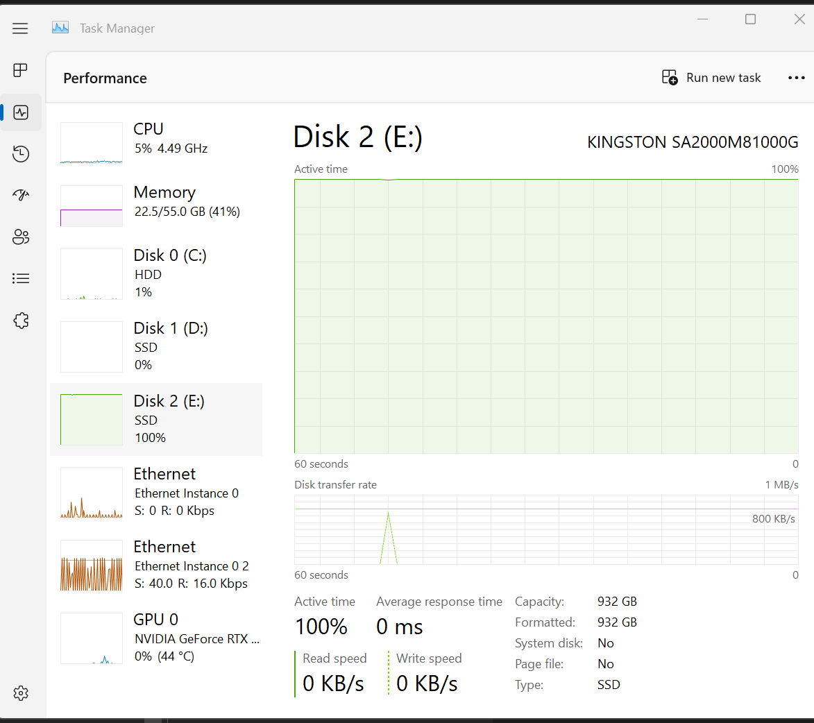

Hi, I recently upgraded my CPU, MOBO, RAM & GPU. 3700x -> 7950x 64GB DDR4 -> 64GB DDR5 x570 Strix e -> x670e Steel Legend RTX 3080 -> RTX 4090 And at the same time i upgraded my Unraid too (because i thought it is a genius idea). I moved my existing NVMe to this one and all is fine, except this 1 issue. So I have 3 SSDs 500gb SSD 870 Samsung Sata - MY OS 1TB 970 Samsung nvme - Games 1TB Kingston nvme - Games and STEAM ISSUE : Now the issue i am facing is that EVERY SSD is fine, except the Kingston one, It also works fine until i start extracting something using WinRAR or Steam extract somegame or something, it becomes 100% active with 0kb/s write & read. If i reboot the VM, it will be 0% and normal, but any intensive work for even a second, it goes to 100%. It might look like the SSD is dying, but here is the catch, if i boot my VM in baremetal (i am bypassing my OS, and both nvmes) mode i.e. directly into Windows instead of Unraid, not a single issue with the SSD, i did a month long experiement in Bare metal mode, and tried everything, it just takes it like a champ, but when in unraid, it just dies at 100% and i cannot even open a drive without waiting like 10m. Diagnostics & VM Config attached. <?xml version='1.0' encoding='UTF-8'?> <domain type='kvm' id='1' xmlns:qemu='http://libvirt.org/schemas/domain/qemu/1.0'> <name>Windows 11</name> <uuid>91e3db4e-c2a8-25a5-684c-361208a87c0a</uuid> <metadata> <vmtemplate xmlns="unraid" name="Windows 11" icon="windows11.png" os="windowstpm"/> </metadata> <memory unit='KiB'>57671680</memory> <currentMemory unit='KiB'>57671680</currentMemory> <memoryBacking> <nosharepages/> </memoryBacking> <vcpu placement='static'>28</vcpu> <cputune> <vcpupin vcpu='0' cpuset='2'/> <vcpupin vcpu='1' cpuset='18'/> <vcpupin vcpu='2' cpuset='3'/> <vcpupin vcpu='3' cpuset='19'/> <vcpupin vcpu='4' cpuset='4'/> <vcpupin vcpu='5' cpuset='20'/> <vcpupin vcpu='6' cpuset='5'/> <vcpupin vcpu='7' cpuset='21'/> <vcpupin vcpu='8' cpuset='6'/> <vcpupin vcpu='9' cpuset='22'/> <vcpupin vcpu='10' cpuset='7'/> <vcpupin vcpu='11' cpuset='23'/> <vcpupin vcpu='12' cpuset='8'/> <vcpupin vcpu='13' cpuset='24'/> <vcpupin vcpu='14' cpuset='9'/> <vcpupin vcpu='15' cpuset='25'/> <vcpupin vcpu='16' cpuset='10'/> <vcpupin vcpu='17' cpuset='26'/> <vcpupin vcpu='18' cpuset='11'/> <vcpupin vcpu='19' cpuset='27'/> <vcpupin vcpu='20' cpuset='12'/> <vcpupin vcpu='21' cpuset='28'/> <vcpupin vcpu='22' cpuset='13'/> <vcpupin vcpu='23' cpuset='29'/> <vcpupin vcpu='24' cpuset='14'/> <vcpupin vcpu='25' cpuset='30'/> <vcpupin vcpu='26' cpuset='15'/> <vcpupin vcpu='27' cpuset='31'/> </cputune> <resource> <partition>/machine</partition> </resource> <os> <type arch='x86_64' machine='pc-i440fx-6.2'>hvm</type> <loader readonly='yes' type='pflash'>/usr/share/qemu/ovmf-x64/OVMF_CODE-pure-efi-tpm.fd</loader> <nvram>/etc/libvirt/qemu/nvram/91e3db4e-c2a8-25a5-684c-361208a87c0a_VARS-pure-efi-tpm.fd</nvram> </os> <features> <acpi/> <apic/> <hyperv mode='custom'> <relaxed state='on'/> <vapic state='on'/> <spinlocks state='on' retries='8191'/> <vendor_id state='on' value='none'/> </hyperv> </features> <cpu mode='host-passthrough' check='none' migratable='on'> <topology sockets='1' dies='1' cores='14' threads='2'/> <cache mode='passthrough'/> <feature policy='require' name='topoext'/> </cpu> <clock offset='localtime'> <timer name='hypervclock' present='yes'/> <timer name='hpet' present='no'/> </clock> <on_poweroff>destroy</on_poweroff> <on_reboot>restart</on_reboot> <on_crash>restart</on_crash> <devices> <emulator>/usr/local/sbin/qemu</emulator> <disk type='block' device='disk'> <driver name='qemu' type='raw' cache='writeback'/> <source dev='/dev/disk/by-id/ata-Samsung_SSD_860_EVO_500GB_S4FNNF0NB21554M' index='1'/> <backingStore/> <target dev='hdc' bus='sata'/> <boot order='1'/> <alias name='sata0-0-2'/> <address type='drive' controller='0' bus='0' target='0' unit='2'/> </disk> <controller type='pci' index='0' model='pci-root'> <alias name='pci.0'/> </controller> <controller type='sata' index='0'> <alias name='sata0'/> <address type='pci' domain='0x0000' bus='0x00' slot='0x04' function='0x0'/> </controller> <controller type='virtio-serial' index='0'> <alias name='virtio-serial0'/> <address type='pci' domain='0x0000' bus='0x00' slot='0x05' function='0x0'/> </controller> <controller type='usb' index='0' model='qemu-xhci' ports='15'> <alias name='usb'/> <address type='pci' domain='0x0000' bus='0x00' slot='0x07' function='0x0'/> </controller> <interface type='bridge'> <mac address='52:54:00:71:78:d9'/> <source bridge='br0'/> <target dev='vnet0'/> <model type='virtio-net'/> <alias name='net0'/> <address type='pci' domain='0x0000' bus='0x00' slot='0x02' function='0x0'/> </interface> <interface type='bridge'> <mac address='52:54:00:a6:76:f9'/> <source bridge='br1'/> <target dev='vnet1'/> <model type='virtio-net'/> <alias name='net1'/> <address type='pci' domain='0x0000' bus='0x00' slot='0x03' function='0x0'/> </interface> <serial type='pty'> <source path='/dev/pts/0'/> <target type='isa-serial' port='0'> <model name='isa-serial'/> </target> <alias name='serial0'/> </serial> <console type='pty' tty='/dev/pts/0'> <source path='/dev/pts/0'/> <target type='serial' port='0'/> <alias name='serial0'/> </console> <channel type='unix'> <source mode='bind' path='/var/lib/libvirt/qemu/channel/target/domain-1-Windows 11/org.qemu.guest_agent.0'/> <target type='virtio' name='org.qemu.guest_agent.0' state='disconnected'/> <alias name='channel0'/> <address type='virtio-serial' controller='0' bus='0' port='1'/> </channel> <input type='tablet' bus='usb'> <alias name='input0'/> <address type='usb' bus='0' port='1'/> </input> <input type='mouse' bus='ps2'> <alias name='input1'/> </input> <input type='keyboard' bus='ps2'> <alias name='input2'/> </input> <tpm model='tpm-tis'> <backend type='emulator' version='2.0' persistent_state='yes'/> <alias name='tpm0'/> </tpm> <audio id='1' type='none'/> <hostdev mode='subsystem' type='pci' managed='yes'> <driver name='vfio'/> <source> <address domain='0x0000' bus='0x01' slot='0x00' function='0x0'/> </source> <alias name='hostdev0'/> <rom file='/mnt/user0/vbios/NVIDIA.RTX4090.24576.220830.rom'/> <address type='pci' domain='0x0000' bus='0x00' slot='0x06' function='0x0' multifunction='on'/> </hostdev> <hostdev mode='subsystem' type='pci' managed='yes'> <driver name='vfio'/> <source> <address domain='0x0000' bus='0x01' slot='0x00' function='0x1'/> </source> <alias name='hostdev1'/> <address type='pci' domain='0x0000' bus='0x00' slot='0x06' function='0x1'/> </hostdev> <hostdev mode='subsystem' type='pci' managed='yes'> <driver name='vfio'/> <source> <address domain='0x0000' bus='0x07' slot='0x00' function='0x0'/> </source> <alias name='hostdev2'/> <address type='pci' domain='0x0000' bus='0x00' slot='0x10' function='0x0'/> </hostdev> <hostdev mode='subsystem' type='pci' managed='yes'> <driver name='vfio'/> <source> <address domain='0x0000' bus='0x16' slot='0x00' function='0x4'/> </source> <alias name='hostdev3'/> <address type='pci' domain='0x0000' bus='0x00' slot='0x08' function='0x0'/> </hostdev> <hostdev mode='subsystem' type='pci' managed='yes'> <driver name='vfio'/> <source> <address domain='0x0000' bus='0x04' slot='0x00' function='0x0'/> </source> <alias name='hostdev4'/> <address type='pci' domain='0x0000' bus='0x00' slot='0x0d' function='0x0'/> </hostdev> <hostdev mode='subsystem' type='pci' managed='yes'> <driver name='vfio'/> <source> <address domain='0x0000' bus='0x15' slot='0x00' function='0x0'/> </source> <alias name='hostdev5'/> <address type='pci' domain='0x0000' bus='0x00' slot='0x0a' function='0x0'/> </hostdev> <hostdev mode='subsystem' type='usb' managed='no'> <source> <vendor id='0x046d'/> <product id='0xc08b'/> <address bus='3' device='3'/> </source> <alias name='hostdev6'/> <address type='usb' bus='0' port='2'/> </hostdev> <hostdev mode='subsystem' type='usb' managed='no'> <source> <vendor id='0x0e8d'/> <product id='0x0616'/> <address bus='3' device='5'/> </source> <alias name='hostdev7'/> <address type='usb' bus='0' port='3'/> </hostdev> <hostdev mode='subsystem' type='usb' managed='no'> <source> <vendor id='0x1532'/> <product id='0x0244'/> <address bus='1' device='2'/> </source> <alias name='hostdev8'/> <address type='usb' bus='0' port='4'/> </hostdev> <hostdev mode='subsystem' type='usb' managed='no'> <source> <vendor id='0x1b1c'/> <product id='0x1b2d'/> <address bus='3' device='4'/> </source> <alias name='hostdev9'/> <address type='usb' bus='0' port='5'/> </hostdev> <hostdev mode='subsystem' type='usb' managed='no'> <source> <vendor id='0x26ce'/> <product id='0x01a2'/> <address bus='9' device='2'/> </source> <alias name='hostdev10'/> <address type='usb' bus='0' port='6'/> </hostdev> <memballoon model='none'/> </devices> <seclabel type='dynamic' model='dac' relabel='yes'> <label>+0:+100</label> <imagelabel>+0:+100</imagelabel> </seclabel> <qemu:commandline> <qemu:arg value='-fw_cfg'/> <qemu:arg value='opt/ovmf/X-PciMmio64Mb,string=65536'/> </qemu:commandline> </domain> tower-diagnostics-20221222-2114.zip

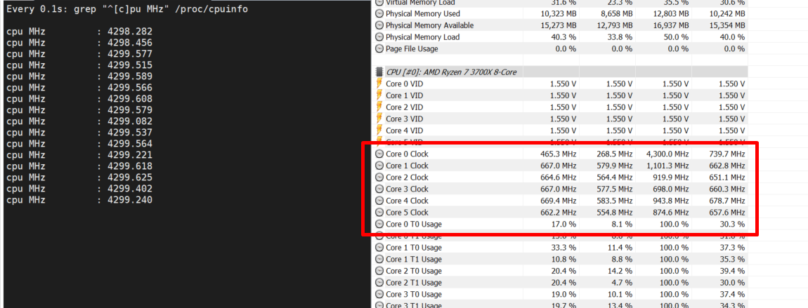

For now the game is working fine.... However after u said it could be CPU issue. The CPU usage in mhz in VM is so low, however on main server it is 4.3ghz locked (i have set it in bios). Even at 100% CPU usage, the mhz is low, is it showing wrong reading? PS: Core 0 does go upto 4.3ghz. but thats the only one. I noticed something -

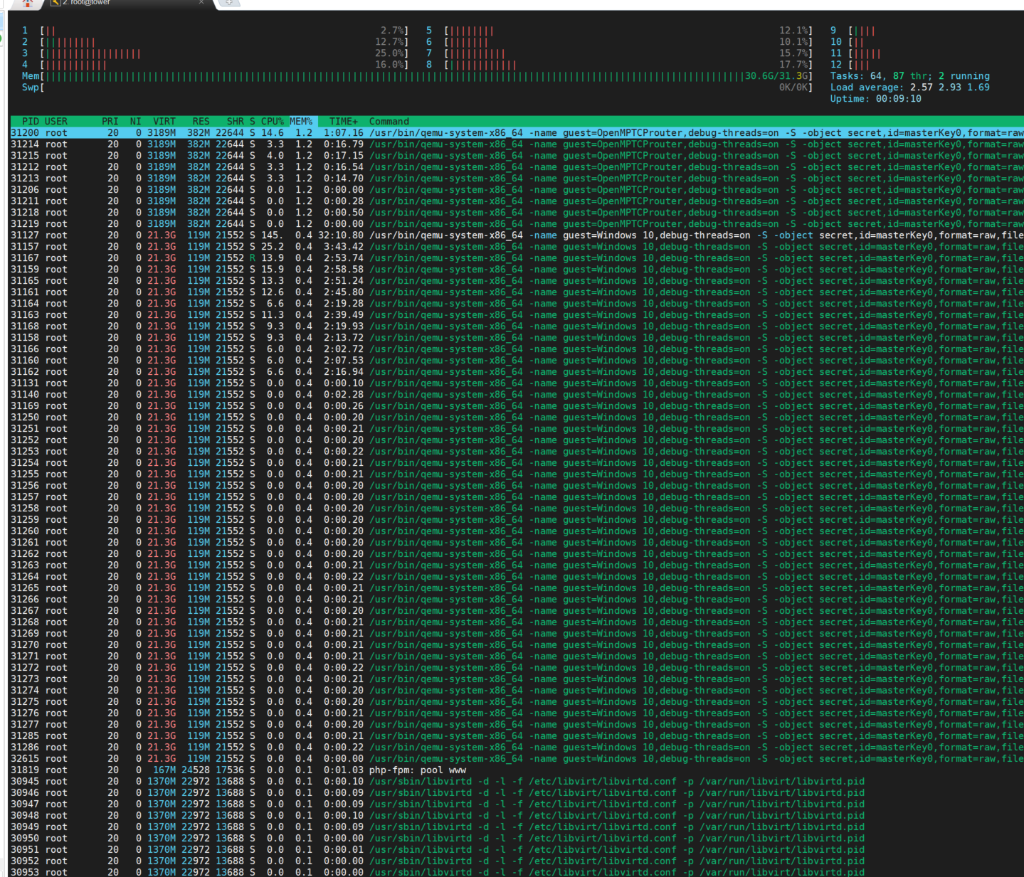

For some reason, unraid is eating the ram like nothing and in turn turning off VM when underload. I have only 2 VM on the server and 6-7 docker (yes i know they need ram), but when i took the free -mh, i turned off the docker completely from the setting and then rebooted the unraid server. This is fresh off the boot. available only 433mb. However i have 32gb ram of which 20gb is allocated to Windows VM & 2.5gb is allocated to linux VM. Thats 22.5gb, and yet it says 28gb is used. This remains same weather i set the Windows VM to 20gb or 25gb. So something is clearly wrong here. Diagnostic attached too. PS: in windows vm i am using hugepages. My linux VM goes down the moment server runs out of ram to allocate. Every 2.0s: free -mh Tower: Thu Oct 28 16:11:05 2021 total used free shared buff/cache available Mem: 31Gi 28Gi 644Mi 1.8Gi 1.9Gi 433Mi Swap: 0B 0B 0B Attached pic of htop too. tower-diagnostics-20211028-1615.zip
