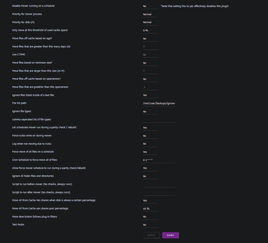

  12. So I put a file container the folders / paths I would like to exclude from the 'Mover' process My ignore-files.txt is located in '/mnt/user/backups/' inside of the file I have the directories / folders listed like so /mnt/cache_downloads/data/usenet /mnt/cache_downloads/data/usenet/incomplete and so on, unfortunately it doesn't seem to be working, any help would be greatly appreciated. Thank you! Attached picture of my 'Mover' Settings.
