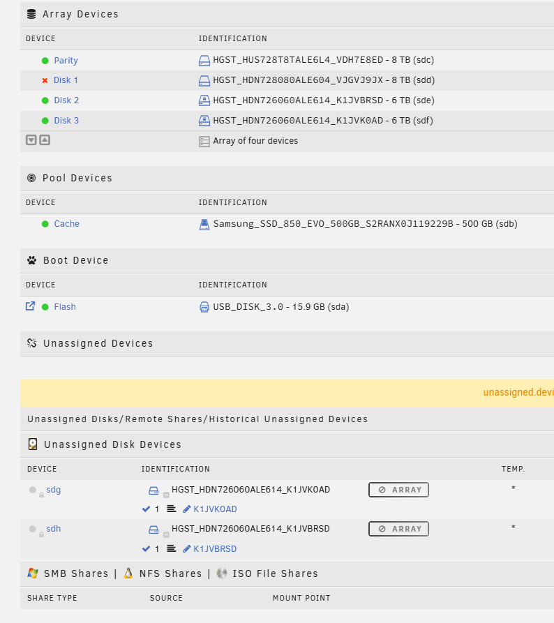

Failed in the 10th hour: I swapped everything to bays 5-8 to use the other set of breakouts and then it all went fine and the rebuild was good and I'm back up and running and have ordered new cables. Thanks for everyone's time.

Update: solved? Spoke to some people and was able to determine it was a fried hba that I had not cooled properly during it's life (whoops). Had a spare and that one has a temp fan cooling it to 32c and will get a fan bracket. The new hba allowed me to boot as normal with data intact just emulated, was able to backup all that wasn't already backed up. Dropped to maintenance mode and passed a file system check and had 0 errors, did an extended smart test (18h) and passed so am now rebuilding to that same disk per the documentation. Should be resolved in 10 hours hopefully. Thanks and I'll report back.

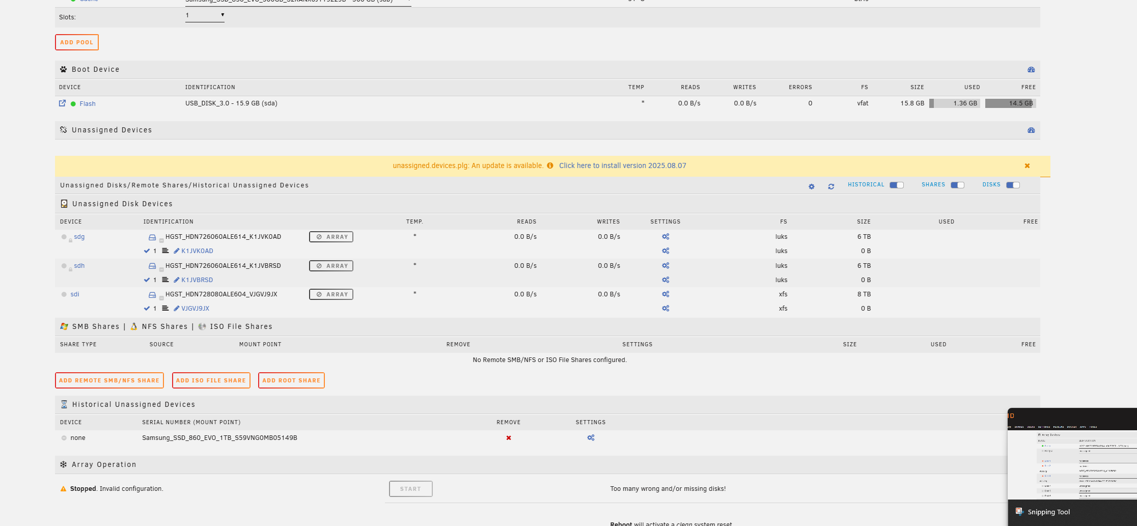

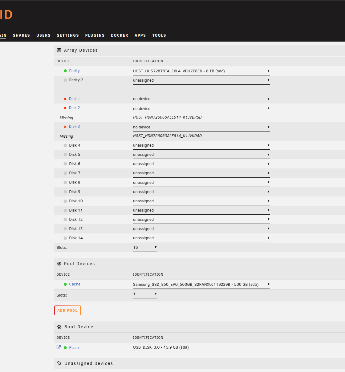

TLDR: was a bad set of breakout cables caused buy a perhaps fried HBA (keeping the spare HBA in for now). I just updated to 7.1.4 from v6 a few days ago in case this matters. I got a message that multiple drives had errors suddenly and that one had been disabled. I went into the gui and saw Disk 1 was disabled and being emulated. I went to Shares to see if anything was there and 0 shares showed up, even the ones my others disk use. I stopped the array and then in the disk listing it now said it was missing a bunch of them and they were at the bottom as unassigned. I thought this was all odd so I rebooted the whole machine and when it came back up the gui showed all my disks fine except for the Disk 1 disabled still. I started the array in Maintenance Mode and ran a File System (file system is xfs) check and everything it tried failed with: xfs_repair: read failed: Input/output error. All the drives are attached to a H310 PERC with a Jonsbo backplane. Has my HBA just suddenly like kicked the bucket? The contents of my emails: Event: Unraid array errors Subject: Warning [RVC-NAS] - array has errors Description: Array has 3 disks with read errors Importance: warning Disk 1 - HGST_HDN728080ALE604_VJGVJ9JX (sdd) (errors 2) Disk 2 - HGST_HDN726060ALE614_K1JVBRSD (sde) (errors 1) Disk 3 - HGST_HDN726060ALE614_K1JVK0AD (sdf) (errors 1) Event: Unraid Disk 1 error Subject: Alert [RVC-NAS] - Disk 1 in error state (disk dsbl) Description: HGST_HDN728080ALE604_VJGVJ9JX (sdd) Importance: alert In Maintenance Mode AFTER I Stopped the ARRAY the first time. Before the REBOOT.

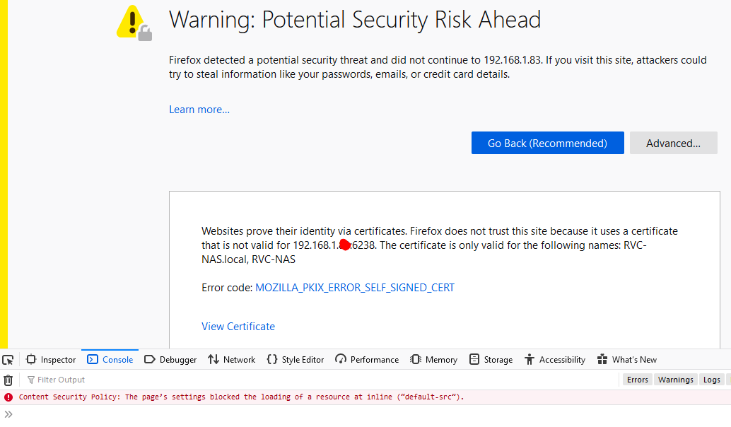

OMG so I went down a rabbit hole and for anyone who had this issue this is what I got. I had to end up going to dashboard/settings/management access/ then provision my ssl cert on unraid's lets encrypt dns thing and it made my own dns cert and then I had to turn off the plugin and turn it back on and now it works and now i'm down to just working out the normal permission stuff (sys at the moment I have files attached to nobody). The plugin and webui is now pointed to the huge long cert url unraid uses for https then my port for reference. EDIT: Thanks again for the quick help. I got all my stuff moved over then encrypted my other drives and got my shares set how I want them.

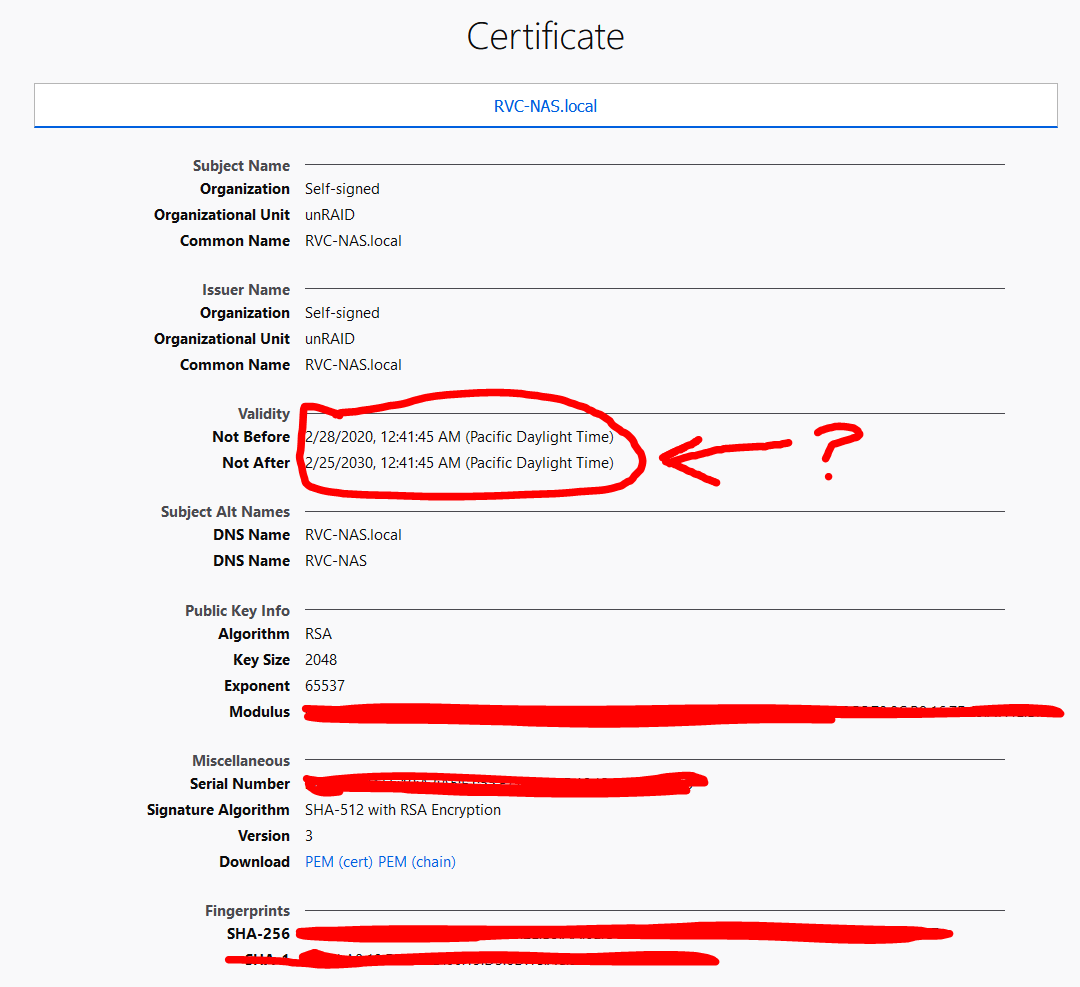

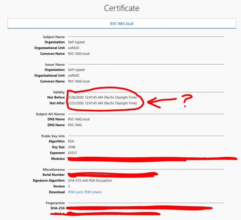

I just updated to 6.8.3 from 6.8.2 and downloaded firefox to test and get the same issue and it does say that it is trying to load a self cert that is only good for the name of what I named my NAS in the unraid info menu. I do not know how to check if there is a self cert setting or something somewhere. I also noticed that the cert it is making is I guess invalid as it seems to have the wrong date completely on it. My unraid does have the right UTC ect. Realized it shows 2030 as the end date so I guess the date is not the issue. Thanks for the help so far.

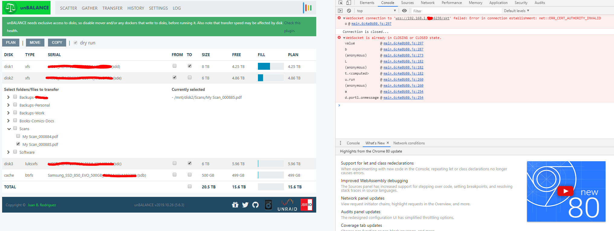

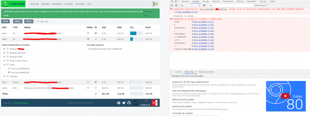

Okay I don't know what is wrong, first time using this and I want to move all data from disk 2 to disk 3 which is Luks:xfs and then later I will make disk 2 also encrypted and then set the shares to use both disks. I select what I want and I get the plan button, click it and only get the animation in top right no log window lowering, and the ui just becomes unresponsive after that unless you refresh and that just makes it start all over as if nothing has happened. If I click on Log at the top it does the same thing and none of the buttons up top are clickable anymore. I have tried doing this in Chrome, Chrome Incognito, Edge. All get the same thing and first complain that the sites not secure but I just tell it load it anyways as it just has no cert (is it supposed to?). Any advice? EDIT: attached log that shows it is writing to it but only on like load up of the web ui and refresh of the ui. unbalance.log
