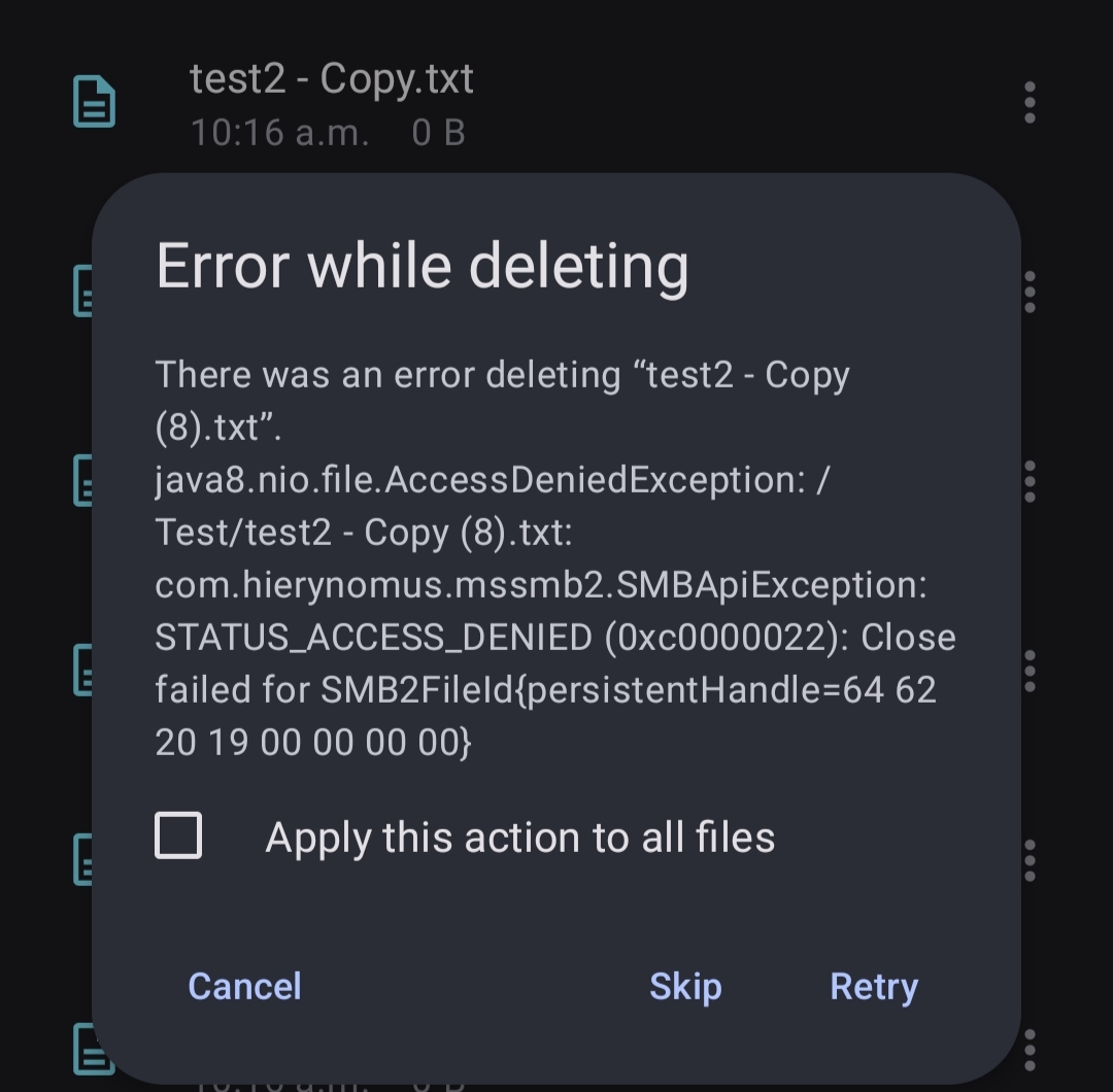

Permission errors in 6.11.0 when deleting files from phone with android file managers
I just updated from 6.9.2 to 6.11.0 and when I'm deleting files off of shares from my android phone using a file manager there (and I've tried more than one) I'm now getting errors that "Permission is denied. No item deleted." but when I refresh the folder the item IS deleted. Happening in private, secure, and public folders but does NOT seem to be affecting deleting files with windows (what world is this that android is affected but not windows). No idea what is going on here but didn't experience this before with 6.9.2. I've tried multiple phones that previously didn't have issues and also creating files with an actual user and a guest (so the file ends up shown as owned by either myusername or nobody. Any thoughts? I've run "docker safe new permissions" just in case but it didn't change anything.
Edit: I rolled back to 6.9.2 and issue went away. What in 6.11.0 would affect this? I'd love to update, but need to be able to manage files by my phone.

@Frank1940 @kizerOK, updated to 6.11.0 again and issue remains. I've attached the screenshot of the ls -al /mnt/user command.  I'm still unclear exactly how the fix permissions should be executed: do I include all drives and all user shares? not include the cache drive? Not include the appdata folder? I had some files in the Test share that I was using to test deleting files so I ran the new permissions script on just that folder that and still have the same issue. Thoughts on next steps?
I'll add that I've noticed I can cut a file and move it to a different place without issue, just getting the issue when trying to delete.
Part of me wonders if it is a samba change from what was in 6.9.2 and the file managers I'm using aren't updated for the samba changes.

My main device is a oneplus 8T on android 12 but, again, I've tried this on several different phones. I've also used different file managers and three of them give errors but one of them didn't (very interesting). I've also emailed the dev of one the main file manager I use to provide as much info as I can, including your information on the new samba versions.
As for my use case, I just download some things manually and then manually move bits and delete other parts. I'm not aware of unraid having a trash, but that isn't really what I'm looking to do anyways, and would require more work/steps than just deleting a file. I do suspect the issue is at the app level, but perhaps samba itself is in the phone system and not the app and the app that works is just suppressing the error message...

Yes, 100% sure. The permission issue arises even in public folders when using anonymous users or named users. Again, the file DOES get deleted, these apps just say there is a permissions error and that they can't delete it. It is very weird. I included a screenshot of the error above as it was more informative than other apps which were giving the error.

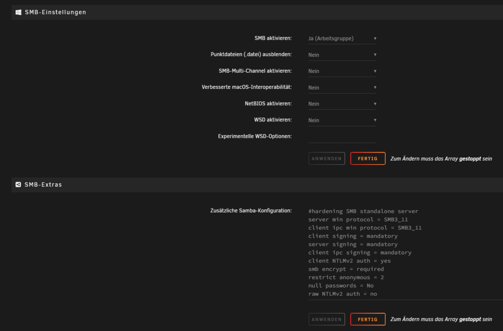

The only thing I can think of right now is 6.11 uses a different version of Samba that 6.9.2 uses.
I wonder if something needs to be placed in smb-extra to make it work.
Maybe - I've never added anything there before. I wonder if apps need to be updated to be able to work properly with newer versions of samba and perhaps most aren't updated yet. Really weird.

Could very well be. Or if the guys at limetech had a bit more info maybe they could shine a little more light on the subject as far as what a fix could be maybe even a tweak on your system.  Problem not knowing what the problem is its hard to address.  Does your logs show anything either on the app or unraid. I know you posted a screen shot, but is there anything else?

So I've been in touch with a developer of one of the apps that I am having an issue with and they aren't getting issues with Samba on Ubuntu. This is what they said:
Finally I had the time to test this: I have compiled and installed Samba 4.17.0 from the official Samba sources now on Ubuntu 22.04 LTS. Then I have created a small sample server and placed some files on the share. I did NOT get any errors when deleting these files with my LAN plugin. I tried connecting via SMB1, SMB2, and SMB3, plus SMB3 with encrypted transfers. The files were just deleted without issues.

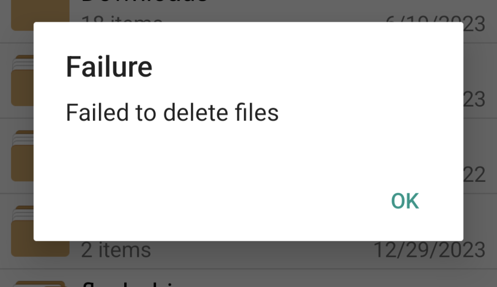

I'm really struggling with this as it affects my ability to remotely manage files from my phone. I'm on 6.11.1 now but same issue persists. I've chatted with another person on discord that is getting the same issues - not sure if this is an unraid issue here or what but, again, it is really changing how I do things. Any thoughts @ljm42?

Perplexing. Can you give me a link to the app in the Google Play store? And then the simplest set of steps you can think of for reproducing the problem?
@ljm42 There are several apps that don't work and a few that do. See this youtube video [edit: removed video] of me going through some of the apps and showing the errors and then the file deleting (generally just the first file if I have selected multiple). As for reproducing this, I'm experiencing this just when trying to delete files from a SMB share from any of my android phones, regardless of whether in a private or public share - I made a bunch of txt files as tests, as you can see in the video.
Non-Working Apps (which all worked on 6.9.2 and previous):
Working Apps:
I'll note that while File Manager Plus works to delete, the other apps like MiX Explorer would allow immediate moves between shares if I was browsing through the same folder path (like Krusader does) whereas copy/paste with File Manager Plus will move the file but will actually copy it over to move it. While this share is public and I've tried with phones that are logged in to a user profile as well as ones that aren't, it is possible that this is a permissions peculiarity with some shares being private and some public (though I have issues regardless of what type for deleting files) and I had no errors of this sort on 6.9.2. I also sometimes get errors and the inability to move files from certain paths to other locations via the apps (though no issues via windows or Krusader).
I'm pulling my hair out and will do whatever I can to provide information I can to support.
Edited by aqua
Good news / bad news
The good news is that I can replicate this. I installed Total Commander on my Android phone and connected to a 6.11.1 server and got the strange error messages when deleting files.  It didn't matter whether the logged in user was the owner of the file or not, even with full perms the error showed and then inexplicably the file was deleted anyway.
Connecting the same app to Unraid 6.9.2 resulted in files being deleted without throwing any error messages.
And Windows is able to delete from either without any error messages.
The bad news is that this makes no sense to me. I've raised awareness of this internally and am open to ideas.
