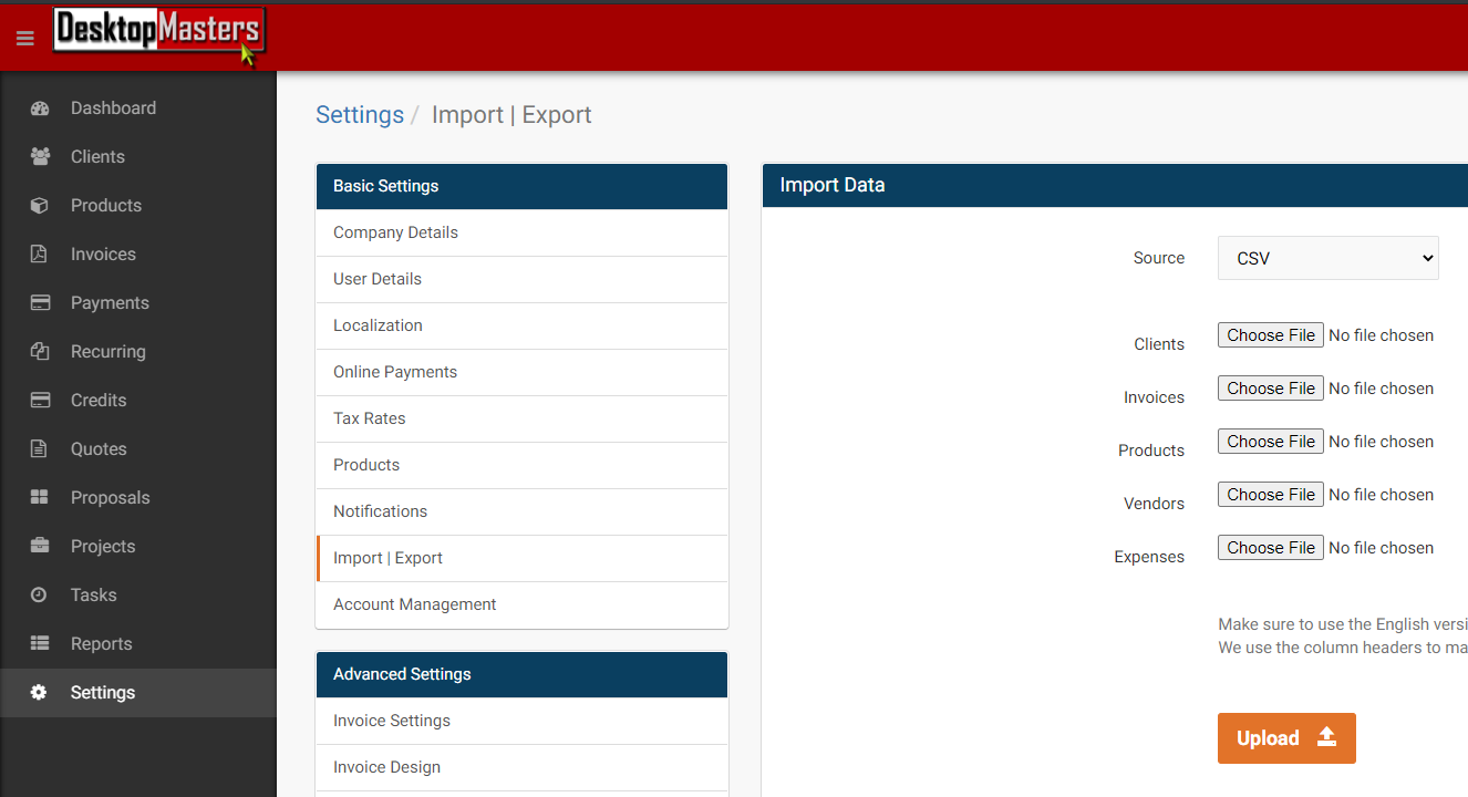

  1. I can give you the exact changes I made if you like. I changed the source so that I could have my own title bar color and logo in the admin portal. I changed the source so that the default login redirect when you go to the root url is the "Client" login and not the "Account" login. Yes there is.
