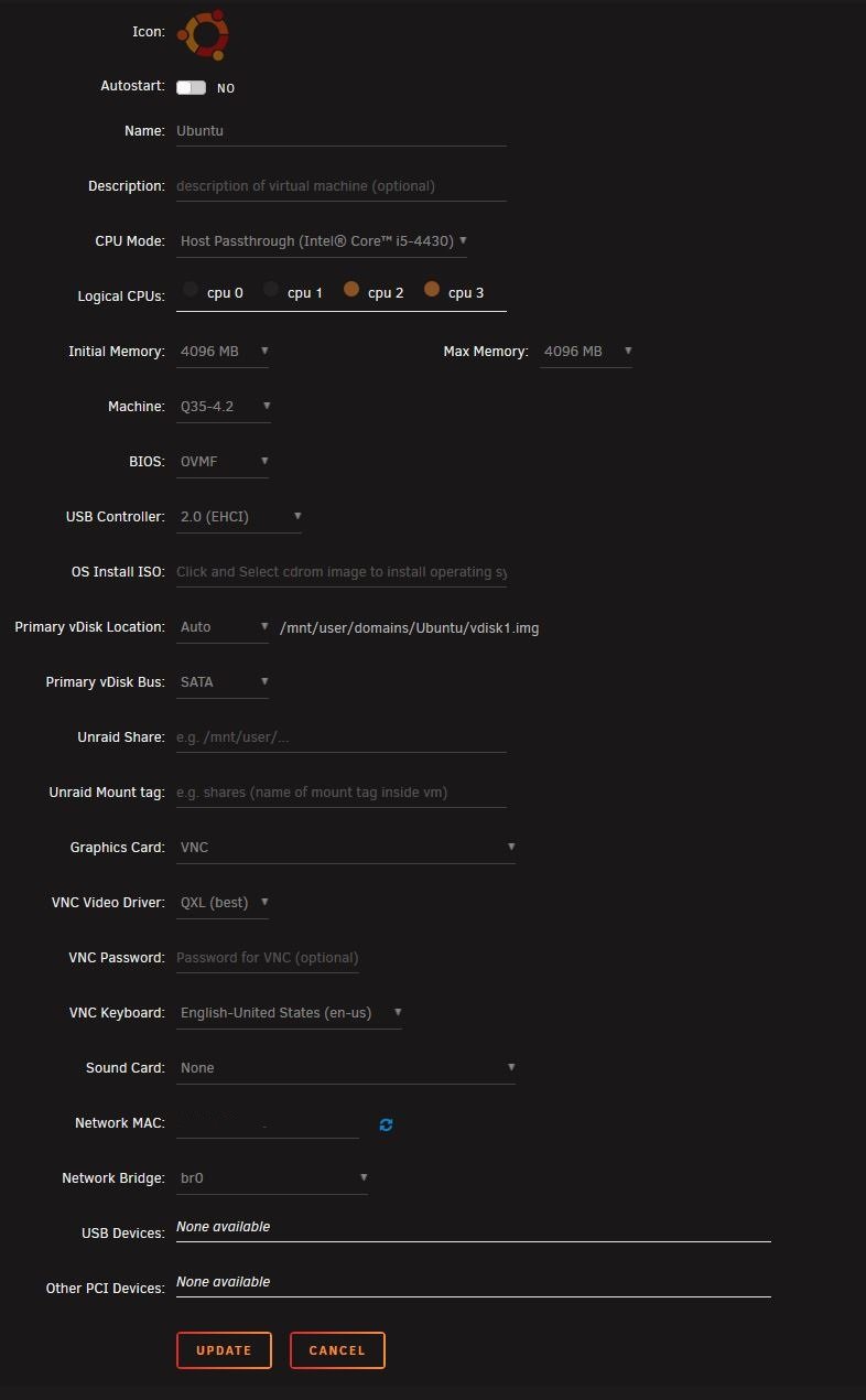

I struggled with InvoiceNinja as a docker for a while, never got it to work and so decided to run it as an Ubuntu VM. Been running smoothly for over 6 months now and I have no complaints. Followed this guide to get it up and running: https://websiteforstudents.com/install-invoice-ninja-on-ubuntu-16-04-18-04-lts-with-nginx-mariadb-and-php-7-2-fpm/
Did a little bit of customizing to get it to work with the Linuxserver letsencrypt docker, which I'd be happy to share if anyone is interested.

Hi SRB,
Since you got Invoiceninja running using that guide, I would appreciate if you could at all assist.
I have finished the guide but get the following screen when I go to the domain I placed in step 6:
In step 6, I was not quite sure what they meant by replace directory root location, however I did replace example.com www.example.com with my subdomains.
This Is the VM setup:
The VM seems to be working as it should.
I would like to get to the point where I can ask your help to get the Letsencrypt part setup (I do have Letsencrypt docker working well with some dockers but not with any VMs).
If you are able to help and need any logs etc, please tell me where to go to find the logs.
Thank you.
I managed to get it up and running on the VM, just had to change the listen port in the below settings from 80 to 443.

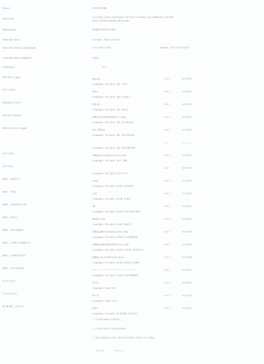

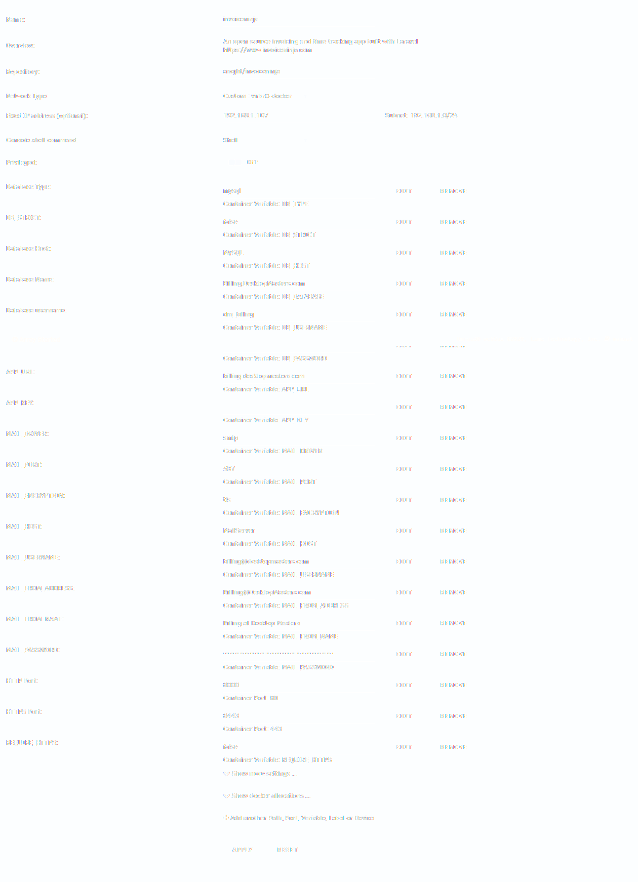

Okay, as you might imagine, I am very excited to tell you....
I GOT IT WORKING in that unraid container... Below are the (rough?) steps I followed.
Please keep in mind that I am JUST teaching myself docker and have never used invoiceninja.  I figured this out through research and massive tweaking and troubleshooting.  But that does not mean I cannot help you through your issues.  🙂
If you want to discuss this with me, or drop in and say thank you, I can be found in IRC on the FreeNode network in #DesktopMasters.  Just comment and idle and I will respond to you when I am no longer idle. (We have a pretty incredible network of techs sharing their knowledge through multiple platforms.)
or.. just leave a note here and let me/us know if it worked!!
Search apps for: invoiceninja anojht
[Install]
Configure with your network settings.
Fill in settings.
Note: On the APP_URL remove the "https://" prefix.  It can cause weird redirect loops on the forwarding if it is there.
Note: on the APP_KEY leave blank you will fill this in after.
Add Variable: REQUIRE_HTTPS
Key: REQUIRE_HTTPS
Value: false
^^ Not sure if this does anything at all.
[APPLY] settings.
In the below picture it does not show it but I later changed
port 8000 to 80
and
port 8443 to 443
(This following is the missing step)
Go into console of running container...
Run the following commands
php artisan key:generate
# ^^ remember you have to type "yes"
php artisan config:clear
php artisan config:cache
Now copy the key on your screen from the first command from between the brackets without the brackets: base64:PbmLdQrTYfcSDJSLKDALDKFFvvq/yWaGlfwiNAvjHXQ=  (The left key is an example do not use it)
Past it into the APP_KEY field you previously left blank in the settings of the container.  (replace whatever text is there now)
[APPLY]
