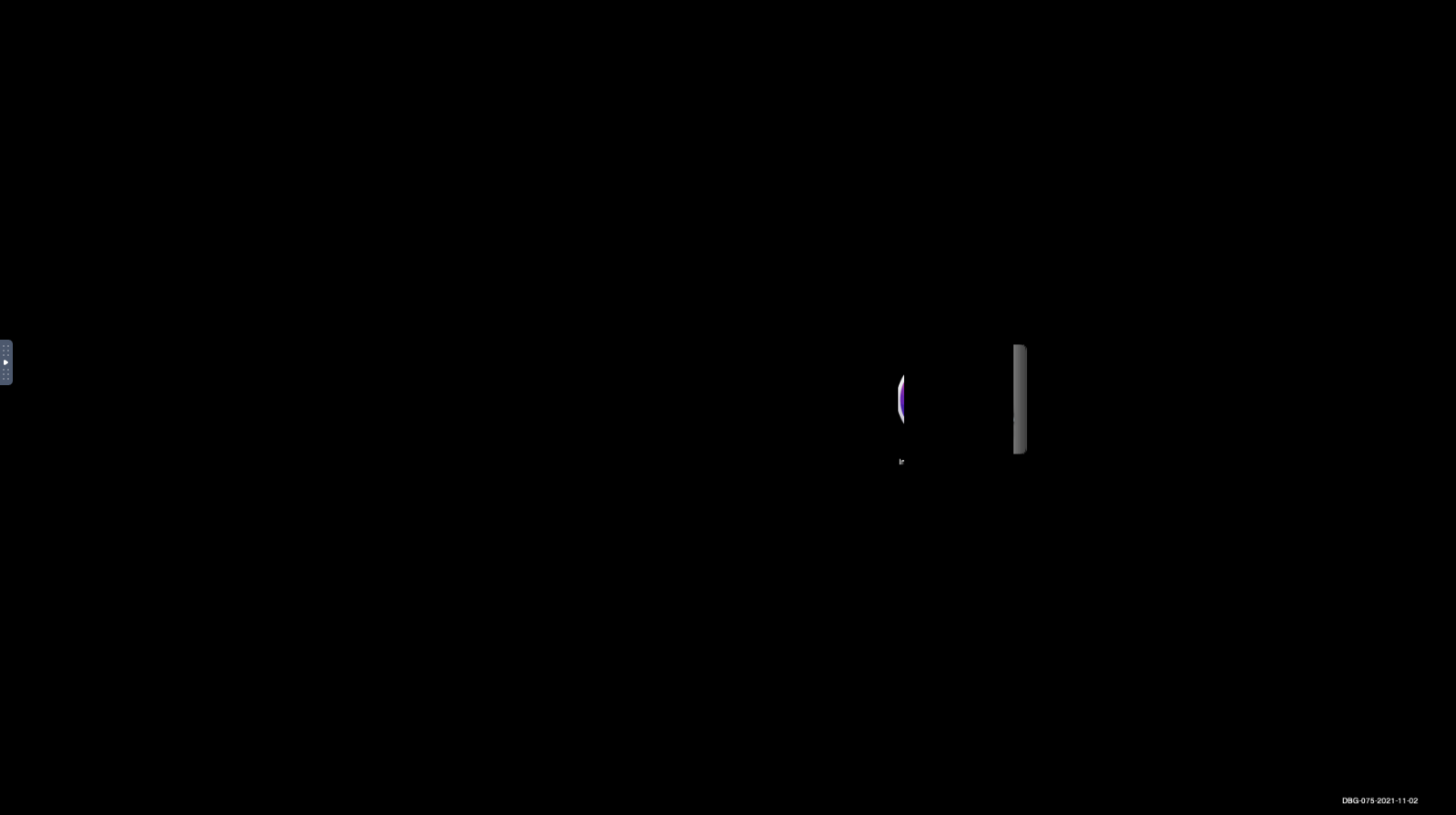

Yes to both; <graphics type='vnc' port='-1' autoport='yes' websocket='-1' listen='0.0.0.0' keymap='en-us'> <listen type='address' address='0.0.0.0'/> </graphics> If I use Max or 2560x1440 (which is the max) then I get a black screen with only the small writing in the bottom right corner. 1920x1080 with any color depth gives 1 icon as above. 1280x720 with any color depth gives more icons but the same issue when using the arrow keys. So this is a common misconception... The AMD RX550 does work in OS X OTB with one BIG caveat. You have to buy the right one! The original RX550 released in 2017 used the unsupported Lexa core but in 2018 it was rereleased with an updated and now supported Baffin core. Why AMD decided to update the chip but keep the same model number is anyone's guess. Most board partners make cards with both chips. The trick to spot the difference is the compute unit count, stream processor count, GPU and memory speed. 2017 Lexa Core - Polaris 12 (incompatible) CUs 8, 512SP, RAM 1750MHz (7000Mz effective), GPU 1183MHz 2018 Baffin Core - Polaris 11/21 (compatible) CUs 10, 640SP, RAM 1500MHz (6000Mz effective) GPU 1071MHz I did a nice post about it here with more details; -

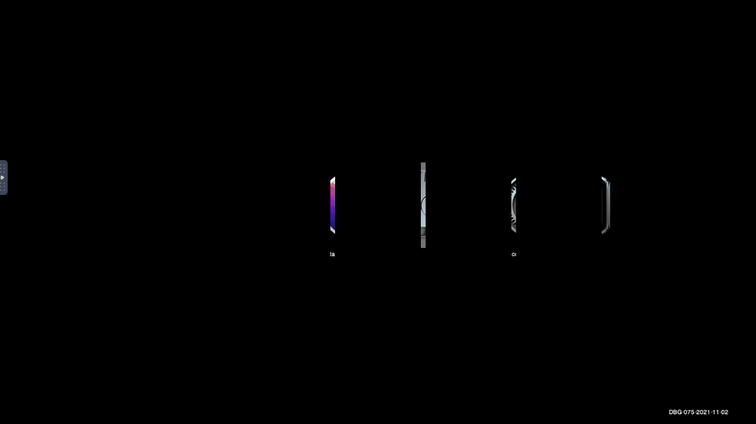

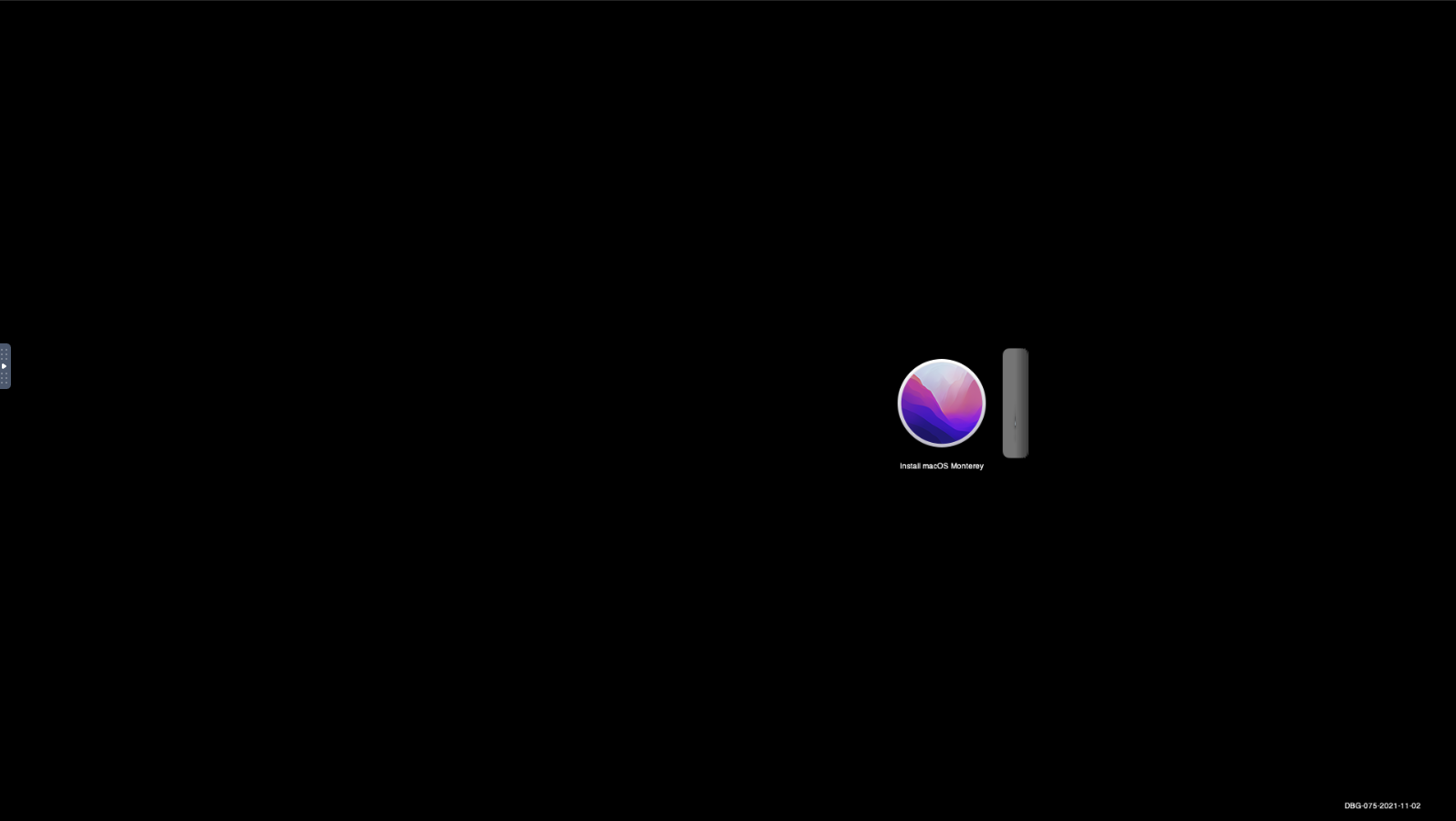

So just out of interest I re-enabled the GUI picker and it is still doing the same thing. I'm still using VNC at this stage but will move to my RX550 in the next few days. The first image is what it looks like on boot and the second shot is after hitting the arrow keys to try and choose a different boot option. My settings are; Misc -> Boot -> PickerMode: External Misc -> Boot -> PickerAttributes: 17 Misc -> Boot -> PickerVariant: Acidanthera\GoldenGate UEFI -> Output -> 1920x1080@32 Any ideas appreciated. -

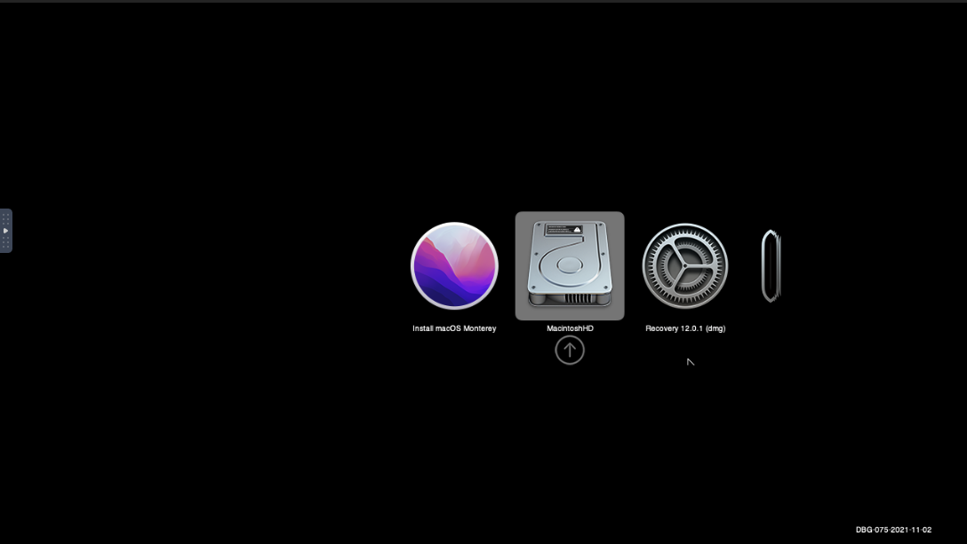

Awesome... I new I had broken something in a dumb way and just couldn't see the forest for the trees. So I built the config.plist from the template but ran it through a pre 0.7.5 version of Propertree that built the drivers section in the old format. That explains why it couldn't see the HFS+ volume which is what I thought but didn't understand why. I thought I had already run it through ocvalidate but I must be getting confused (I've been playing around with several VMs for the last few weeks). Yep, this is just from me messing around. I have never managed to get the external picker to work. I get strange graphical distortions (each icon is huge) that make it impossible to use. It hasn't annoyed me enough to look at again since OC 0.5.x but I have always left it there for the day I have some spare time. Now I am going to rearrange my PCIe bus config which I have been meaning to do for 2 years. Then I can add my GPU, USB and NVME drives. I just have to go and refresh my memory as per your post... Thanks again @ghost82 -
** Hackintosh ** Tips to make a bare metal MacOS
cat2devnull replied to Leoyzen's topic in VM Engine (KVM)
Ok, so I'm running out of ideas so hoping the community can help. I've been running a Mac VM for years on my AMD system. Originally on Clover native, then switched to OpenCore in Unraid. It's been relatively smooth sailing excluding the odd AMD GPU bug etc. OpenCore and OS X upgrades have been straight forward. A few days ago I wanted to go to OC 0.7.5 and trial Monterey, (currently on 0.7.1 with BigSur). I decided to build a fresh VM to test with before migrating my production desktop. I downloaded the Monterey installer, made a 16GB GPD HFS+ .dmg, used createinstallmedia to make the install media. Followed the OC install guide to make my EFI folder and put that into the .dmg. Renamed it to a .img and fired it up. OC boots but no option for install media, just reset NVRAM and OpenShell.efi I've tried setting ScanPolicy to 0, changing SecureBootModel from Default to Disabled and a myriad of other bits and pieces but nothing makes a difference. I can only assume I am missing something silly... I am only running the basic latest drivers (OpenCanopy.efi, OpenHfsPlus.efi, OpenRuntime.efi) and kexts (AppleALC, IntelMausi, Lilu, VirtualSMC, WhateverGreen). A pretty simple setup. I've attached the OC logs, which seem to show it finding 2 valid filesystems. This boot I pulled the EFI partition into a separate .img file so I could mount/unmount easily. I think it should have found 3 filesystems. 1) EFI-075.img - EFI partition 2) Monterey.img - EFI partition 3) Monterey.img - HFS+ install media partition I wonder if it is ignoring HFS+ partitions??? If anyone has any thoughts it would be greatly appreciated. config.txt VM.xml opencore-2021-11-19-090547.txt -

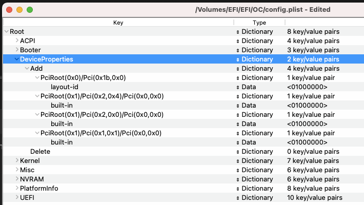

Actually there are 20 items in that plist file as you can see in the "value" column. You just need to click on the "> Add" to get it to expand. But I am not sure why you are editing the pcidevices.plist file. You need to add the built-in settings to your config.plist in your EFI disk/partition. If you look at my earlier post, you can see I am editing /Volumes/EFI/EFI/OC/config.plist Also I noticed that you are still using the VMX ethernet driver. This should have been updated to be the intel e1000 driver when you ran the Macinabox helper script. I believe that you need to be using the intel virtual NIC to avoid issues with iServices. You can check your virtual machines XML configuration in Unraid and make sure the NIC model is set to e1000-82545em as per my example below. You may also just be able to run the the helper script again to fix it. Just make sure you updated the FIRSTINSTALL variable to "no". Spacinvader One talks about this here; https://www.youtube.com/watch?v=7OunFLG84Qs&t=840s <interface type='bridge'> <mac address='60:03:08:aa:bb:cc'/> <source bridge='br0'/> <target dev='vnet0'/> <model type='e1000-82545em'/> <alias name='net0'/> <address type='pci' domain='0x0000' bus='0x01' slot='0x00' function='0x0'/> </interface> -
