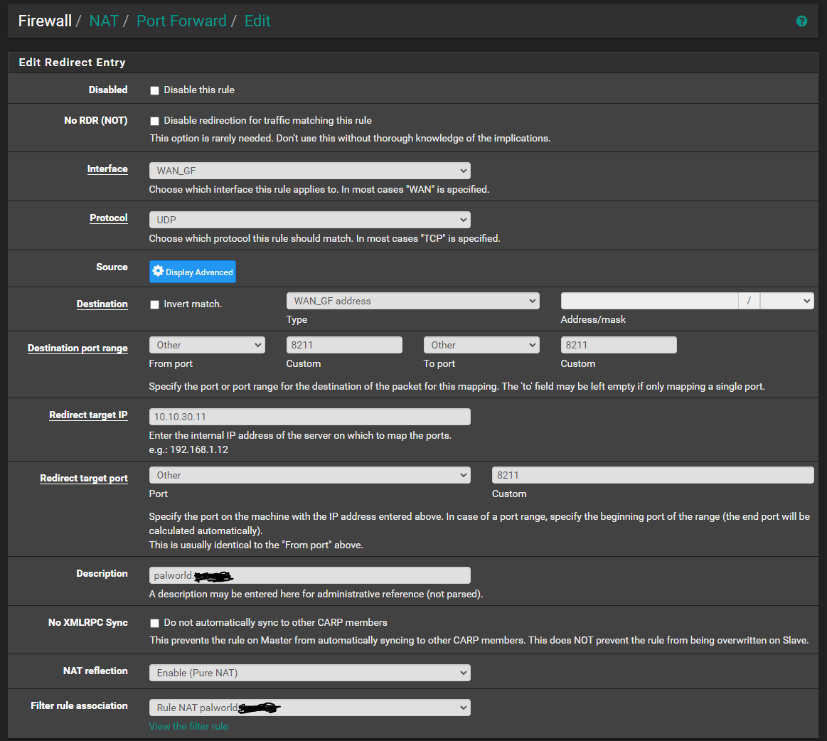

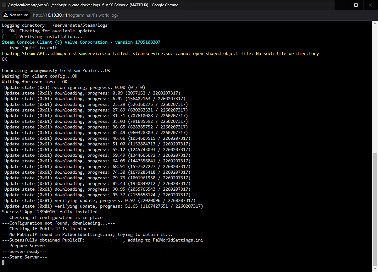

  2. tried just about everything i can think of to get palworld server to work. can connect just fine locally but no chance over the internet (just says connection timed out). all ports are forwarded same as other game servers i've set up. only thing i've changed to the docker config is the rcon port (25575 is used by minecraft) and the folders for steamcmd and server files (to an ssd i have mounted using unassigned devices at /mnt/disks/.) port 8211 is port forwarded UDP in my pfsense router. google fiber doesn't block ports. i do have a domain setup but testing using public ip just to rule that out with no change. domain also pings to my public ip anyways. anyone have any ideas here?
