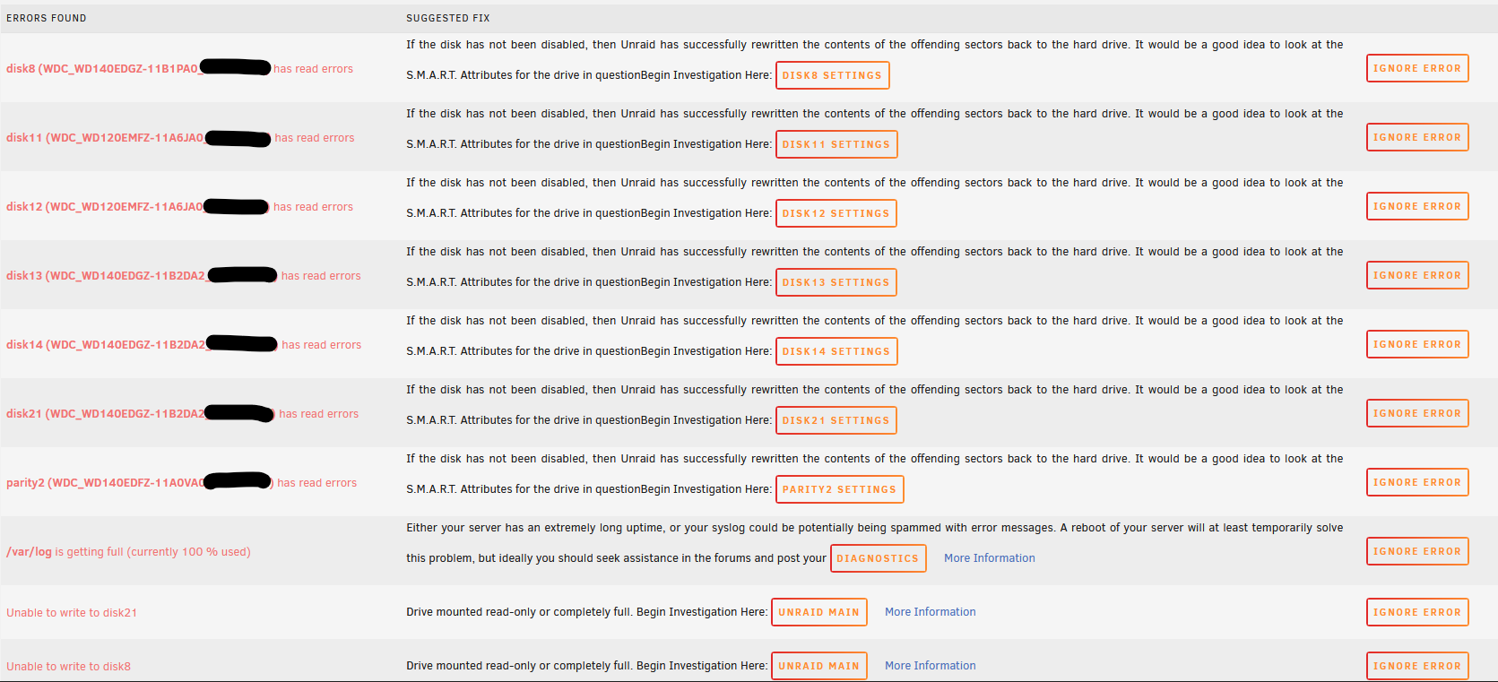

  6. Hello, I recently added two 20TB drives to my array to server as parity. I replaced the existing 2 x 14 TB parity drives. I replaced one by one. No problems after both new parity drives were upgraded. I added one 14TB drive (former parity) to the data array and no issues for about three days. I precleared the second unassigned 14TB parity drive. I added to the data array within the past 24 hours. I noticed when trying to update some missing media that some of my media folders were missing from the shares. I checked drive health and all are fine but eight are showing read errors. When I check the disk logs on one of the drives with errors I see the following: I see the same "Synchronize Cache[10] failed" error on the eight drives with errors. Only this one drive shows I/O errors. I thought I may have over-passed the 30 drive limit but believe I should be fine. 2 x parity 24 x array 2 x cache pool 1 x usb = 29 drives I have a main case and a DAS. I don't believe this is a hardware issue related to that. I haven't stopped the array yet but did stop running dockers. Can someone please help me review? Attaching diagnostics logs. Thanks tower-diagnostics-20250202-1437.zip

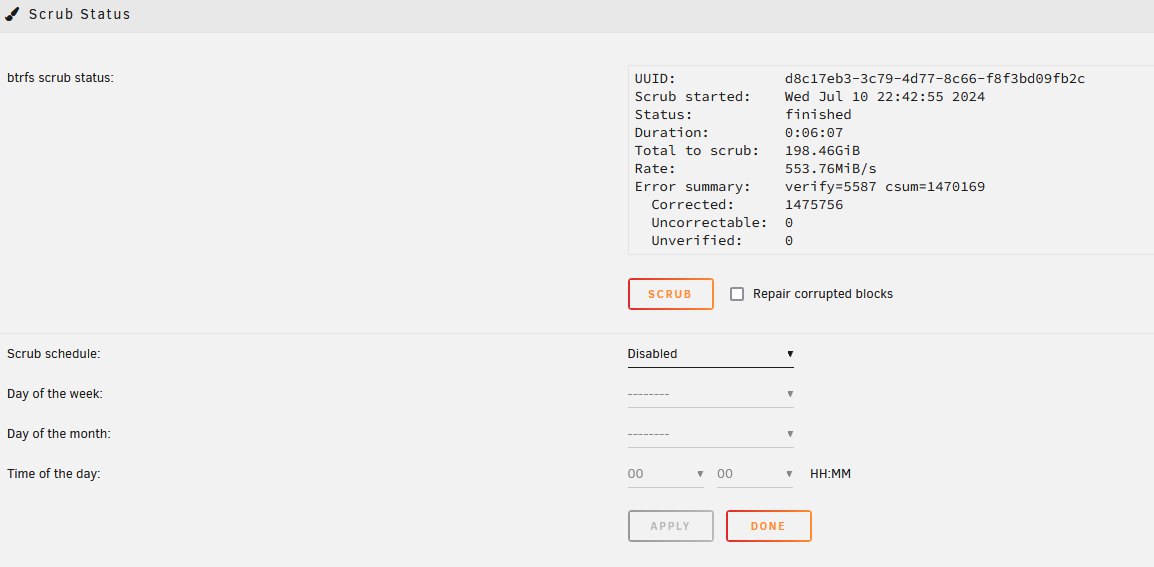

  7. My system has been working fine since repairing the scrub. I've been able to add media to my shares and use some dockers without issue. I will continue to monitor and will look into incorporating the pool monitoring. Thank you!
  8. I started the array and ran the scrub on the pool and it repaired corrupted blocks. The system is running a parity check and corrected some sync errors. I'll let it finish then will test my system again and follow-up here. Thanks,

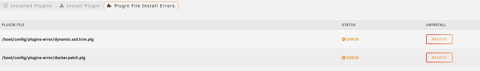

  9. Thanks for the quick reply. A couple of questions. Should I start the array and if so do I do it in maintenance mode? A parity check is currently set to start because I did not shut down properly. I disabled the Dynamix Trim plugin and now see it listed in the Plugin File Install Errors. Can I run the scrub from the terminal per the instructions here? https://docs.unraid.net/unraid-os/manual/storage-management/#scrub btrfs check --readonly /dev/sdX1 btrfs check --repair /dev/sdX1 Thanks again

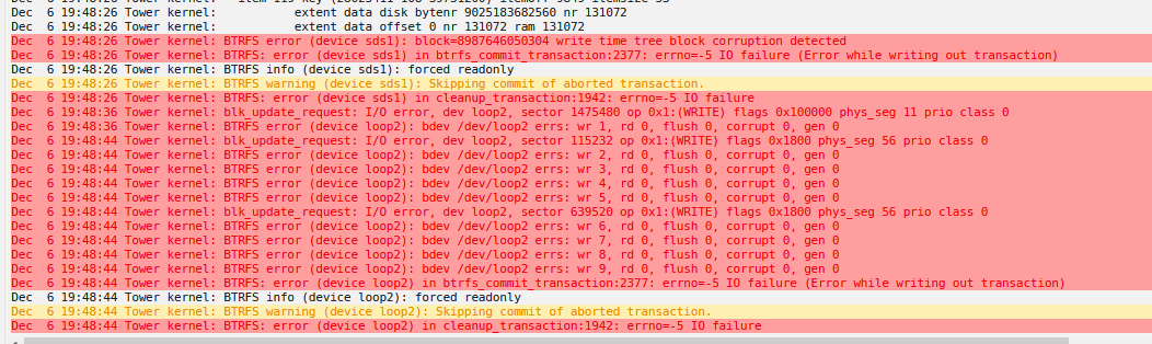

  10. Hello, I recently ran into issues with my 10 year old Unraid server after updating the OS. Current Version: 6.12.6 Previous Version: 6.11.5 I had many issues after the update, most notably seeing lots of BTRFS errors in the logs on my two SSD drives in my pool, with some entries referencing some drives in my array. I did some research online and saw some posts mentioning faulty RAM or loose SATA cables. Multiple times I powered down my system and made sure all cables were securely plugged in, both SATA and power. I have an internal and external SAS card running to a second case with more drives. Everything was connected properly. My system would work for a couple hours after turning back on before the BTRFS errors returned. When this happened some of my media shares would go offline while some would stay online. Sample of some errors I saw during this time. I decided to replace my i7-2600K/ASUS MB system with a i7-12700K/MSI bundle from Microcenter. I swapped in the new hardware, CPU, MB, RAM, PSU and put in my SAS cards. I had some issues with getting the flash drive to Boot but some old forum entries helped me fix that. I booted up the system and all the drives were detected. I started the array and launched Plex and started streaming some items to test. Things worked for 15-20 minutes before my stream froze. I checked Unraid logs and saw more BRTFS errors referencing the two SSD drives in my pool. The GUI became unresponsive and I had to forcibly shut down my system. I had to cycle the power a couple of times for Unraid to boot. My array wants to run a Parity check but I'm anxious to do so as I'm afraid I may get more errors during the process as my array is pretty large. I'm posting logs before (2024/07/04) and after (2024/07/09) I replaced the internal hardware to show the logs. My two SSDs are different brands but the same size. I am planning to swap those out for NVME drives since my new MB has multiple onboard slots to accommodate. I appreciate some help reviewing my diagnostics and helping me pinpoint the issues. Thanks tower-diagnostics-20240704-1118.zip tower-diagnostics-20240709-0138.zip

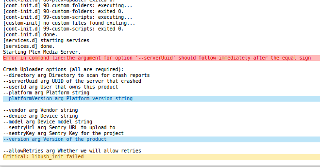

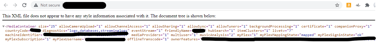

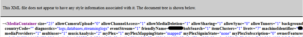

  11. I deleted the appdata folder and restarted my server. I reinstalled the plex docker and set all media paths (I appended a V2 to the plex path make sure no old data was being used) When trying to launch I still get the XML error. Docker logs after launch. Looking at other posts on this forum for similar issues I found a suggestion to add '/manage' to the end of the plex docker URL to gain access. My URL looks like this: http://x.x.x.x:32400/manage and it did load. I was then able to create the Plex instance/server name and it's started adding libraries. I could access my media that has been scanned so far from a client system via a test stream. I then tried to relaunch the Plex docker and after going through the initial setup/configuration it did load. No tricks needed. Thought I was almost done. I was in the Plex GUI, not Unraid, and set transcode to use RAM in settings. Another step closer to being finished... When I was streaming from my backup Plex instance I noticed the new server shares showed offline. The Plex Server was offline. I checked logs and see BTRFS serrors. I tried to restart the docker and it failed. This is the message I got. Looking at other similar posts on the forum seems to indicate bad memory. I will attempt to run a memtest to see the results. Attaching latest diagnostics after running into these last issues. Thanks tower-diagnostics-20211206-2023.zip

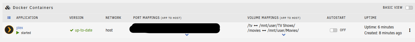

  12. It appears that my Plex instance on Unraid is running. I simply cannot reach the WebUI directly from the docker page. I have an older system with another Plex instance that I booted up. I saw my Plex shares available on my Unraid system and am able to view the media. I tried to launch from a different browser on the same system and received the following message: When I view the docker logs this is what I see? Is this more a docker-provider issues versus Unraid? If so I can go that path. Thanks

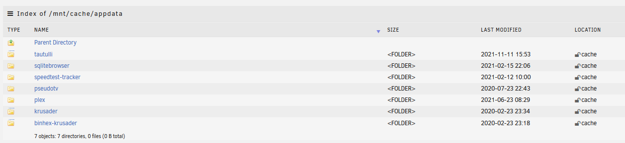

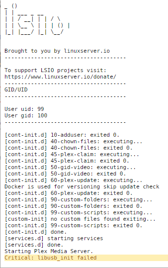

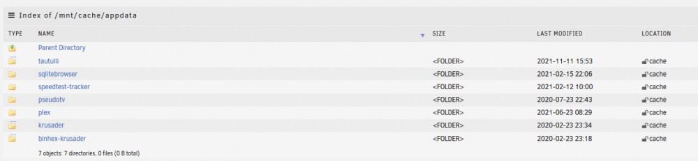

  13. Instead of using the Previous Apps feature I reinstalled the same linuxserver Plex docker from the Apps page. I had it point to my media shares. Installation is fine and the docker is started per the GUI. When I go to launch the docker it is unable to connect. I then checked the cache appdata folder and see a Plex folder there with an older timestamp. Do I need to remove this old plex folder from the cache drive then try to reinstall? If so is Krusader a viable option to do so via GUI? Attaching latest diagnostics. tower-diagnostics-20211203-1007.zip Thanks,

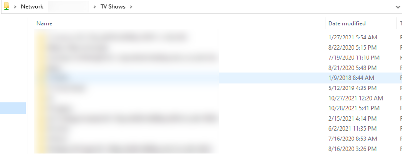

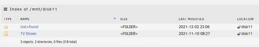

  14. I ran the xfs_repair command sans arguments and it completed quickly. ***** Check Filesystem Status xfs_repair status: Phase 1 - find and verify superblock... Phase 2 - using internal log - zero log... - scan filesystem freespace and inode maps... Metadata CRC error detected at 0x43cfad, xfs_bnobt block 0x2ffffffd8/0x1000 btree block 6/1 is suspect, error -74 bad magic # 0 in btbno block 6/1 Metadata CRC error detected at 0x43cfad, xfs_bnobt block 0x27fffffe0/0x1000 btree block 5/1 is suspect, error -74 bad magic # 0 in btbno block 5/1 . . . resetting inode 7018382593 nlinks from 14 to 8 resetting inode 72238548 nlinks from 6 to 4 resetting inode 7018382623 nlinks from 17 to 11 resetting inode 72238576 nlinks from 11 to 6 done ***** After running the command I received the message that Disk 11 has returned to normal utilization level. Disk 11 now shows more free data than before but I can view folders and files there. There is a lost+found folder now but I can view files under the TV Shows folder. I confirmed in Windows that I can now view files in the TV Shows share. I have plenty of content in the lost+found directory but no big worries. I have the original drives I replaced and may try to recover some data from them. I don't have any dockers installed even though I can see the folders and files in my cache drive at /mnt/cache/appdata I will proceed to reinstall those. I'm attaching the latest diagnostics logs for reference. Thanks all for your help. I really appreciate it. tower-diagnostics-20211202-2310.zip

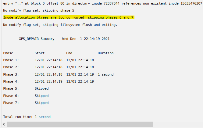

  15. I ran the xfs_repair -nv command from the webGui and this is the results. Diagnostics are attached. tower-diagnostics-20211201-2222.zip Per this article running xfs_repair without the -n argument was suggested and worked. Should this be my next step?
