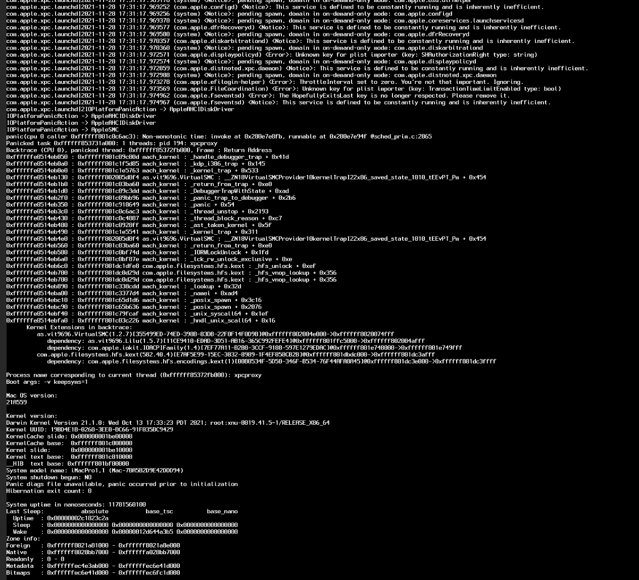

  4. I have Ryzen 9 5900X and Asus tuf gaming wifi x570 I have tried a lot of things but I always get the panic loop launching the recovery or installer. I even created a bootable usb stick from my other hackintosh and I get the same problem. I always get this problem with the default created xml VM without any changes. Any changes I make after that won't solve the problem even after running the helper script. I tried following exactly the video tutorial and I get the panic loop. I tried replacing opencore with the one from this pull request but I got the panic loop. https://github.com/SpaceinvaderOne/Macinabox/pull/49 I tried the new unraid.sh from the same pull request but got the same problem. I tried the way mentioned in the post below but I got the same problem when I launched the recovery disk. I managed to grab a screenshot before the panic, posted below. edit —— i am using unraid 6.10 rc2 which might be the problem Thank you for advance.
  5. setting scanpolicy to 0 fixed the problem.
