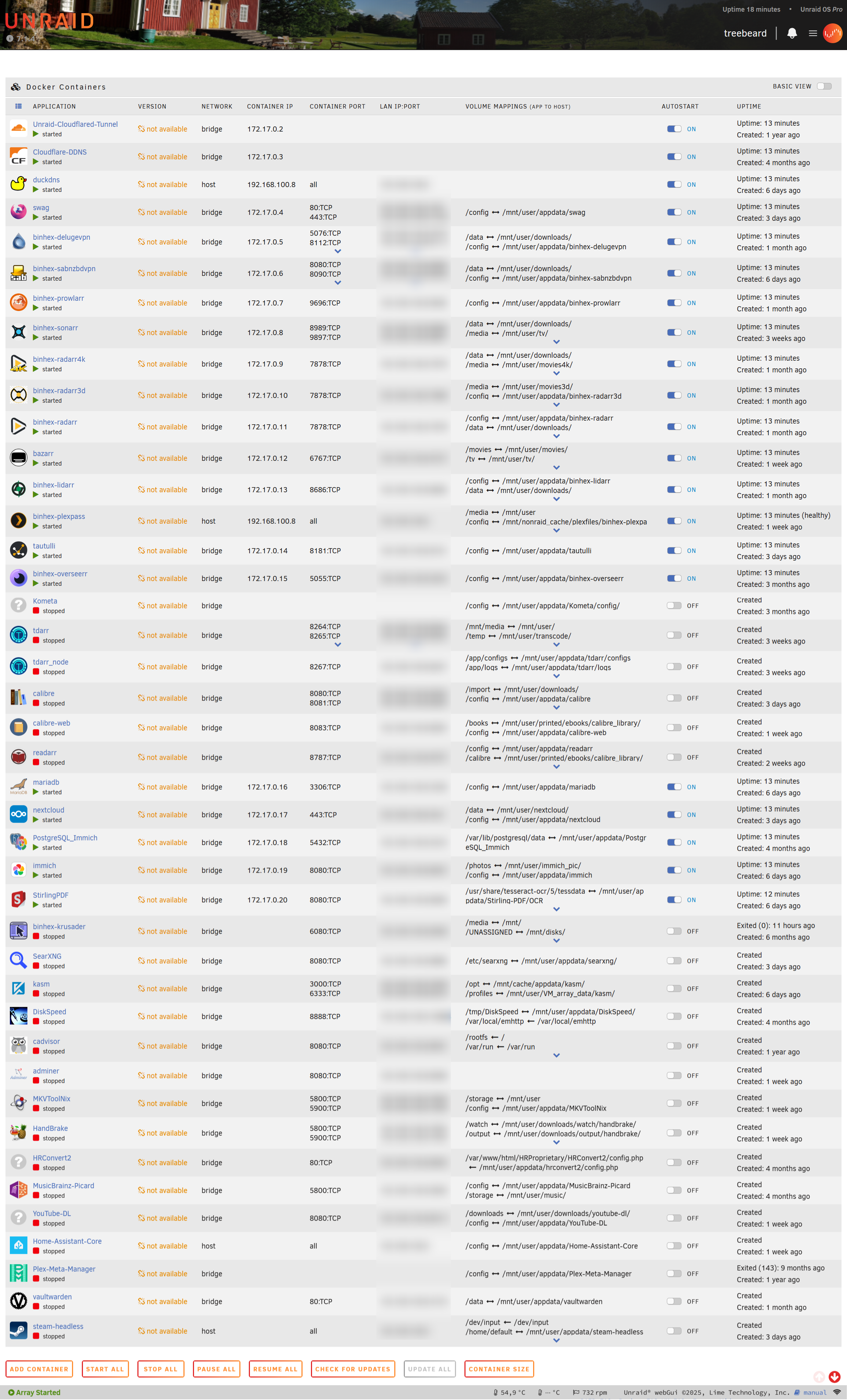

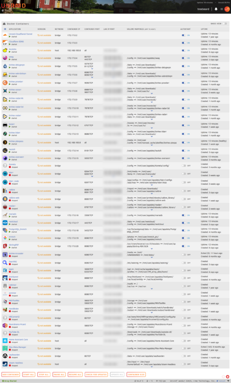

  2. I had an internet access problem, and the Unraid server was behind double NAT for two days. After I corrected this problem (back to singel NAT), all dockers now show version "not available". I'm not sure this caused the problem, but I'm shure I didn't have this problem before the problem with my access router. I saw another user with he same problem that was asked to check time (mine is ok) and configuring static DNS server (no change). I have attached my diagnostics - any ideas? treebeard-diagnostics-20250717-0006.zip

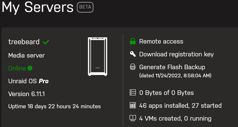

  6. Thanks for caring. I never found out what the problem was and started to set the clock manually. I know, it's not good enough, but there are only so much risks you are willing to take with remote (like four country borders away remote) systems. Anyways, checking now and it seems that somewhere between 6.9.2 and 6.10.5 this fixed itself. It's working now. Could have been a corrupt config file that @John_M mentioned that is now overwritten... Thanks for adding you five cents
  7. Did restart normally, but didn't do any difference for unraid GUI access Yes, that did start the reboot command, but I lost the prompt and all services seemed to be still open. I could see the disk-activity lamp plinking through the PiKVM interface I waited an hour and no difference: ...so used ssh in and did another reboot which did reboot the server, but triggered the parity-check 😐 After this I did manage to get the GUI, but not through the https://www.xxxxxxxxxxxxxxxxxxxxxxxxxx.unraid.net:<port> I had to go through http://<WAN IP>:<port>/ Now I upgraded to 6.11.5 which went well, but still the behavior from above. I changed to the new myunraid certificate and that helped. Now I could get the GUI from my servers page. Still couldn't get VPN access through my WireGuard tunnels, but after a while I realized I had to update the the tunnels after the URL changed. Yes, I do. I'm reading up on this and will m a y b e change it. Need to breathe first a couple of days. My old man heart is not built for remote updates It was the latest. Got uppdated automagically somewhere along the way. Thank you for the quick help and have a nice weekend.

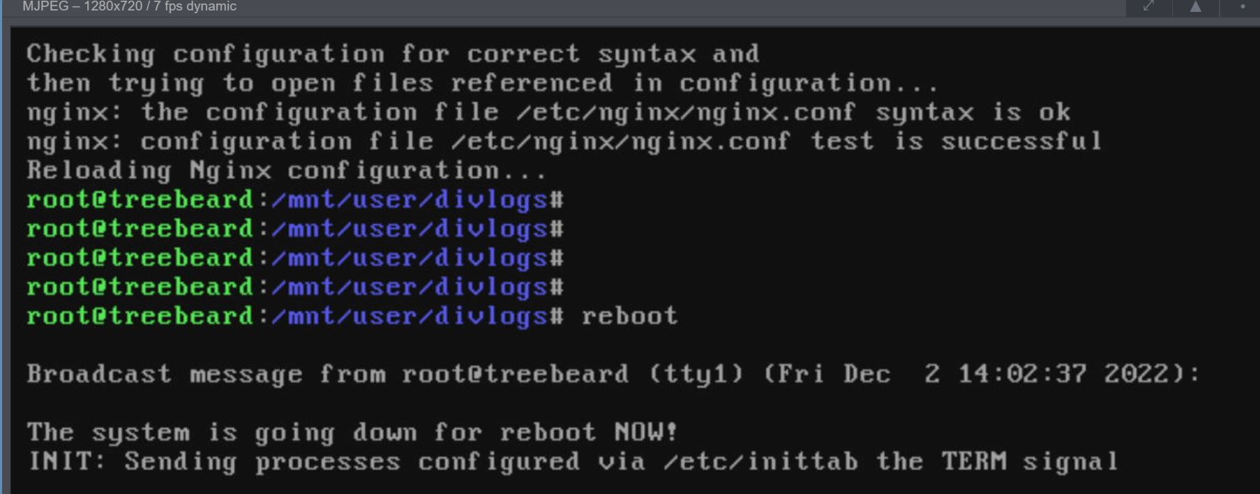

  10. I can no longer reach my servers Unraid GUI. It worked just fine a couple of days ago. If I click [Remote access] I'm directed to the URL https://www.xxxxxxxxxxxxxxxxxxxxxxxxxx.unraid.net:<port>/Dashboardwhere I get a 500 Internal server error from nginx I have a wireguard tunnel active from where I can remotly reach the GUI of active containers via this URL format http://<server LAN IP>:<port>/ I can also reach services like SMB via the wireguard tunnel, but not the Unraid GUI like I could before via https://<server LAN IP>/DashboardI get the same 500 Internal server error from nginx What can be wrong? I do at the moment have access to a shell via a connected PiKVM, but do not want to do an unessasary restart and what to find the root of the problem. The server is geografically located in another country and I'm terrified to do something stupid.

  12. Back up again thanks to reboot via PiKVM (prais be it's name). Waiting for 6.11.2 before I touch anything more with network involved. VPN was now able to start without any changes to the config file. Marking the issue as solved
