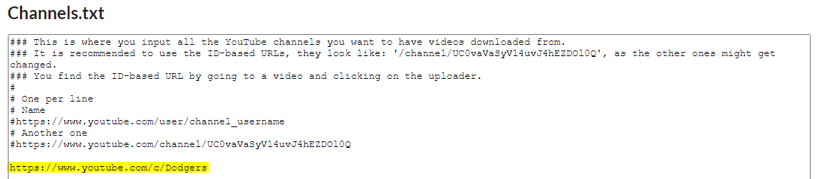

I am hoping to give this a try but I wanted to confirm I have this setup correctly. The instructions are a okay but not really clear. In my channels.txt list I have the following
I hope this is correct. I just want videos from a single channel.

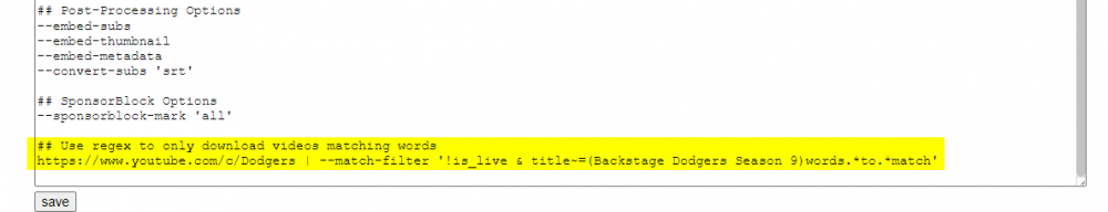

And in the Args.conf I left everything alone and added the last line ... is the correct way to do it? I ONLY want to download the new season of Backstage Dodgers and not all the other seasons.
Let me know if I am missing something or if I did this wrong. :)
Bueller? Bueller? Bueller? 😁
