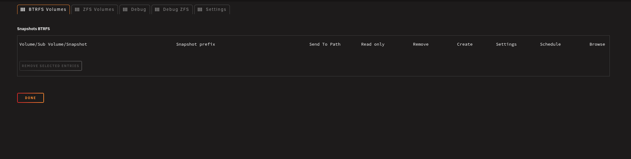

  2. Am I the only one for whom the interface for Snapshots does not work at all in Unraid 7.2.3 ? I can't see the usual options, everything is empty.
