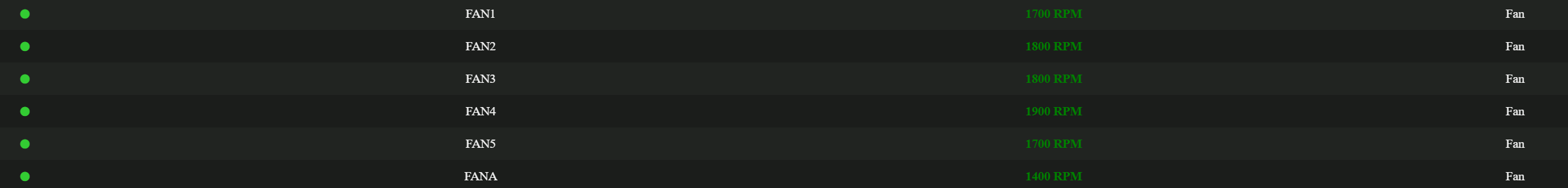

  7. When the following was logged,... 2025-04-11 08:23:59 Fan:Temp, FAN1234( 2%):HDD Temp(Spundown), FANA( 2%):CPU Temp(28C) ...my drives were all spundown (as indicated). And yet, the fans cooling them were spinning pretty fast (not 2%) with sensor readings of 1700 RPM.
  8. What is weird is that even though it says the fans are spun down, these are the actual sensor readings.

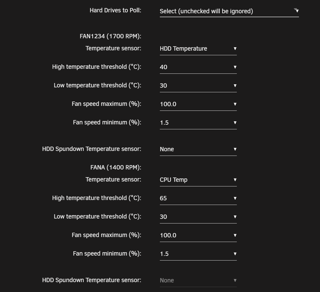

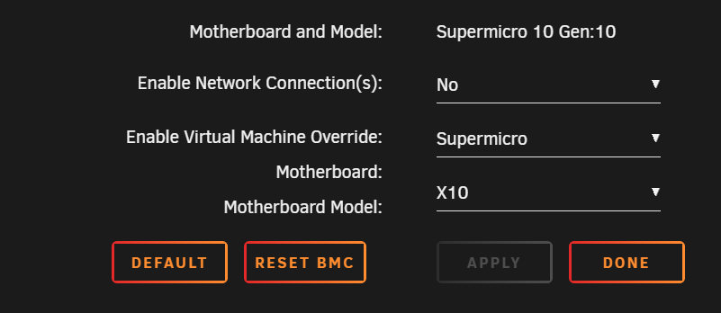

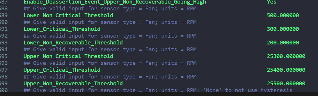

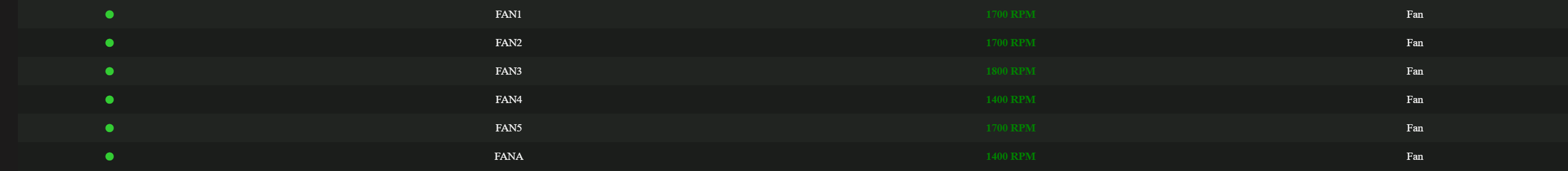

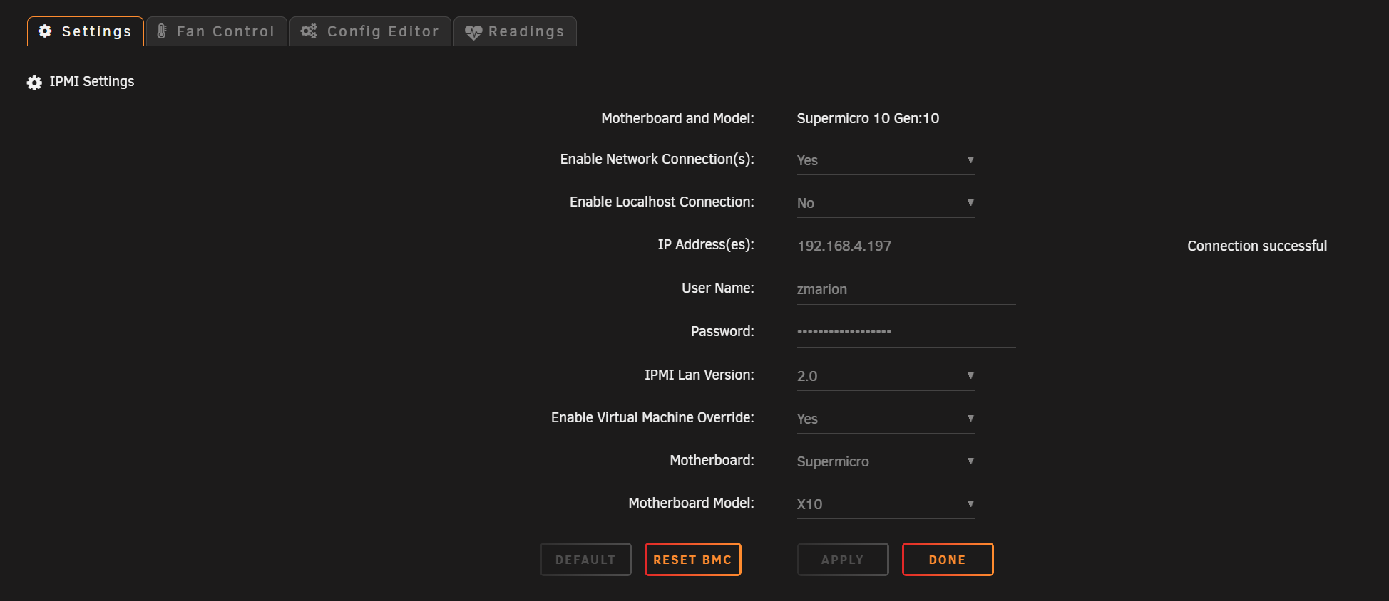

  10. Do these screenshots help, @SimonF and @JorgeB?

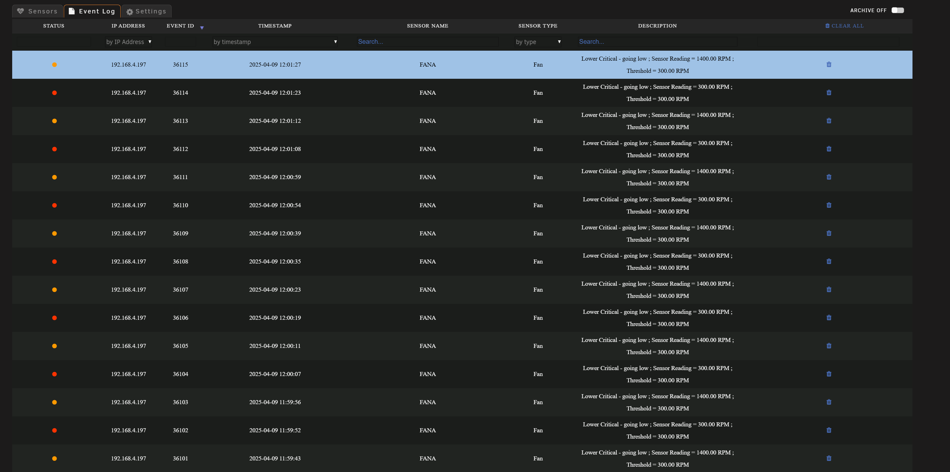

  11. After removing the network connection, the Fan Settings section under Fan Control returned. However, I am not able (or cannot figure out) how to disable the Virtual Machine Override. For now, I have it set to Supermicro X10 as my board is an X10SRI-F. As I'm sure you're aware, I had to set Fan Control to No to be able to remove the network connection. Before I set Fan Control back to Yes, All of the fans would spin down and then up continuously. This behavior stopped after I set Fan Control to Yes. With Fan Control set to Yes, all of the fans' speeds seem to be pinned. FANA cools my CPU and FAN1-5 cool my HDD array drives. Here's what that looks like on the Sensors page. Here are my Fan Settings. Here are the sensor settings for all my fans. Section 1009_FAN1 ## Possible values: Yes/No Enable_All_Event_Messages Yes ## Possible values: Yes/No Enable_Scanning_On_This_Sensor Yes ## Possible values: Yes/No Enable_Assertion_Event_Lower_Critical_Going_Low Yes ## Possible values: Yes/No Enable_Assertion_Event_Lower_Non_Recoverable_Going_Low Yes ## Possible values: Yes/No Enable_Assertion_Event_Upper_Critical_Going_High Yes ## Possible values: Yes/No Enable_Assertion_Event_Upper_Non_Recoverable_Going_High Yes ## Possible values: Yes/No Enable_Deassertion_Event_Lower_Critical_Going_Low Yes ## Possible values: Yes/No Enable_Deassertion_Event_Lower_Non_Recoverable_Going_Low Yes ## Possible values: Yes/No Enable_Deassertion_Event_Upper_Critical_Going_High Yes ## Possible values: Yes/No Enable_Deassertion_Event_Upper_Non_Recoverable_Going_High Yes ## Give valid input for sensor type = Fan; units = RPM Lower_Non_Critical_Threshold 500.000000 ## Give valid input for sensor type = Fan; units = RPM Lower_Critical_Threshold 300.000000 ## Give valid input for sensor type = Fan; units = RPM Lower_Non_Recoverable_Threshold 200.000000 ## Give valid input for sensor type = Fan; units = RPM Upper_Non_Critical_Threshold 25300.000000 ## Give valid input for sensor type = Fan; units = RPM Upper_Critical_Threshold 25400.000000 ## Give valid input for sensor type = Fan; units = RPM Upper_Non_Recoverable_Threshold 25500.000000 ## Give valid input for sensor type = Fan; units = RPM; 'None' to not use hysteresis Positive_Going_Threshold_Hysteresis None ## Give valid input for sensor type = Fan; units = RPM; 'None' to not use hysteresis Negative_Going_Threshold_Hysteresis None EndSection Ideally, I'd like the fans cooling my hard drives to turn off when the drives are spun down or below 30 degrees.

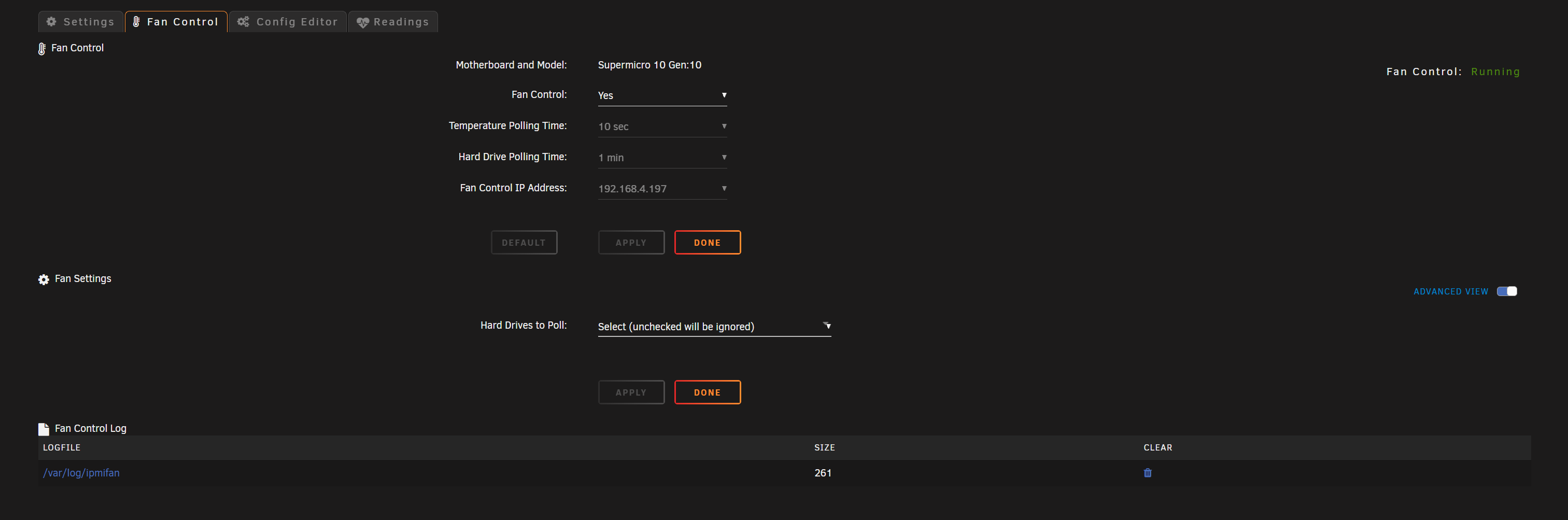

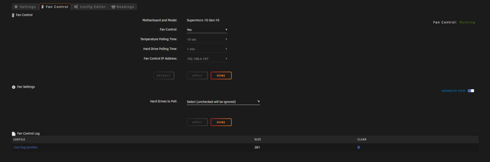

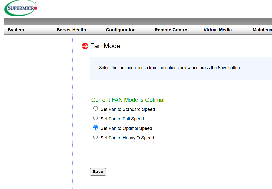

  12. Not to pile on... but this is also happening: I know there is much discussion about the Noctua fans. Is the fix to alter these settings?
  13. Just the Fan Settings section is blank. Advanced is enabled. IPMI fan mode set to optimal, but I've also tried standard and full.
