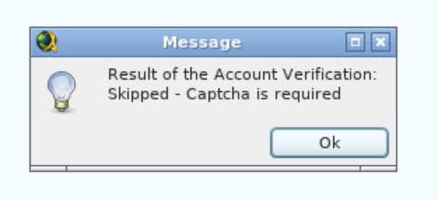

How can I add my nitroflare account, I get this message: EDIT: Nevermind, I just realized I can set up accounts on my.jdownloader.org aswell
