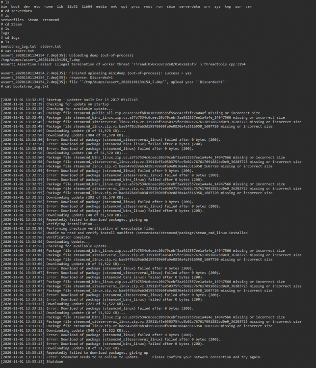

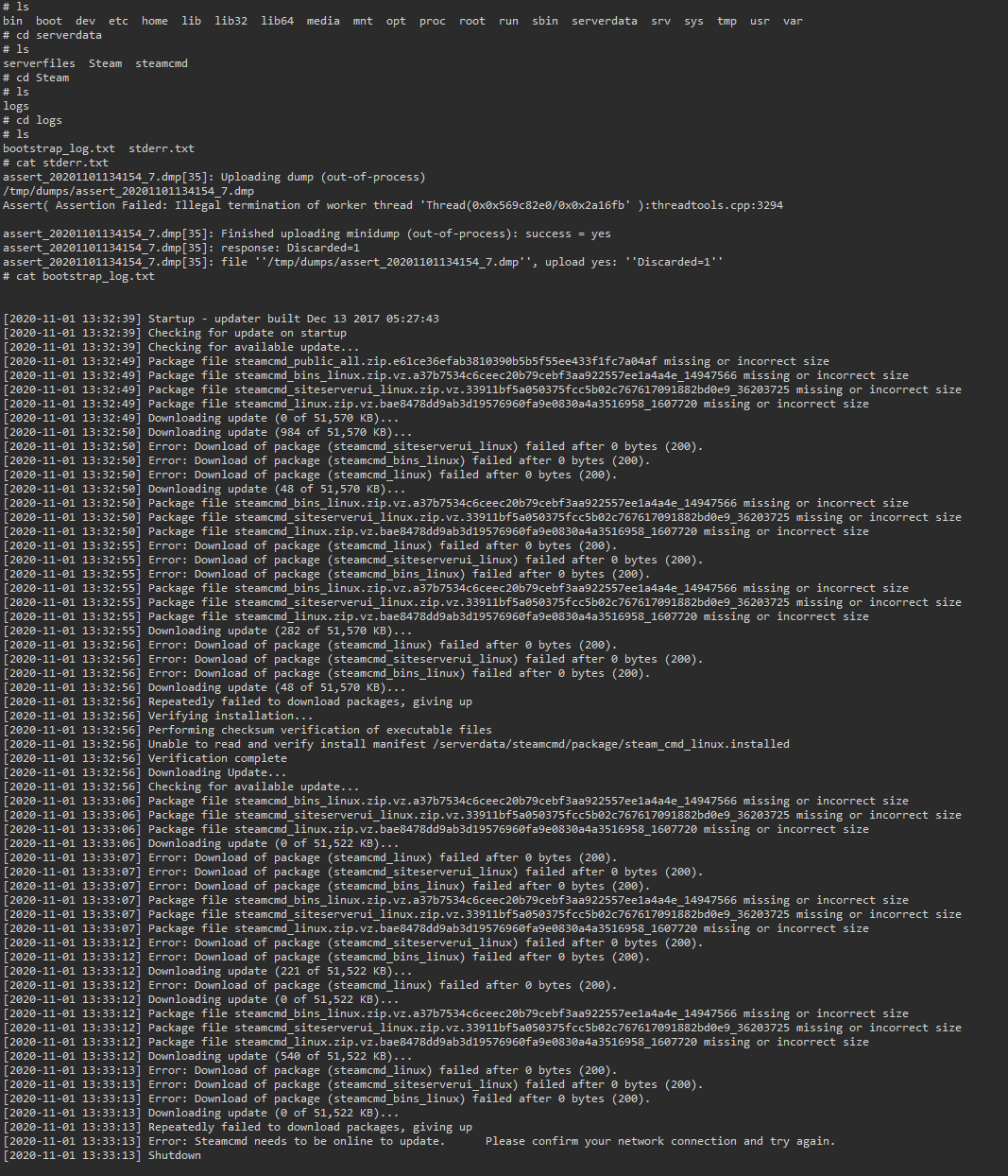

  4. I don't know why it couldn't update steamcmd. but I've got a work around. If anyone else is having this problem you can try this: - Build an Ubuntu VM. (Or your preferred linux distro) - Install steamcmd manually using the instructions found here (I did the 'manual' method) - https://developer.valvesoftware.com/wiki/SteamCMD - Run ./steamcmd.sh and it should update. - Copy the contents of the "Steam" directory from the VM to your appdata/steamcmd directory. - Install the game docker container. - Delete the Ubuntu VM. Not sure what the deal is with steamcmd not updating from the docker container (I can install and update it from a linux box and even the windows version), but at least this seems to be working and since steamcmd is only needed once it should be okay for other containers right?
  5. Yeah I have installed this container several times with and without my steam credentials... Nothing. Is there a way I an try to manually download steamcmd via wget or something? My cache drive is formatted btrfs is that a problem?
  6. I do have PiHole running on my network, but I have disabled it and get the same error. I also disabled my router GeoIP filtering to make sure that wasn't causing the problem. Here is what I see in the serverdata folder
  7. Hi all I am struggling to get the DontStarveTogether container to run successfully. This is the first game server I have tried to host from my Unraid box. I own the game on Steam, I've included my Steam username and password in the docker install template. I've setup port forwarding for all 3 ports (10890, 27016, 8766) on my router to my unraid box and I generated and updated the token file, but keep getting errors in my docker log: ---Update Server--- Redirecting stderr to '/serverdata/Steam/logs/stderr.txt' ILocalize::AddFile() failed to load file "public/steambootstrapper_english.txt". [ 0%] Checking for available update... [----] Downloading update (0 of 49,952 KB)... [ 0%] Downloading update (0 of 49,952 KB)... [ 0%] Downloading update (0 of 49,952 KB)... [ 0%] Downloading update (0 of 49,952 KB)... [ 0%] Downloading update (0 of 49,952 KB)... [ 0%] Downloading update (236 of 49,952 KB)... [ 0%] Downloading update (0 of 49,952 KB)... [----] Verifying installation... [ 0%] Downloading Update... [ 0%] Checking for available update... [----] Downloading update (0 of 49,952 KB)... [ 0%] Downloading update (0 of 49,952 KB)... [ 0%] Downloading update (0 of 49,952 KB)... [ 0%] Downloading update (0 of 49,952 KB)... [ 0%] Downloading update (0 of 49,952 KB)... [ 0%] Downloading update (574 of 49,952 KB)... [ 1%] Downloading update (0 of 49,952 KB)... [ 0%] !!! Fatal Error: Steamcmd needs to be online to update. Please confirm your network connection and try again. threadtools.cpp (3294) : Assertion Failed: Illegal termination of worker thread 'Thread(0x0x569a12e0/0x0x2a23ab' ---Prepare Server--- ---No Caves/server.ini found, downloading template...--- ---Sucessfully downloaded 'caves_server.ini'--- ---No Caves/worldgenoverride.lua found, downloading template...--- ---Sucessfully downloaded 'caves_worldgenoverride.lua'--- ---Server ready--- ---Checking for old logs--- ---Start Server--- /opt/scripts/start-server.sh: line 155: cd: /serverdata/serverfiles/bin: No such file or directory ==> /serverdata/serverfiles/masterLog.0 <== Cannot exec '/serverdata/serverfiles/bin/dontstarve_dedicated_server_nullrenderer': No such file or directory ==> /serverdata/serverfiles/cavesLog.0 <== Cannot exec '/serverdata/serverfiles/bin/dontstarve_dedicated_server_nullrenderer': No such file or directory Am I missing something obvious? Thanks for any advise!
