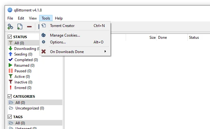

  10. Hello all, I don't see the "torrent creator". Is it normal? An option not configured in my side?
