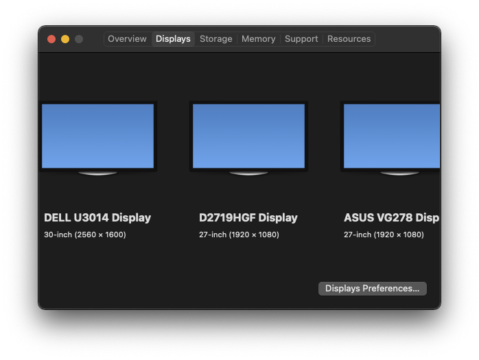

  6. Not sure why, I have 1x HDMI and 2x DP monitors working without WEG perfectly fine. The last time I needed WEG was back in the R9 290X days, went to a Sapphire Nitro+ OC RX 480, Sapphire Nitro+ Vega 64, Sapphire Radeon VII and now Sapphire Nitro+ RX 6900 XT all without needing WEG using HDMI and multiple DP ports.
  7. Yeah macOS doesn't like passive adapters. You would need an active DP to VGA adapter.
  8. @ghost82 agdpmod=pikera is only needed if you use WhateverGreen, which the RX 6xxx XT series does not need. All display ports work without WEG.
