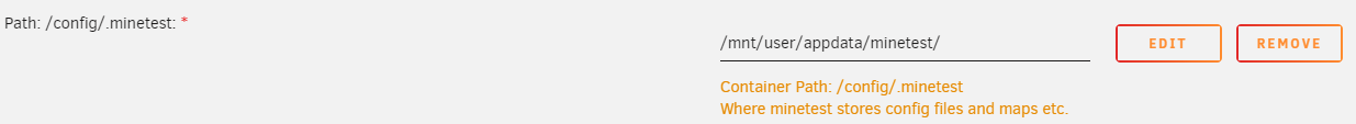

  1. The current version doesn't have an AppData path. You could setup your own share to manage the minetest config files. Below is my setup.
  2. You download modes from: Mods - ContentDB (minetest.net) Place them in the /mods/ folder Restart the server Edit the 'world.mt' file (/worlds/world), by changing the value to 'true'
