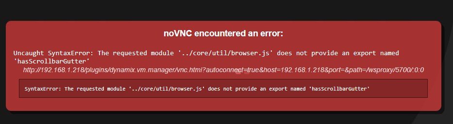

  1. Hello, Je n'arrive plus a accéder sur mes VMs via noVNC, j'ai un message d'erreur quelque soit la VM... SyntaxError: The requested module '../core/util/browser.js' does not provide an export named 'hasScrollbarGutter' Que dois je faire ? Merci.

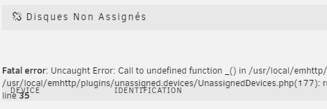

  2. Hello I have had an unusual display on my server for several days and rebooting does not solve the problem. What should I do ? Thank you. Fatal error: Uncaught Error: Call to undefined function _() in /usr/local/emhttp/plugins/dynamix/include/Helpers.php:35 Stack trace: #0 /usr/local/emhttp/plugins/unassigned.devices/UnassignedDevices.php(85): my_scale(870.35904, NULL) #1 /usr/local/emhttp/plugins/unassigned.devices/UnassignedDevices.php(177): render_used_and_free_disk(Array, true) #2 /usr/local/emhttp/plugins/unassigned.devices/UnassignedDevices.php(262): render_partition(Array, Array, true) #3 {main} thrown in /usr/local/emhttp/plugins/dynamix/include/Helpers.php on line 35 DEVICEIDENTIFICATION
