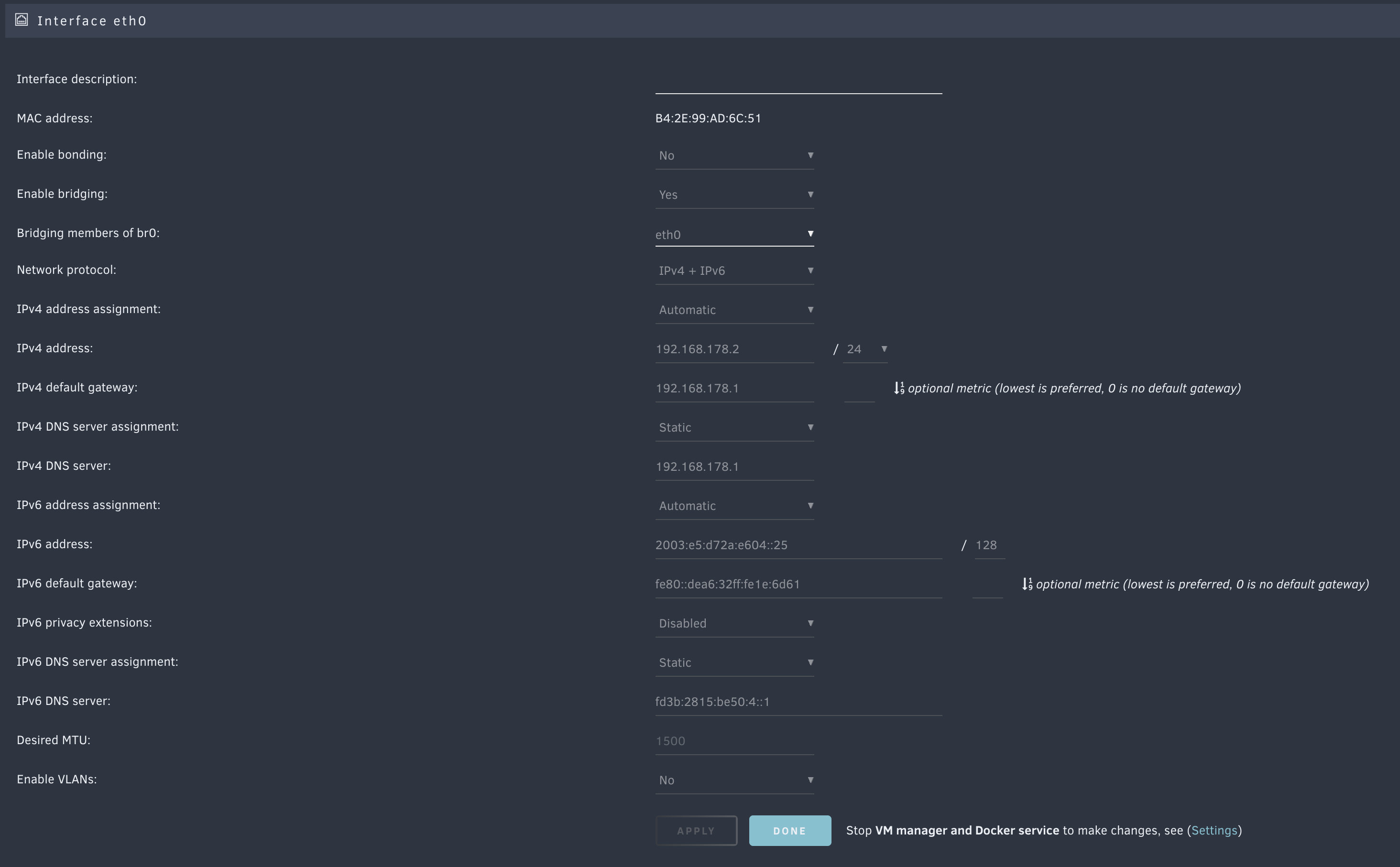

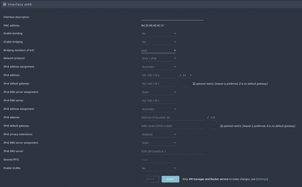

  3. So, preface: I know what I'm doing here is unsupported, but I now know what is happening and want to document it in case somebody else runs into this. As I mentioned in my edit, this was 100% related to the ip6tables option of Docker. At first I didn't assume this would actually have any influence on VMs running through the br0 bridge, since usually that traffic shouldn't be affected by iptables at all, but, and I didn't realize this beforehand, Docker loads the br_netfilter kernel module that is actually causing traffic on bridge interfaces to be handled by iptables too (see link at the end of this post for technical details). The actual problem: After Docker started with the ip6tables option enabled, it set the default FORWARD policy for IPv6 to DROP. That policy caused all IPv6 traffic to not be passed from the VM to my local network and vice versa. This is explicitly done by Docker itself (see here for the relevant code in the patch that introduced ip6tables to Docker). I noticed that the default FORWARD policy for IPv4 was ACCEPT, this is why this didn't cause any issues for IPv4 traffic to the VMs. The workaround in my case was to simply add a new rule on ip6tables and everything seems to work fine: ip6tables -A FORWARD -i br0 -o br0 -j ACCEPT Now, what I don't understand is why the default FORWARD policy on IPv4 is ACCEPT. Based on Dockers code it should be set to DROP too… I checked the init scripts of Docker and libvirt in Unraid and couldn't find anything… in case anyone from Limetech reads this, I'd love to know if you did anything to make this work for IPv4. A lot more context on Docker, libvirt, bridge interfaces and br_netfilter can be found here: https://serverfault.com/a/964491
  4. So, I think this may be related to me enabling ip6tables in Docker using this Docker daemon.json: { "experimental": true, "ip6tables": true } Today IPv6 stopped working for VMs again. After disabling my custom daemon.json and rebooting the Unraid server (which didn't help the last time I worked on this) fixed IPv6 in VMs again. Kind of annoying, since I utilize this to have correct IPv6 port forwarding for my PiHole, but at least I now have something concrete to test. Edit: This is definitely the case. To test this I stopped Docker with /etc/rc.d/rc.docker stop, put the above daemon.json at /etc/docker/daemon.json, startet Docker with /etc/rc.d/rc.docker start and rebooted my VM. After the reboot, the VM couldn't get an IPv6 via SLAAC again.
  5. Sadly I again have trouble with this… now none of my Linux VMs get an IPv6 address at all. I recently switched all VMs that were using DHCPv6 to SLAAC and while everything worked fine for a while, I realized there is no IPv6 connectivity at all now. I can see the router solicitation request from the VM with tcpdump: tcpdump -i vnet1 icmp6 tcpdump: verbose output suppressed, use -v or -vv for full protocol decode listening on vnet1, link-type EN10MB (Ethernet), capture size 262144 bytes 21:05:33.962275 IP6 :: > ff02::1:fff9:6584: ICMP6, neighbor solicitation, who has fe80::5054:ff:fef9:6584, length 32 21:05:34.986326 IP6 fe80::5054:ff:fef9:6584 > ip6-allrouters.lan.gru.earth: ICMP6, router solicitation, length 16 21:05:38.954235 IP6 fe80::5054:ff:fef9:6584 > ip6-allrouters.lan.gru.earth: ICMP6, router solicitation, length 16 21:05:47.146270 IP6 fe80::5054:ff:fef9:6584 > ip6-allrouters.lan.gru.earth: ICMP6, router solicitation, length 16 21:06:04.554282 IP6 fe80::5054:ff:fef9:6584 > ip6-allrouters.lan.gru.earth: ICMP6, router solicitation, length 16 This is also visible on br0. None of those packets are visible when running tcpdump on eth0 or on the router. I don't know how to investigate this further… rebooting the server didn't help this time. All my other devices using SLAAC are getting an IPv6 just fine, this is only happening with VMs on Unraid. Edit: Since I was at a total loss I decided to upgrade to Unraid 6.9.10-rc2 and now the VMs get an IPv6 via SLAAC again. No idea if this was just the reboot or the newer kernel/libvirt fixed anything. Ugh. I'll have to keep an eye on this.
  6. I rebooted the Unraid server and now it is working 🤔 Not sure what happened there.
  7. It's a standard Debian 11 VM (tried Ubuntu 20.04 too). As far as I can see the ICMP6 packets appear on the br0 interfaces on the Unraid server but don't reach my router, so I assume some multicast packets don't get forwarded for some reason. Any tips on how to further debug this would be appreciated.
  8. I'm trying to get a VM running in my local network with IPv4 and IPv6. The VM is getting an IPv4 from my router, but it seems that neither SLAAC nor DHCPv6 are able to get an IPv6. My network config is fairly simple and VMs in VMware Fusion on my Macbook have no trouble getting both an IPv4 and IPv6 from my router via a bridge network. Is this to be expected with Unraid? Do I need to change some settings for this to work? Unraid itself and Docker containers have working IPv6. The VM is in network br0 and both virtio and virtio-net did have this problem.
