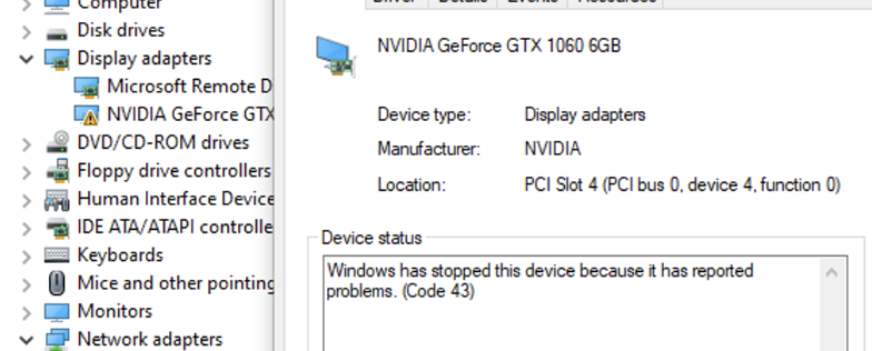

  2. I will remove that entry, next time I take the array down and start it shall test. Thanks!! Sorry, I should have added to things I tried: -Uninstalling and reinstalling all NVIDIA drivers -Tried a clean install of windows server 2022, same error in windows -No errors when booting from an image of the VM on bare metal (restored to a different PC), GPU works fine -Different PCI-e card works in the slot the GPU is in now -PSU confirmed to be delivering power
  3. Hey all. Hopefully someone can help as this leaves me sorta dead in the water. After updating to 6.12.3, I can no longer passthrough my GPU to my Win 10 VM and autostarting any VMs gives me an error. Unfortunately, I didn't notice these issues/pay much attention to them until after I started a lengthy disk swap, that invloves (one at a time) replacing 4 disks. So I am unable to roll back to 6.10.x Attached are the diasgnositics. Two issues are: -Windows 10 no longer recognizes my GPU (GTX1060) - it shows it in an error state in windows device manager (sn attached) -Everytime I stop and start the array, none of my VMs autostarts and I get a virtio error Niether of these were issues in 6.10.x, everyone worked fine one minute, then immeadiately after the update these issues started. Things I've tried: -deleting the VM and remaking it -using VNC as the primary display and making the GPU secondary -trying to pass the GPU to my other windows server VM -GPU tested in seperate PC and works fine -Uninstalling and reinstalling all NVIDIA drivers -Tried a clean install of windows server 2022, same error in windows -No errors when booting from an image of the VM on bare metal (restored to a different PC), GPU works fine -Different PCI-e card works in the slot the GPU is in now -PSU confirmed to be delivering power Any help would be much appreciated! Thanks!! tower-diagnostics-20230812-1154.zip
