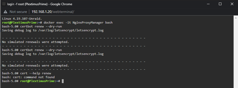

  6. Sorry I was trying to get this done before heading out of town for Christmas just got back into town and tried this but this is what I am getting after running the manual route. If I try to curl the page it executes in bash but nothing happens it just loads the next line if I "nc IP" it goes to the next line and asks leaves it open to type another command. Any help would be greatly appreciated, I'm pretty sure its something small and dumb that I am overlooking. Thanks.
