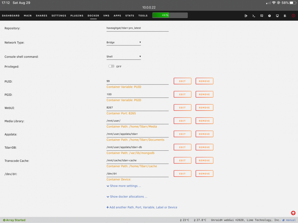

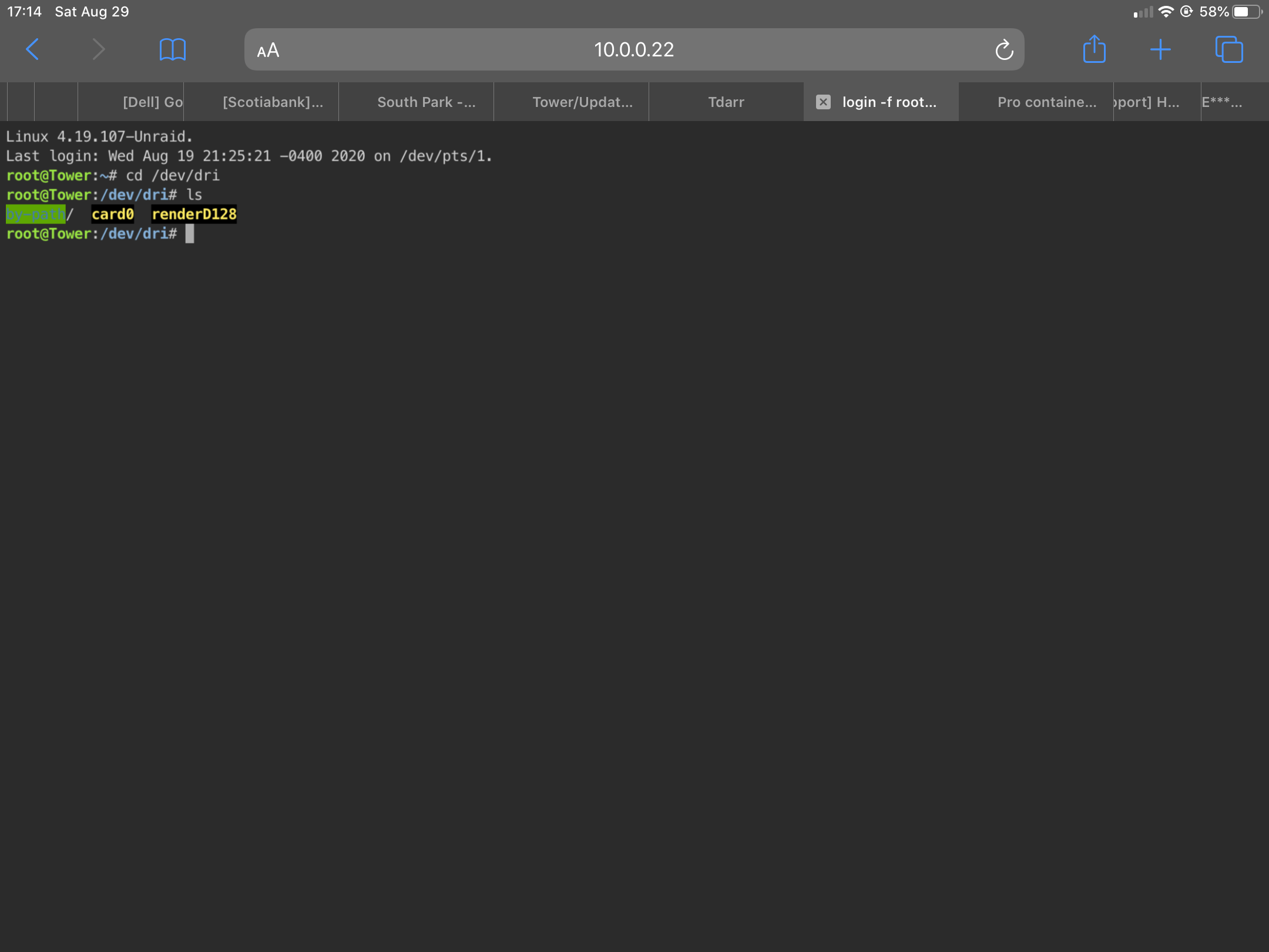

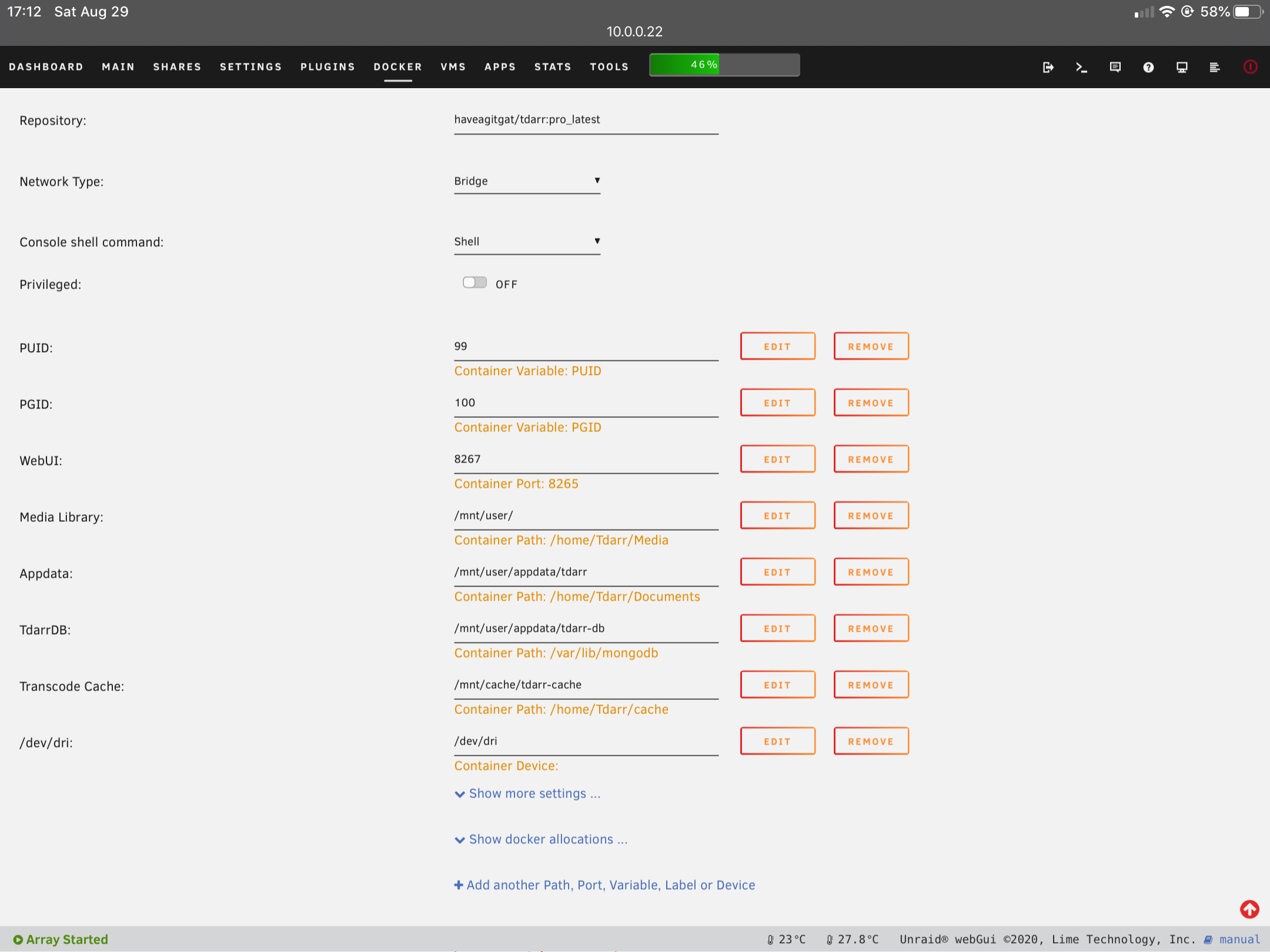

  6. mellerd joined the community
  7. My Tdarr was working fine for few months using QSV and QSV Handbrake profile. Decided to support development, pledged and installed “Pro” version (haveagitgat/tdarr:pro_latest). Tdarr immediately stoped encoding and now giving errors. I think the issue is with QSV support. Rolled back to older “non pro” version and everything is working fine without any changes. Will be grateful for any ideas. Command: HandBrakeCLI -i '/home/Tdarr/Media/Downloads/usenet/completed/series/South.Park.S11E01.720p.BluRay.X264-REWARD/11a6b4d251d34c599e51693b52976d78.mkv' -o '/home/Tdarr/cache/11a6b4d251d34c599e51693b52976d78-TdarrCacheFile-e8Y0fWCFm.mkv' --preset-import-file "/home/Tdarr/Documents/presets.json" -Z "myH265" Last 200 lines of CLI log: shellThread Cannot load libnvidia-encode.so.1 [16:53:03] hb_init: starting libhb thread [16:53:03] thread 152fa2276700 started ("libhb") HandBrake 1.3.1 (2020080200) - Linux x86_64 - https://handbrake.fr 6 CPUs detected Opening /home/Tdarr/Media/Downloads/usenet/completed/series/South.Park.S11E01.720p.BluRay.X264-REWARD/11a6b4d251d34c599e51693b52976d78.mkv... [16:53:03] CPU: Intel(R) Core(TM) i5-8400 CPU @ 2.80GHz [16:53:03] - Intel microarchitecture Kaby Lake [16:53:03] - logical processor count: 6 [16:53:03] Intel Quick Sync Video support: no [16:53:03] hb_scan: path=/home/Tdarr/Media/Downloads/usenet/completed/series/South.Park.S11E01.720p.BluRay.X264-REWARD/11a6b4d251d34c599e51693b52976d78.mkv, title_index=1 ... ... ... [16:53:04] + bitrate: 640 kbps, samplerate: 48000 Hz [16:53:04] + AC3 Passthru [16:53:04] sync: expecting 32224 video frames ERROR: encx265: x265_param_default_preset failed. Preset (balanced) Tune ((null)) ERROR: Failure to initialise thread 'H.265/HEVC encoder (libx265)' [16:53:04] comb detect: heavy 0 | light 0 | uncombed 0 | total 0 [16:53:04] decomb: deinterlaced 0 | blended 0 | unfiltered 0 | total 0 [16:53:04] ac3-decoder done: 0 frames, 0 decoder errors [16:53:04] h264-decoder done: 0 frames, 0 decoder errors [16:53:04] sync: got 0 frames, 32224 expected [16:53:04] Finished work at: Sat Aug 29 16:53:04 2020 [16:53:04] libhb: work result = 3 Encode failed (error 3). HandBrake has exited.
