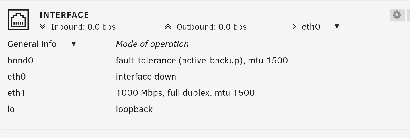

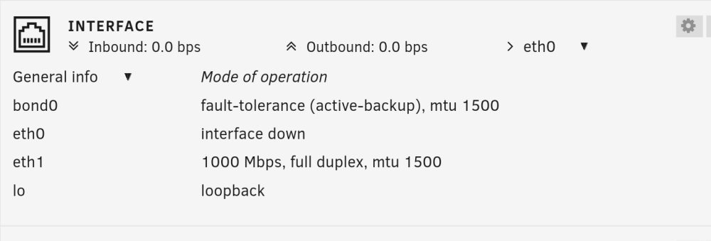

On the dashboard it is showing this:
bond0 fault-tolerance (active-backup), mtu 1500
eth0 interface down
eth1 1000 Mbps, full duplex, mtu 1500
lo loopback
All this time the cable was plugged in the 2.5 gbe port. When plugged in 1 Gbe port it works too.

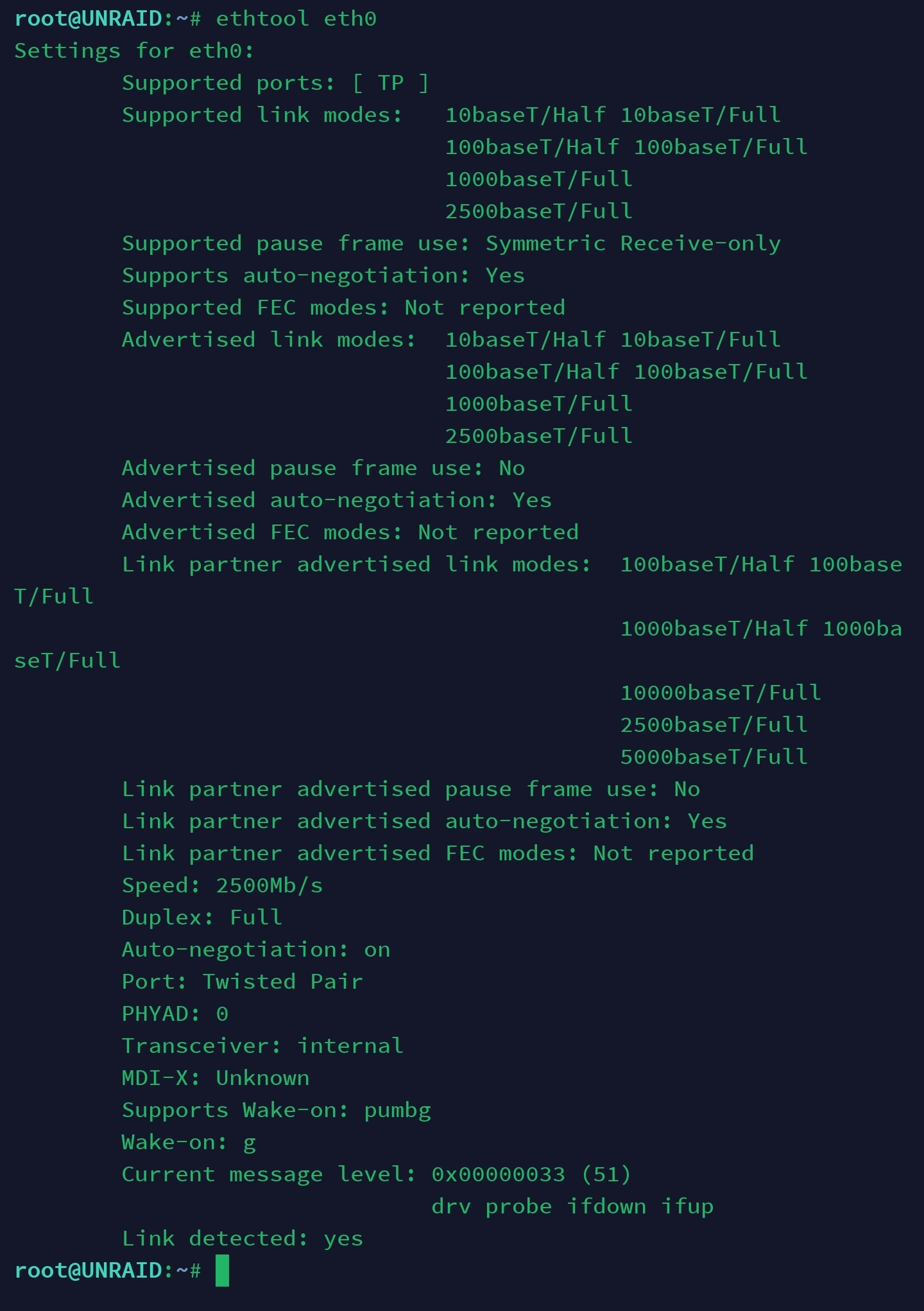

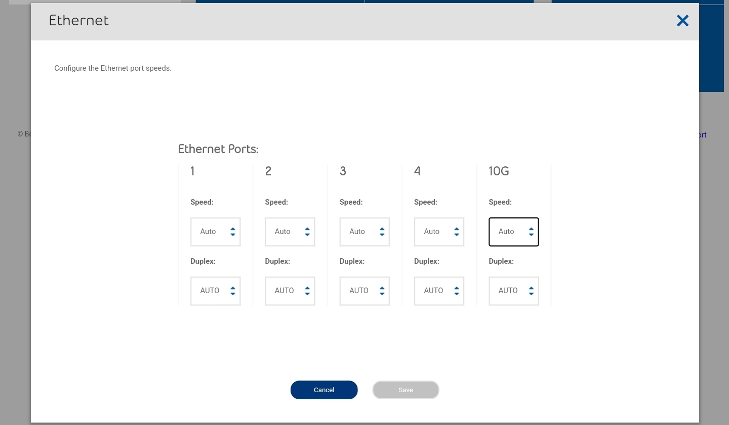

Thank you for prompt response!
So for eth0 it shows 2500 supported, and for eth1 - no.
Please see attached pictures.
Thank you
Edited by sdmellerd
but your eth0 has no link (cable missing?)

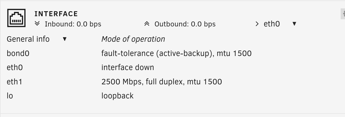

Hmmm. New development:
I was disconnecting and reconnecting the cable from one port to another for a few times while rebooting the server and suddenly its started showing 2500 on the dashboard (previously it was showing 1000 only).
I ran speed test and it's surpassing 1000 now. So all good speedwise.
But it still not creating network-rules.cfg file upon reboot. Therefore I won't be able to route connections in the future if desired.
I guess, that anyways I should be happy that I gained full speed back after all.

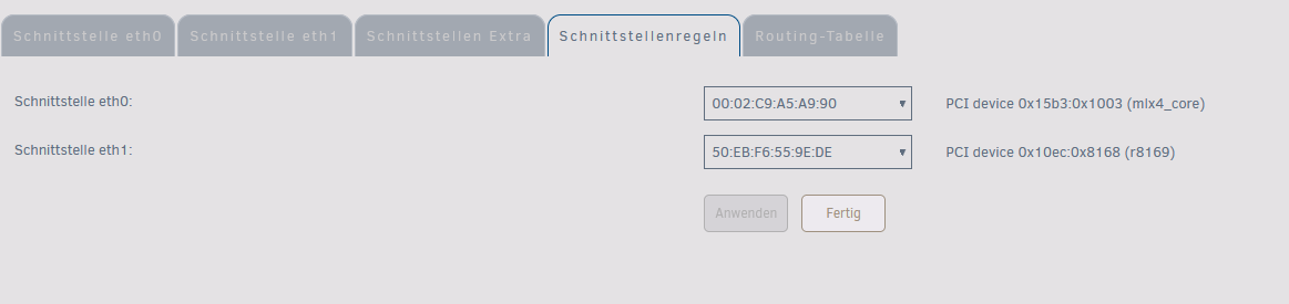

I'm not sure if it is autocreated at all. It just kicks in if you manually assign cards on the network tab. But without it, every boot is a risk because cards maybe sorted differntly after a bios update or so. So it is better to pin them down.
There should be something like this in the gui:
Also, you have configured bonding on both cards, but you will never use both at the same time. I would recommend to assign 2.5 card as eth0 and disable bonding on both cards.
You may even deactivate the 1G card totally (either in Bios or here)
Since it's not creating network-rules.cfg for some reason, I cannot pin the cards down (this menu is absent).

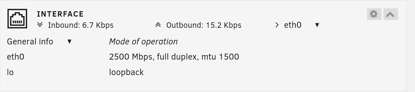

In the end I just disabled the on-board 1gbe card in the BIOS...
It's a bit sloppy resolution and I would prefer to be able to pin them in unraid, but at least it won't switch randomly to the  slower card in the future again.
