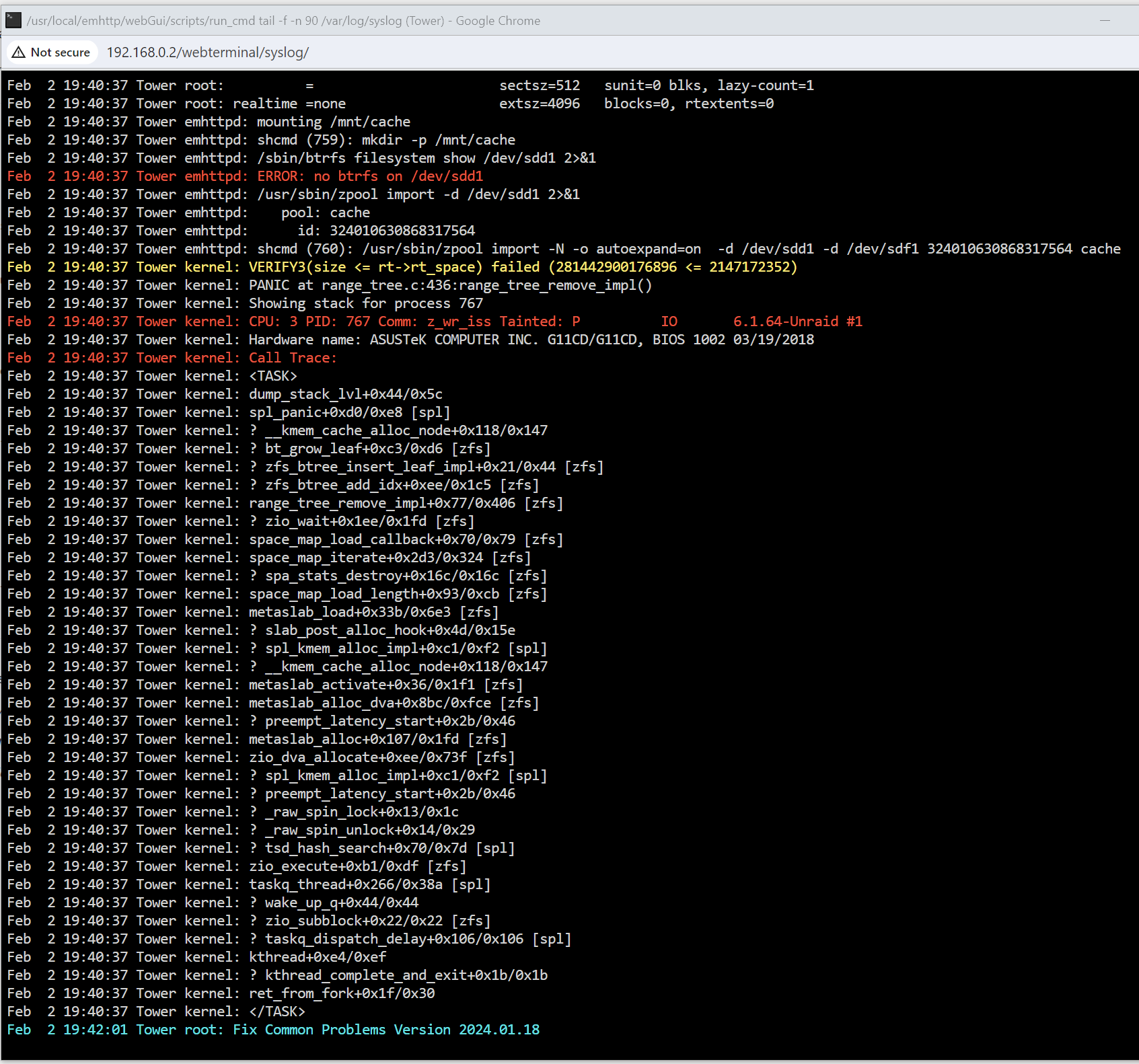

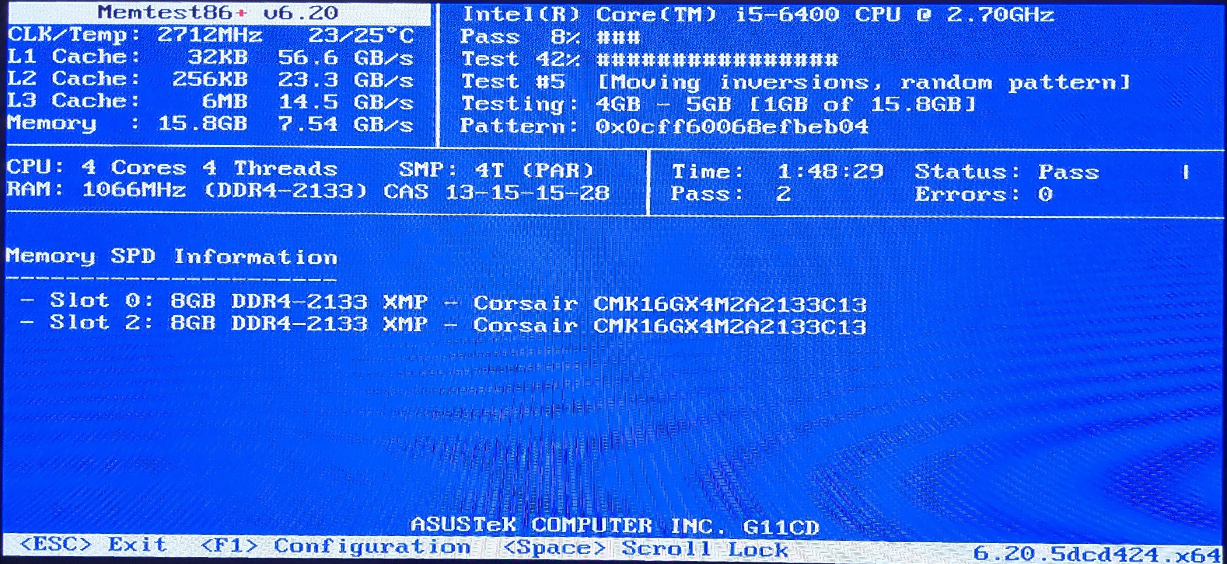

copy AppData folder to main array for backup. disable docker reboot with array not started, remove disk 1 and 2 from cache pool, set cache pool # drives to (0). Start array, no cache pool. Shutdown, reboot and run memtest86+, it passes (2) runs: Start unraid, start array, everything is happy. Stop array, add pool, add both drives to pool. Start array...... and we get a Kernel panic / crash in the event log I can't run/download a Diagnostics bundle as it freezes on this line and wont complete: "/usr/sbin/zpool status 2>/dev/null|todos >>'/tower-diagnostics-20240202-1946/system/zfs-info.txt'"

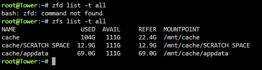

"Docker Service failed to start." Disabled docker, deleted vdisk, start docker.... wont start. Disable docker, reboot, delete vdisk, start docker.... wont start. The system just keeps saying "Array Started..... Starting services" in the corner, and when I click on the docker tab "Docker Service failed to start."

It's a temp folder for several of my docker containers (tdarr, sonarr, etc.). I recreated the share before trying to restart docker, so the apps wouldnt fail.

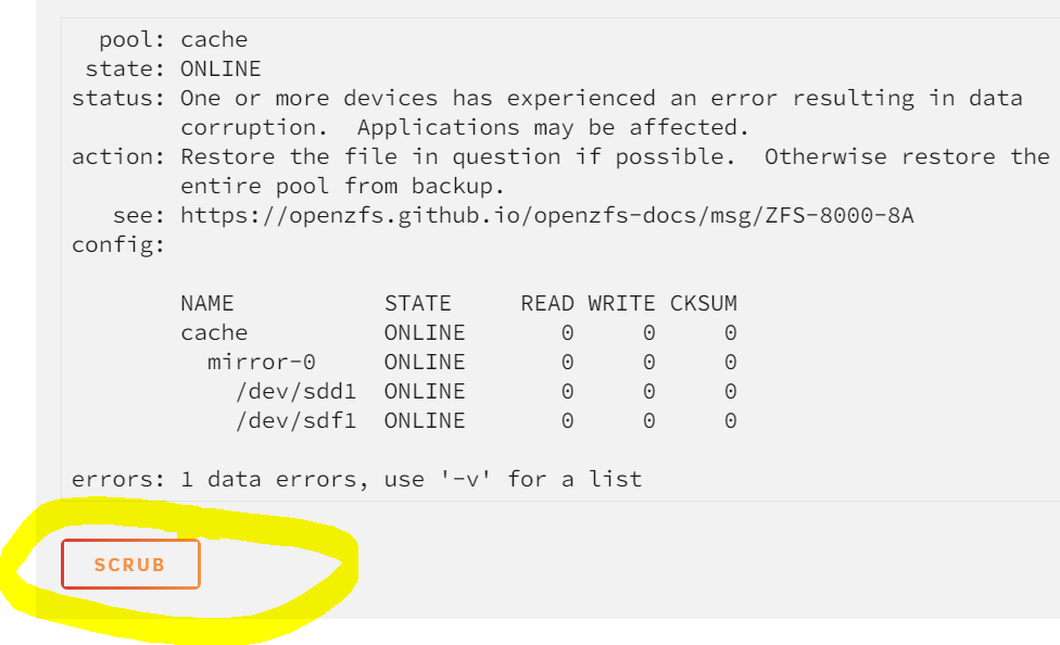

when I said "3 hours", I was only referring to the system not giving me feedback on success or failure from the scrub command, and wasn't sure how long a scrub could take. Here is the output:- 6.12.6 - ZFS cache pool error "status: One or more devices has experienced an error resulting in data corruption
clicking the scrub button has not changed anything in (3) hours now. Not sure what to do.- 6.12.6 - ZFS cache pool error "status: One or more devices has experienced an error resulting in data corruption
I don't know anything about snapshots. I don't know how to check metadata corruption. and I assume I just click this scrub button here? - 6.12.6 - ZFS cache pool error "status: One or more devices has experienced an error resulting in data corruption
