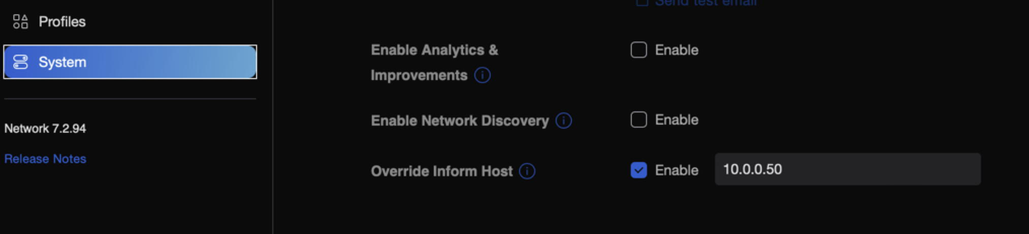

  7. Not sure this will help, but you can give it a try: ensure your controller computer has a DNS resolvable hostname on your network(s) (you can ping it by name from your Unifi devices) then go into Settings on you controller, go to the controller section and ensure that your host name or IP address for your controller are entered intot he Controller Hostname/IP field, then check the Override inform host with Controller Hostname/IP like so: (use your own IP Adrress)

  10. Hi, Been there, done that 🙂 Two possible solutions that worked for me: - reset switch - ensure your controller computer has a DNS resolvable hostname on your network(s) (you can ping it by name from your Unifi devices) then go into Settings on you controller, go to the controller section and ensure that your host name or IP address for your controller are entered intot he Controller Hostname/IP field, then check the Override inform host with Controller Hostname/IP like so:
